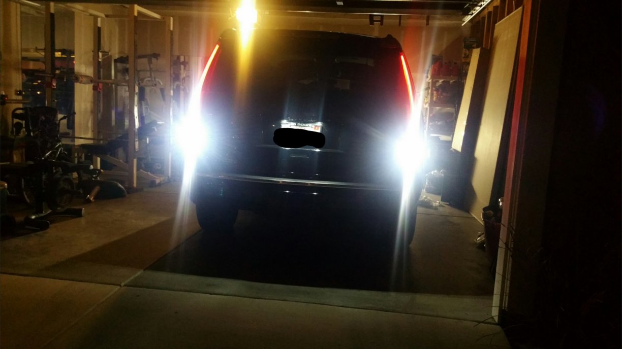

These come with 5k reverse lights. Clear turning signal (when turning they turn amber). Today if I have some time I will post a video of my set up. And it work with my remote start like if it was factory.

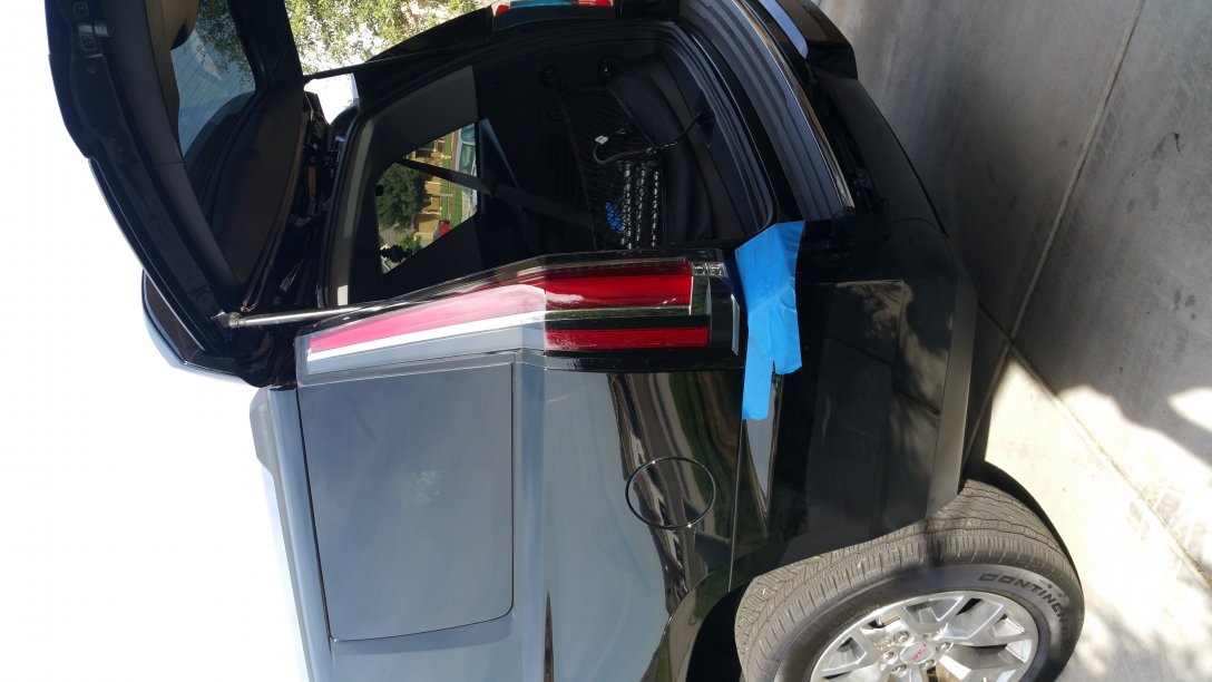

start by removing 4 plastic pieces they are held by clips (remove gently) the top plastic is held by 1 screw
Begin removing the top piece held by 3 screws and clips on the side. The light is held by only 2 screws and 3 clips also (be gentle with the clips)
After everything is removed then just repeat the steps just take your time and everything will be ok. Quick tip if you get the lights I bought you will need to remove the factory harness.
The lights come with a harness and plugs right in. The plug you will be plugging into is at the bottom of the rear bumper.
