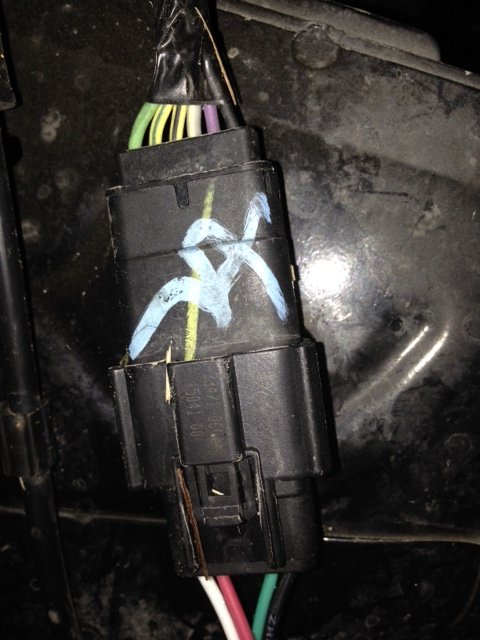

Factory plug is on the top. After market is on the bottom
My wires on the factory side look the same, but the aftermarket light plug is different.
Would anyone know if this would be the problem with the tail lights not working correctly?
