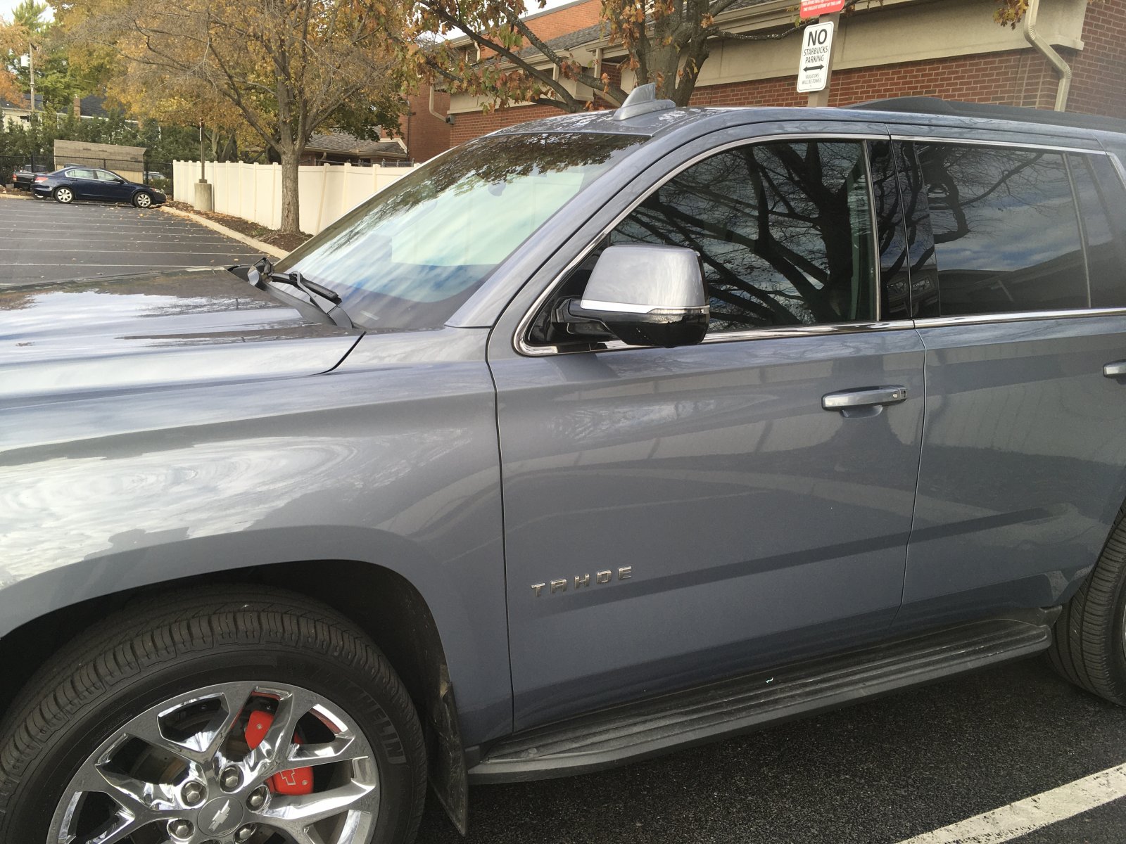

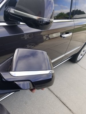

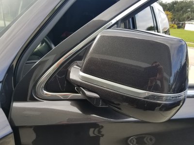

No , not Escalade mirrors . They are definitely bigger than oem Tahoe/suburban mirrors , but they are an aftermarket design. Cost about 75% less than Escalade mirrors also
They resemble the size mirrors that are on the trucks. I’d say they sit between the OE suv mirrors and the Escalade type from a size perspective.

They are actually about the same size as the Escalade mirrors, just that the Escalade mirrors are a bit more boxy. Escalade mirrors closer to a square where these drift to more of a lengthier rectangular shape.

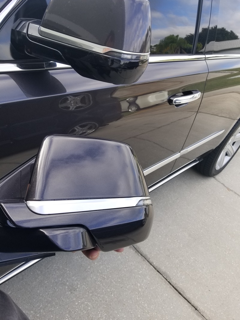

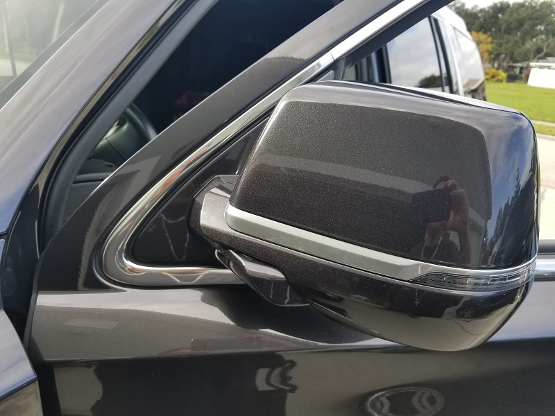

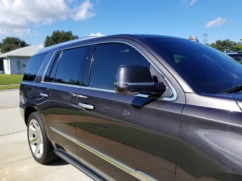

Here is the factory Esky mirror on my Tahoe.

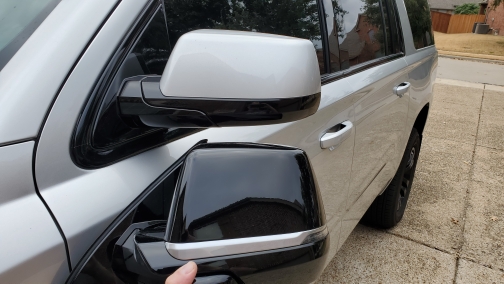

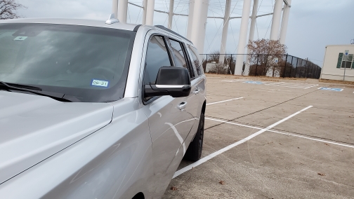

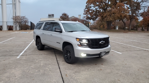

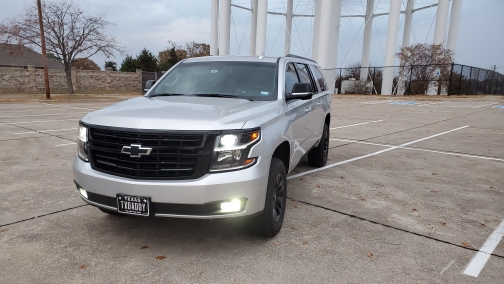

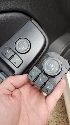

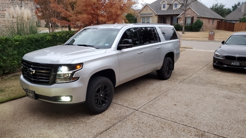

And done. Took about 2 hours - 1 1/2 doing one, and half hour on second (did passenger 1st) as always. Actually not very hard as projects go (easier than heated wheel), but I did do a lot of door panel removal on the gmt 900s (this is similar). No clips broken. The difference in visibility is incredible - way more than I expected; you dont need tilt to see your back up along the lawn. The power fold and memory function work since I replaced both switches, but turn signal was not hot. Now I pretty much have every feature I want (mirrors, fogs, heated wheel, rst grill) without the ones I dont (push button start, magnetic ride, sound dead, over chrome). Cost was 262 for mirrors plus about 75 for switches (I had some Amazon credit so I got them there, but they are cheaper elsewhere). Worth it IMO...

Not bad. I paid $220 shipped for mine but need caps. I went that way because those were the only ones I found without the blind spot indicator. Why is the turn signal not working?

Needs to be wired. I have a base LT without signals. Not really something I care about, and I will probably do a black vinyl wrap on them...

I agree. If my new mirrors had puddle lamps, I would get the harness, but they dont. The switches give you memory and fold capability which is what I really wanted, plus the size which may be worth it alone. I didnt have to cycle it 3 times either - they folded on first try after I installed the switches...

Nice! They look great. I like how the black caps blend with the side windows/trim.
BTW my harness will also enable the auto dim feature on the driver mirror in addition to turn signals, etc.
