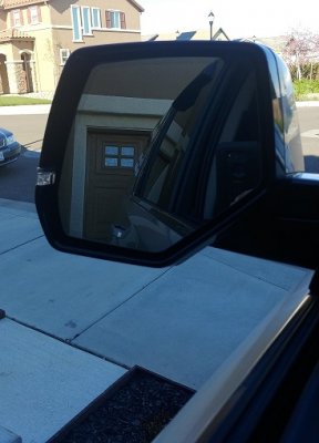

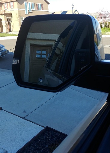

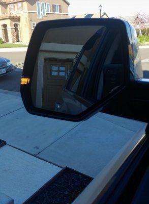

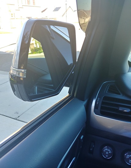

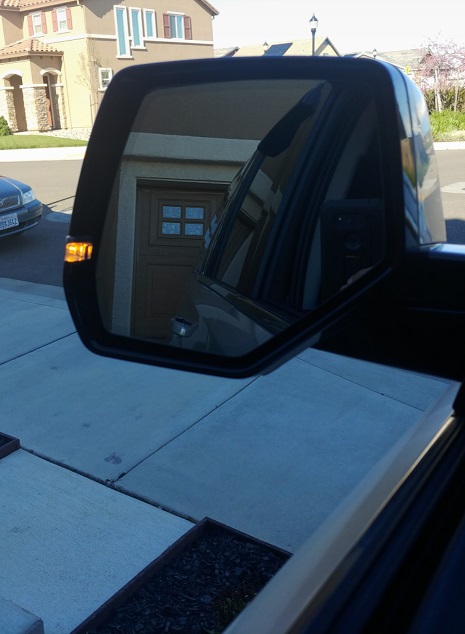

Thanks so much to cmatt for helping me with my mirror harnesses and switches. I finally got my turn signals, folding, and puddle lamp working on my new Esky mirrors and I LOVE it!
Also, because it took me a moment to realize, be sure that you don't have the dome override turned on because if so, the puddle lamps won't work. :p

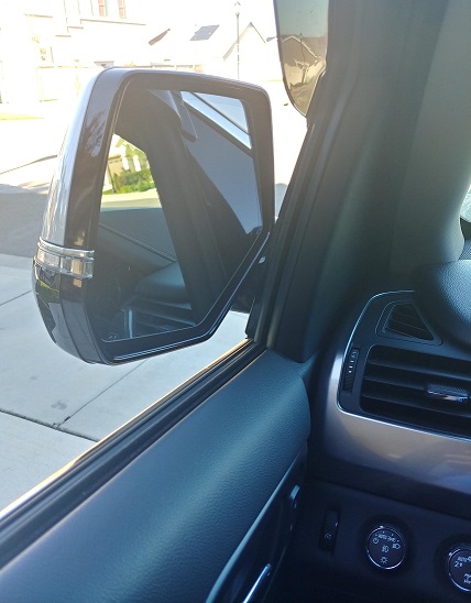

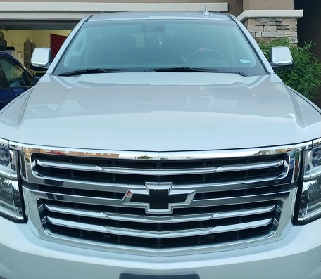

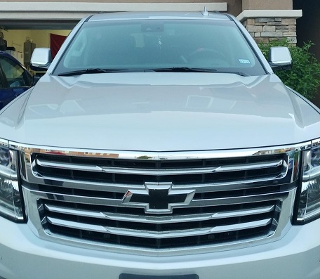

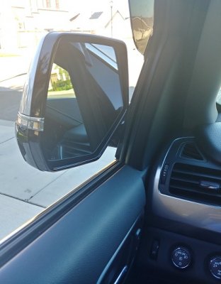

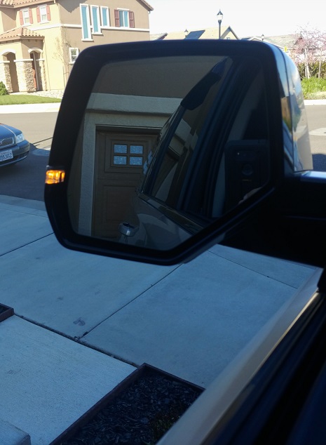

Here's a few pics...
