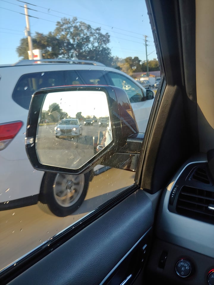

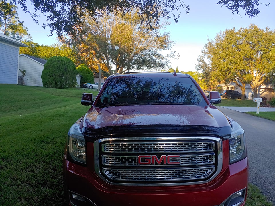

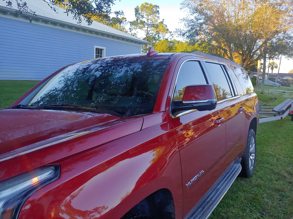

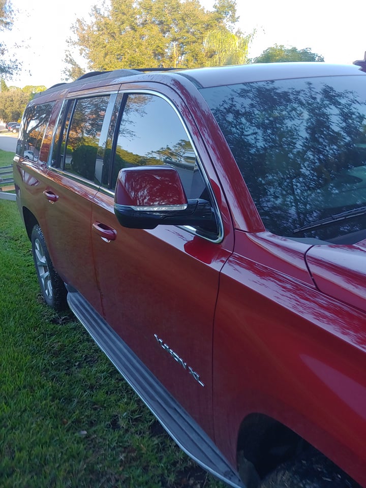

I'm about to do this mod as well. I just ordered a set off ebay that are Passion Red from a 2018 Escalade. I hope they match my Crystal Red Tintcoat! I'll post pictures when I do the swap next week. I tow a boat and a utility trailer every week and these tiny mirrors are a joke!

Got them installed last night. The color is a damn near perfect match. Everything works except the blind spot, I don't think these mirrors have that feature even though the listing said it did. I can live without that thought. They look great and are way bigger than stock.
