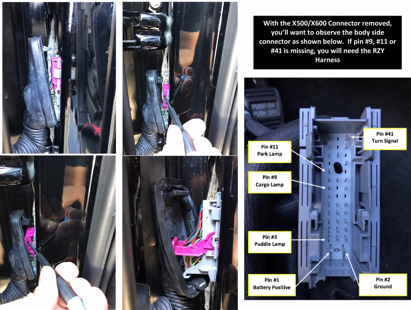

please pardon me for bringing this thread back from the dead. I just purchased a 2018 Tahoe and like countless others I am very unhappy with the size of the mirrors.
I have read this thread numerous times and cant find the answer to my question , maybe I missed it.
if I have a Tahoe now that does not have any options on my existing small mirrors like puddle lights , power folding, heated, blind spot warning etc will connecting the escalade mirrors with an escalade door wiring harness and a new switch control panel give me any of these options.
thank you

Most likely, no. Many times those circuits are missing from the body side of the door connector. I can make a harness that will add those options. You may not need to replace the door harnesses. I need to see pics of the ends of your door connectors to verify which terminals are present.
Here’s how to get at them (ignore the writing). PM me with the info.

Most likely, no. Many times those circuits are missing from the body side of the door connector. I can makes a harness that will add those options. You may not need to replace the door harnesses. I need to see pics of the ends of your door connectors to verify which terminals are present.
Sent from my iPad using Tapatalk
Thank you
I will be tackling this in a week or so so i will get back to you.
