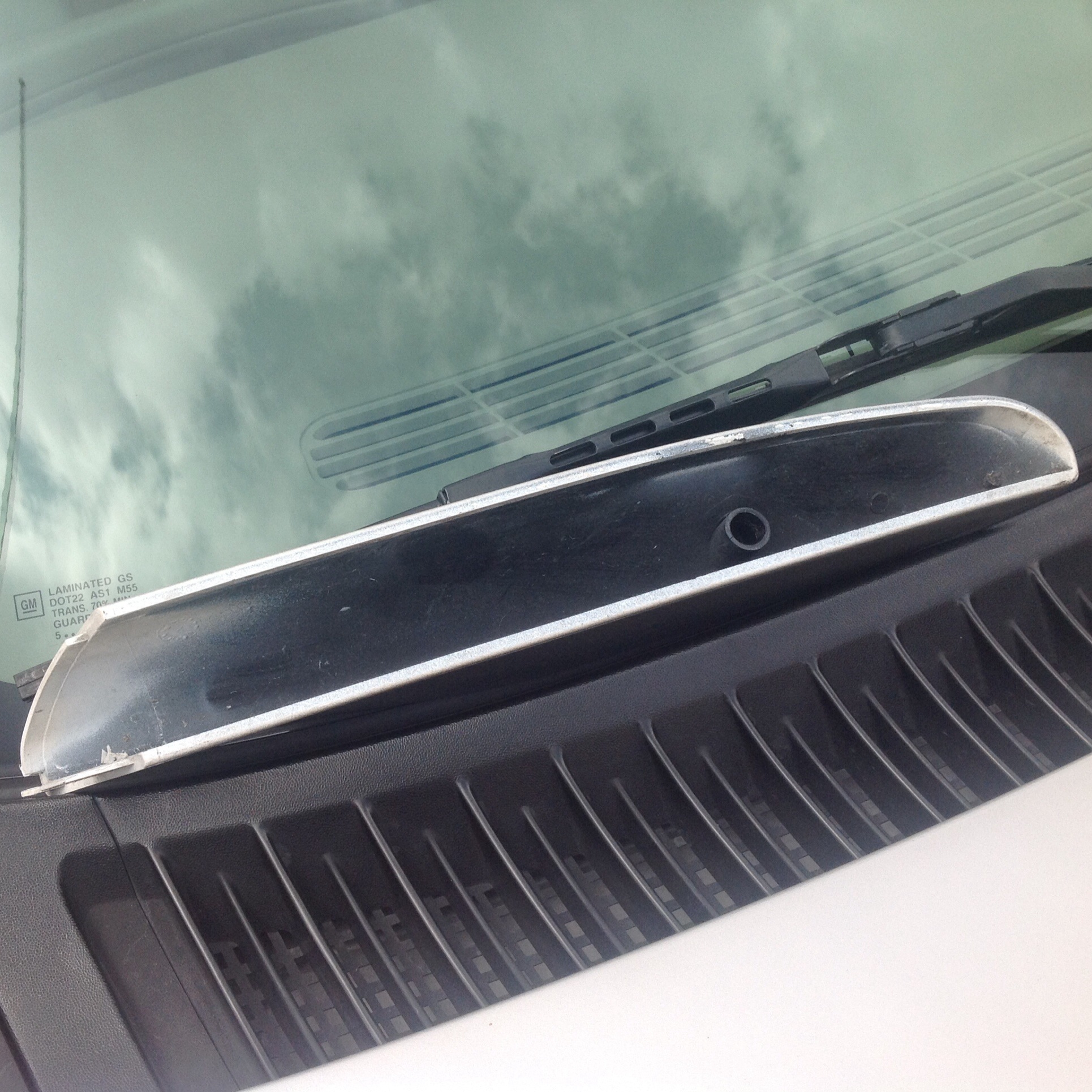

This is what my gasket looks like and the underside of the cap.

Here's the underside of the cap. This new website is quite irritating. Pics are not working like they are supposed to.
Thanks for taking the time to do that. Above and beyond. The peg on my front passenger side is missing about 3/8". Not getting much purchase with cap. I'll run them naked for now. I'd rather wait and get a new insert piece than loose a fresh painted cap on the road

Looking for a little clip that goes inside the end caps for the escalade rack. I was told this rack came from a 2010 escalade, however I'm open to the reality that may be incorrect. Picture attached. All help appreciated.
Anyone found a way to get just this metal clip without having to purchase a new end cap?

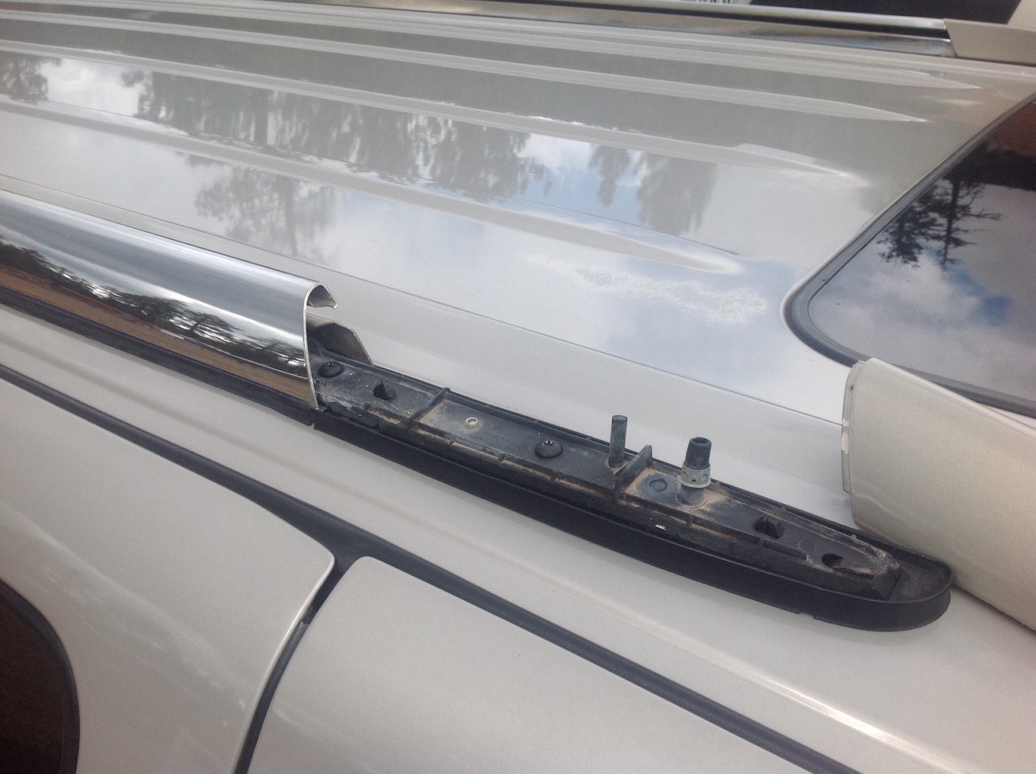

there are 5 bolts per side. 2 on the front end, 2 on the rear and one in the middle. They are a T25 torx Bit. Once unbolted, the whole Rail is Ready to come off. Save all the bolts, your going to reuse them. Repeat for other side.

The endcaps on the esky racks are held in by a clip. Pry up on them and set them aside.
picture.php
There is a anchor nut that you need to install. I had ordered them from Gmpartsdirect.com and they got me in shipping. Here is the part number so maybe you can get them from the dealer cheaper. I paid like 30 bucks for 2 and shipping.
picture.php
Take one of the Bolts you removed from the original Racks and put in through the nut and install on to the middle Hole.
Take the rack and install it over the anchor nut and slide it back to lock the center into place and match the Mounting holes. Install the 2 bolts for the front and rear. Repeat for the other side

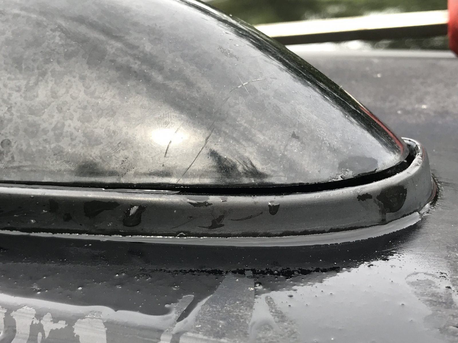

Is there a trick to get the nose of the front end caps to sit down flush onto the gasket?
