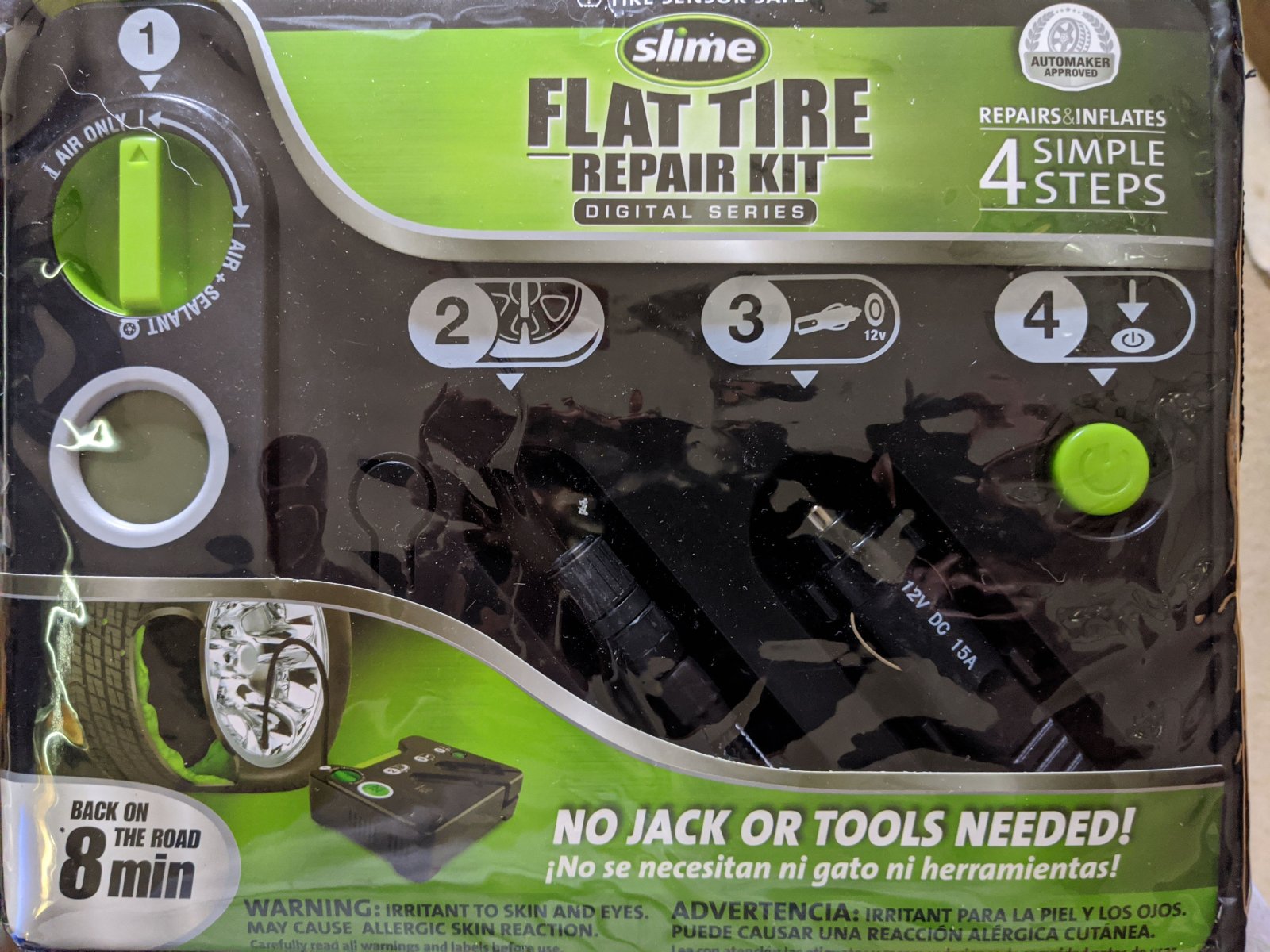

Yes one of the shops I contacted mentioned how easy this install would be if the spare was removed. If I removed the spare, I'd never get my wife to ride with me again ! After 275,000 miles, I've never had the spare on.
"If I removed the spare, I'd never get my wife to ride with me again !" Is that a problem, or a feature? ;)
My spare tire in my 1997 Yukon (RIP) was rust welded to the frame of the truck for the entire time that I owned it.
For my current Yukon XL, this has been my spare tire, since I installed the Gibson exhaust system.
….fix a flat…
Quickest way to make enemies @ the tire dealerships ;).

Good answer !!
