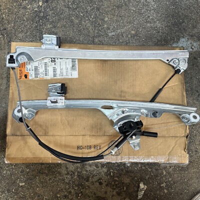

So far my choices of new parts without motor is this bundle from TRQ for around $100:
OR
I'm ok with purchased GM OEM new without motors and swapping on my current motor onto them; I'm just not sure exactly the correct part numbers. I think the part numbers are:
Front Drivers Side GM 20914715
Front Passenger Side GM 20914716
GM OEM New window regulators WITHOUT MOTORS are about $118/ea without motors.
But some sites state they're power window regulators without motors and some sites state that they're simply manual window regulators? Not sure if OEM manual window regulators are designed to accept a electric power window motor?
Maybe I'm over thinking it?
@915_Tahoe
@91RS
Any help on confirmation of the part numbers would be appreciated.
EDIT: the TRQ regulators linked above are WITHOUT motors.

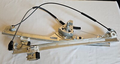

I can’t quite tell if those regulators will work based on the pictures I’m finding or not. Rock Auto shows they fit all GMT-900 so maybe the part where the crank handle would attach just unscrews and the motor can be screwed in place. Maybe try buying one from Amazon so returns are easy?

I Googled those part numbers and found some pictures, but I can’t quite tell how the manual mechanism is attached to it. I do know for sure the express up motor will work in place of the standard motor because one of my used regulators was damaged and I reused my original one when I did this conversion.

I found a couple listings on ebay for the GM OEM regulator without motor that have a few better pictures. But it's still hard to tell if that manual piece is removable or not.
