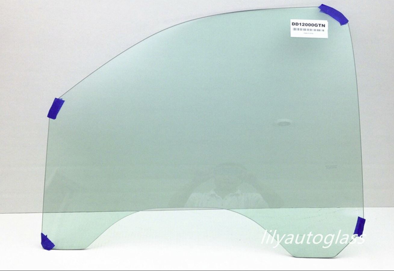

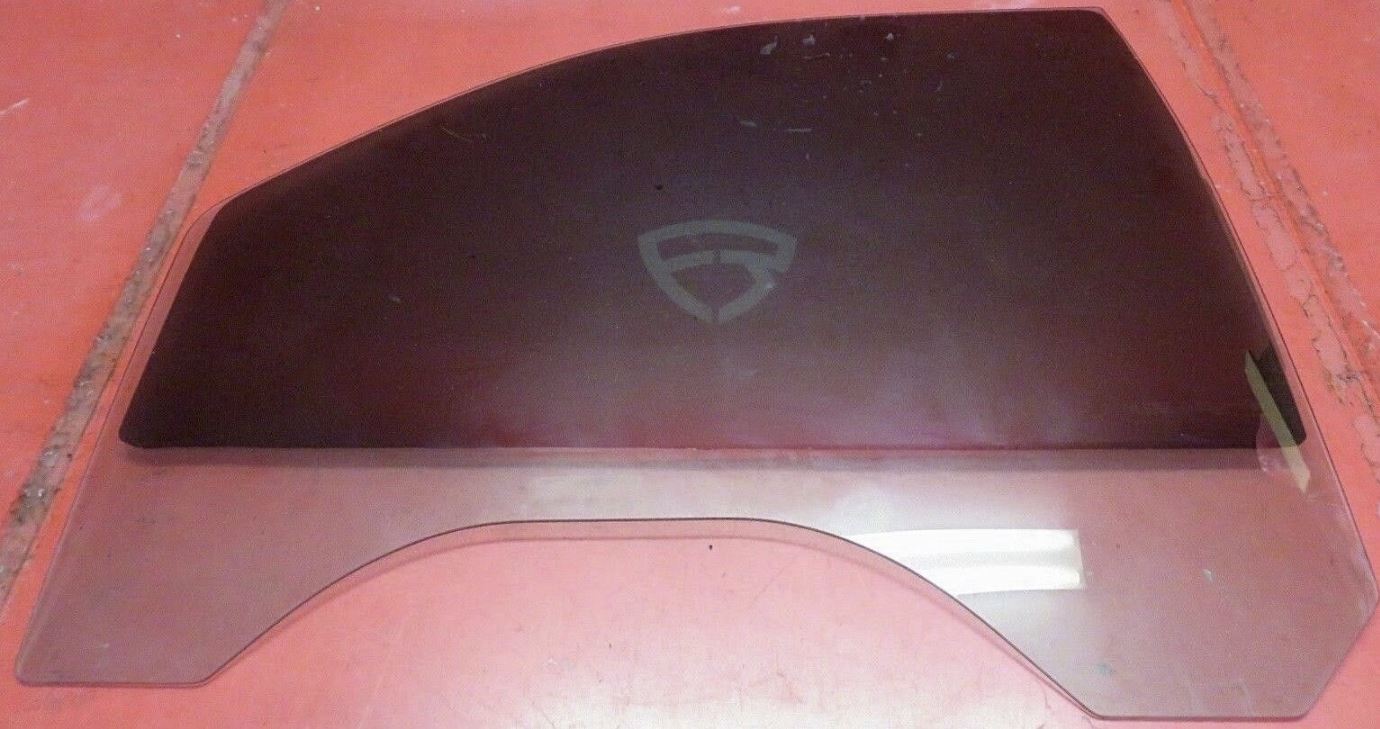

here is a used glass from a escalade and a new glass for a yukon, I wonder what the difference is

The Escalade glass is indeed different. It’s made by Saint Gobain Sekurit. It doesn’t say it is acoustic and it isn’t double pane but it sure does seem like the Escalade is quieter inside than the Yukon. The shape of the glass is different because the doors are different.

As far as I know, the Escalade and Denali has tempered front windows where the Tahoe's and Yukon's do not. I believe it's part of RPO BS1. I think I'm right because my 06 Sierra Denali has RPO BS1 and the front windows say solid tempered, and my 09 Tahoe LTZ does not have that BS1 code and the front windows don't have the logo on them.
