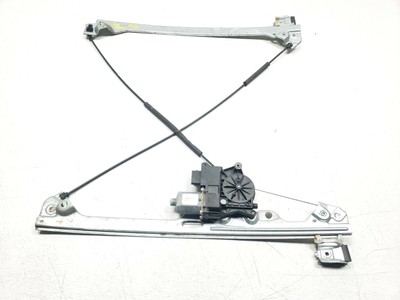

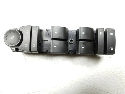

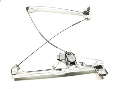

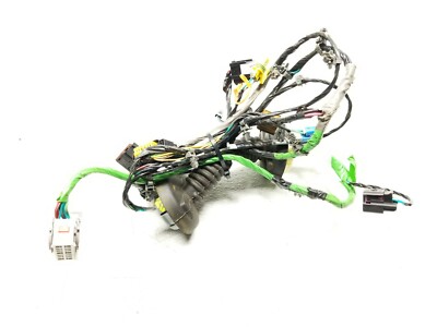

If anyone is interested in doing this here is most of the parts all from one seller. Would just need the driver front door harness and passenger front window switch.
