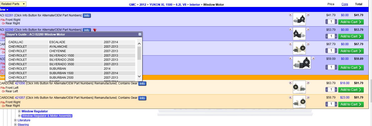

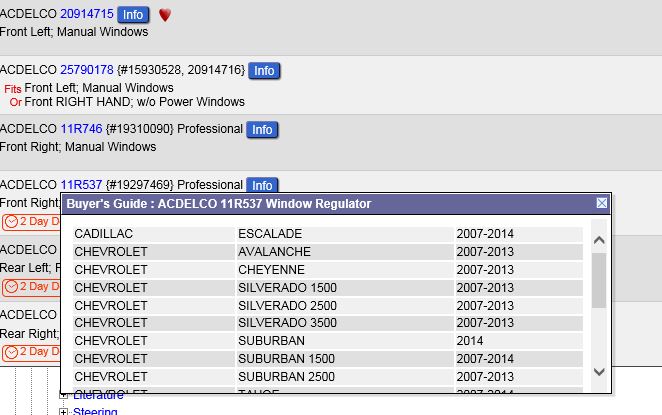

my guess is you would just need the main door switch that is already programmed and "maybe" the harness, The regulators are not any different otherwise regulators would be a different part number and they are not.

well the regulators are the same, that's why I said that, there are no regulator options/rpo's for express up.down, the same regulator fits 07-14

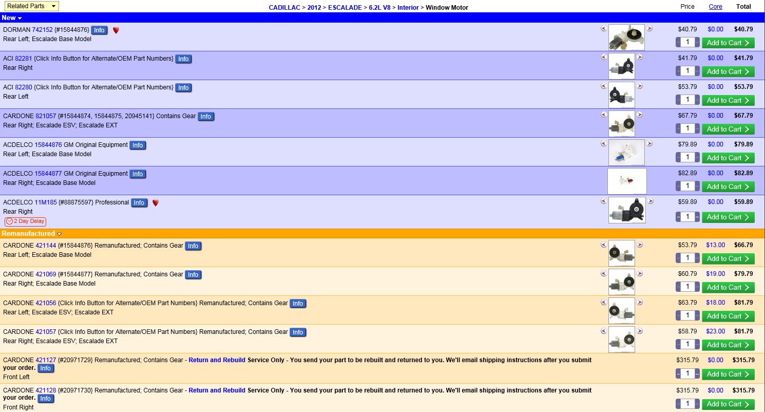

I trust GM’s parts catalog before Rock Auto. Even GM Parts Direct shows different regulators for 09-14 Escalade than for the rest of the 900’s.

edit:: my 18 Silverado has express up/down on both sides I thought my Denali did it's only express down there is apparently a specific motor that cardone want $305.00 to rebuild only and others are the same across the board like the regulators, makes no sense
30,545
47,988
what is the part number's? gm likes to change part numbers all the time, when you figure it out can you make a list of what is needed?
