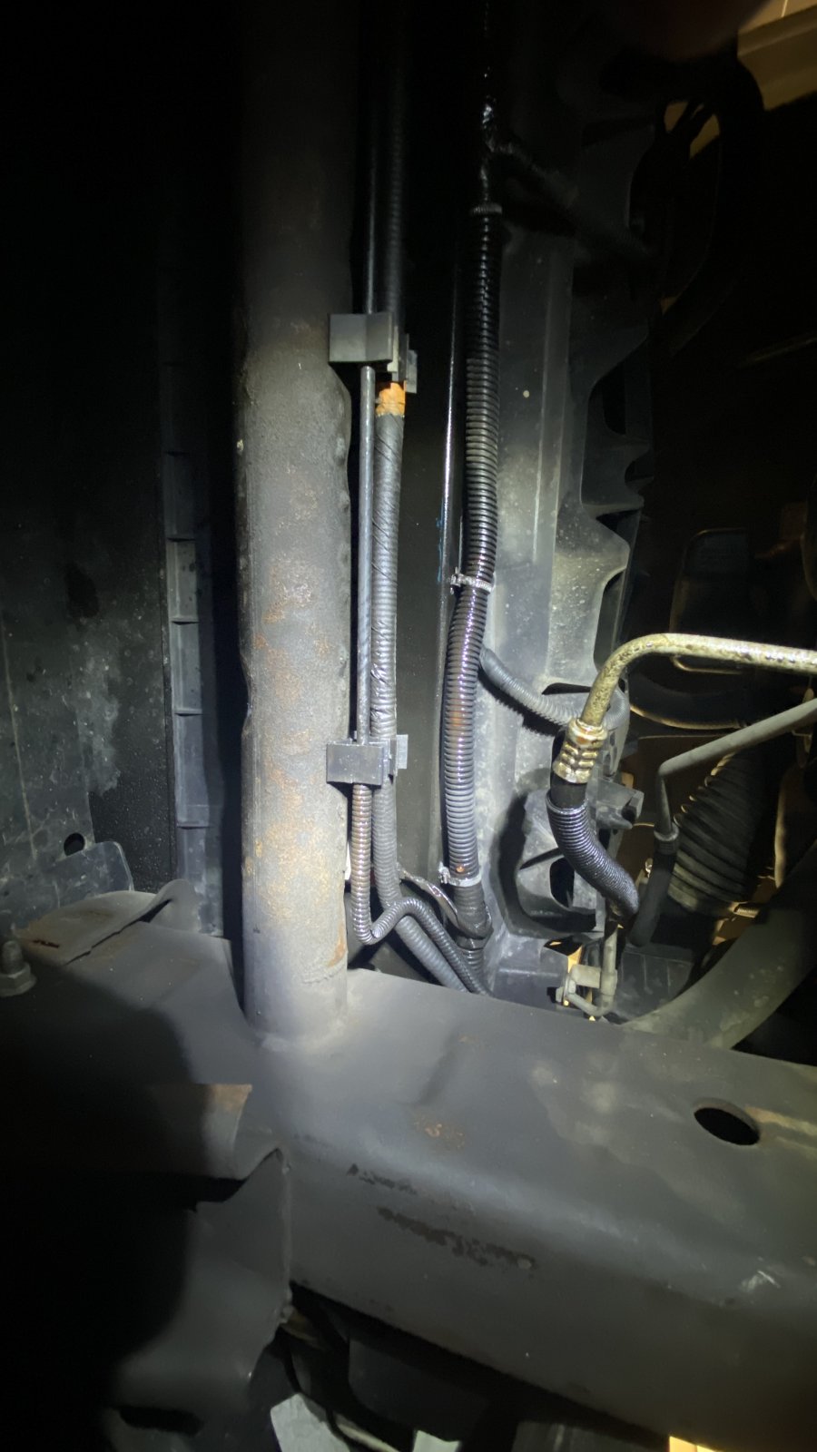

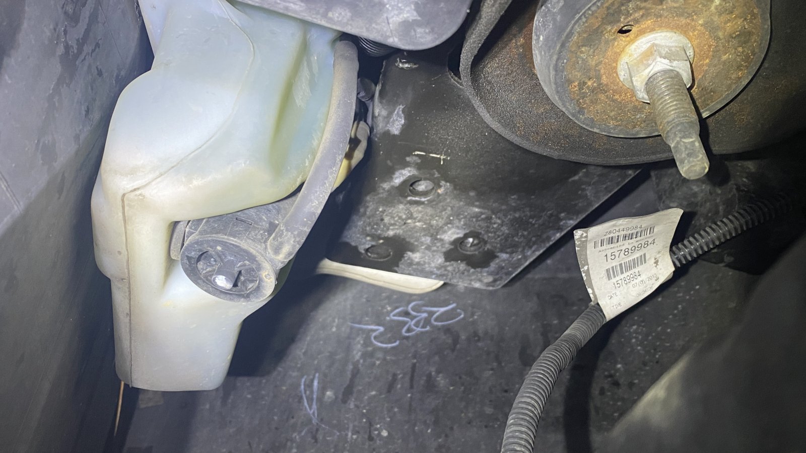

Ok, great. I just drove her and left the Yukon at home. I got under it, removed the plastic engine skid and took pics before cleaning it all so I can get a fresh look. It’s all along the bottom of the fan shroud which is just behind the radiator. I couldn’t any in other places. Mostly here and some dripping down passenger side. Found a dead bird. LOL

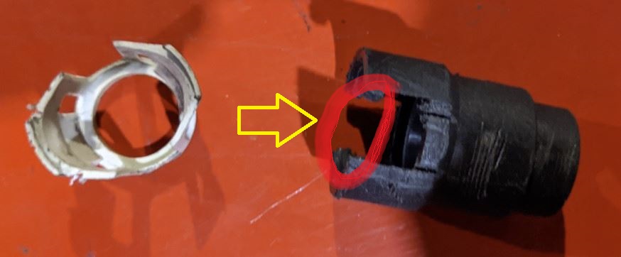

ok, so due to age what happens is the plastic "t"'s get brittle and so does the plastic end of the hose so it's really best to do both

getting the old ones off can be a real b*itch even with the special tool, so my suggestion is to just cut the plastic clips off with some wire cutters, you will see each hose/T has a part you can squeeze that should release the clip but over time it just becomes extremely hard to do. so just cut the thin part on both sides then the connection will come right off, the new ones will have new clips anyway. it can make the difference between a 10 minute job and 2 hours job
Mine came off easier than that on both trucks, thankfully. I found the trick was to push inward firmly on the tube coming into the part of the fitting I was trying to release, and then squeeze the tabs with either my fingers or a pair of pliers. I was able to get all of mine to release that way with no fuss.

maybe it's the CA heat but after struggling with the first one and feeling really stupid afterwards realizing it could just be cut off then I just cut them now.
it's like trying to untie a hard shoe knot, when you can just pull the shoe off instead.

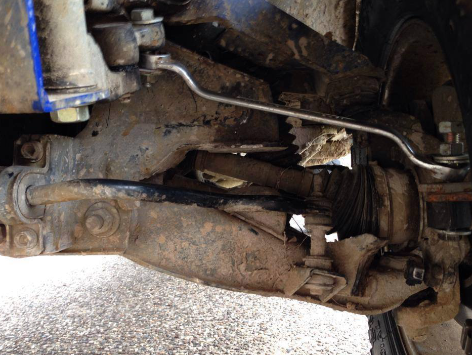

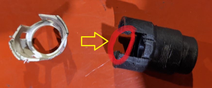

That is a serious "REDNECK" repair. I wish I could say I haven't seen people do some crazy stuff....Gotta pray that is an old school Craftsman, Snap-On, or Matco wrench...Lord help us if that is a Wally World Chinese POS tool.
Judging by the mud, my guess is that was a trail repair to get him home after he broke a tie rod end in the woods. If so, then it makes sense.

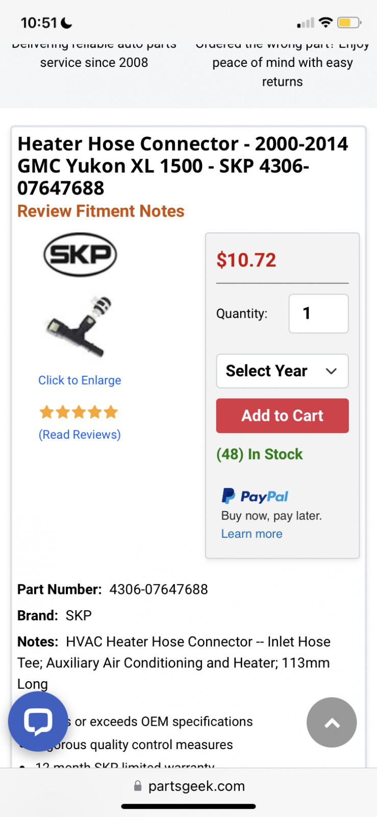

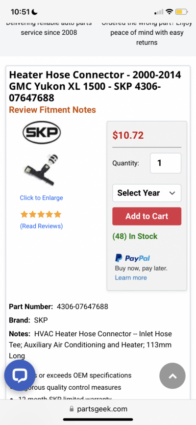

heater hose w/metal y fitting, Dorman# 626-553 or NAPA# 827-5730-1
@Doubeleive, @Joseph Garcia I've got a 2014 and it keeps saying most of the parts linked to won't fit (Amazon). It says this heater hose fits, but it's got the plastic y fitting.
unfurl="true"]https://www.amazon.com/gp/product/B0B933FBYF/ref=ox_sc_act_title_5?smid=A3GYAGS013ULEZ&psc=1[/URL]
Will the one with the metal y fitting work, but Amazon doesn't recognize it? It looks to me like the shorter hose has the wrong bends in it and I'd need to find the right one to get that metal y fitting in the apparatus. Thanks for help
So far these are the parts Amazon says will fit:
