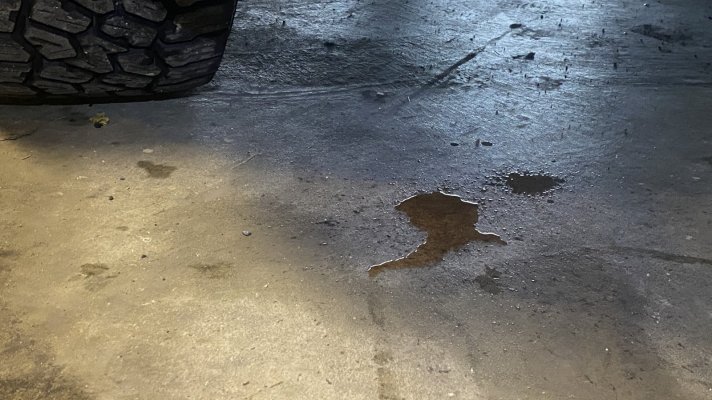

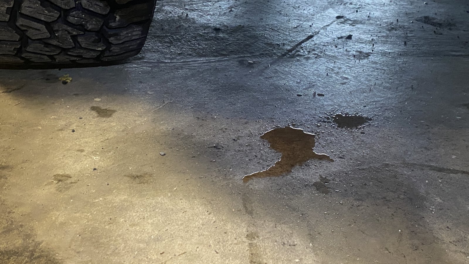

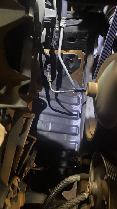

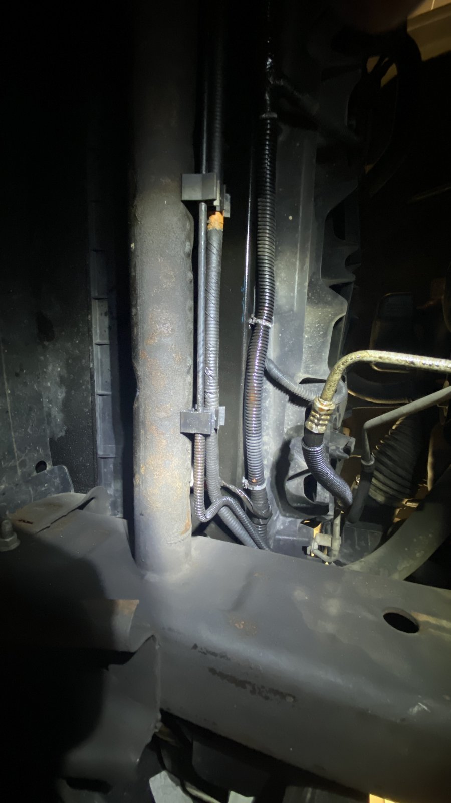

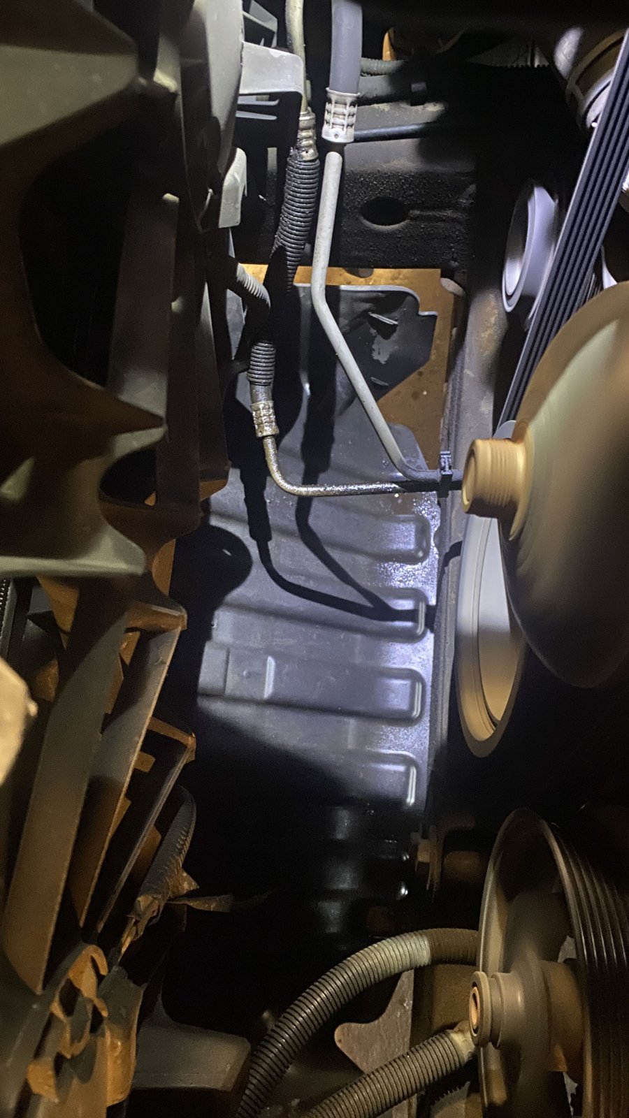

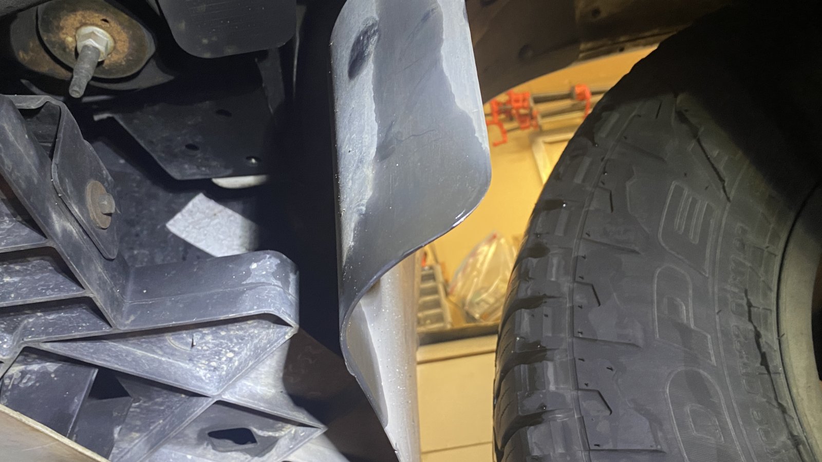

Here’s where I am.
Coolant was low. Nothing visible in the surge reservoir. I had some on hand and followed the instructions in owner manual to add to cold full mark. When I cranked it the level dropped and I added more. I didn’t have enough to bring to the cold full line, but I allowed the engine to heat up with the cap off till the upper radiator turned hot, affirming the thermostat and water pump are operational. The air was at least warm in the car with engine temp at 195 in a cold driveway.
I did notice about a tablespoon of coolant under the passenger side. I didn’t think I missed when adding to the surge reservoir, but no more drips as I watched it for 10-15 min.
My plan is to go get some more coolant to bring it up to the cold full line. I’m open to more advice. Thank you so far! Great stuff.
Here are a few pics.

Here’s where I am.
When filling the coolant tank, it's easy to slosh it around the threads in the opening. There's a hidden drain where the radiator cap seats to safely capture any coolant that might escape when the pressure in the system causes the cap to release pressure and vents it safely out the bottom. So it's normal to have coolant under the pax side of the car after dumping some into the reservoir unless your aim is improbably perfect and none of it touches the threads.

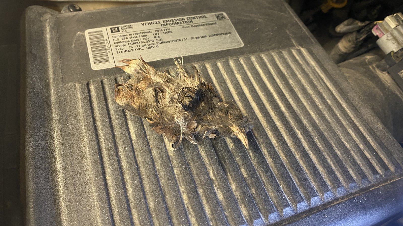

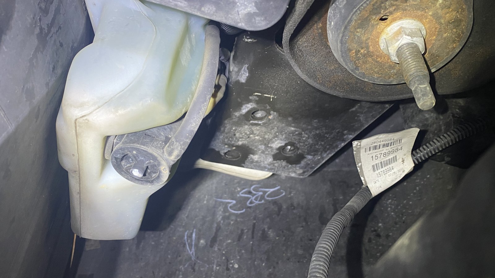

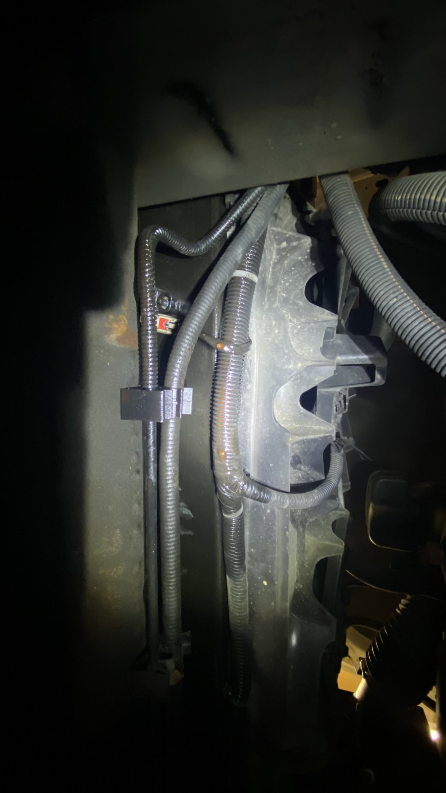

Ok, great. I just drove her and left the Yukon at home. I got under it, removed the plastic engine skid and took pics before cleaning it all so I can get a fresh look. It’s all along the bottom of the fan shroud which is just behind the radiator. I couldn’t any in other places. Mostly here and some dripping down passenger side. Found a dead bird. LOL

By your pics, my guess is the radiator itself or the water pump. Stuff get splashed !
Check your end tanks on the radiator- they are plastic.. That's prob where you'll find
the leak. Good Luck.. Radiator Job is fairly easy on these

I bet it's a cracked plastic side tank, par for the course on these.
not sure where you sit on money but don't cheap out on the radiator it just causes more headaches
if you can do those heater hose "T"'s at the same time because those will break next may as well get it out of the way.
View attachment 386373View attachment 386372View attachment 386374View attachment 386376View attachment 386375
Good job with the pics. Helps a lot with looking for the the problem. Keep at it.
