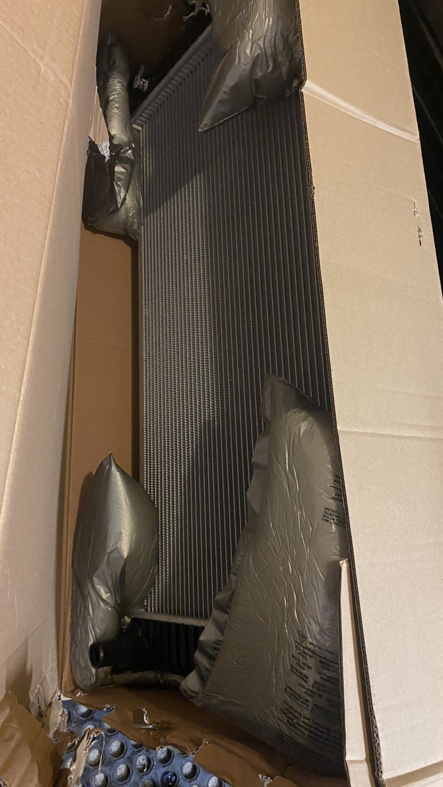

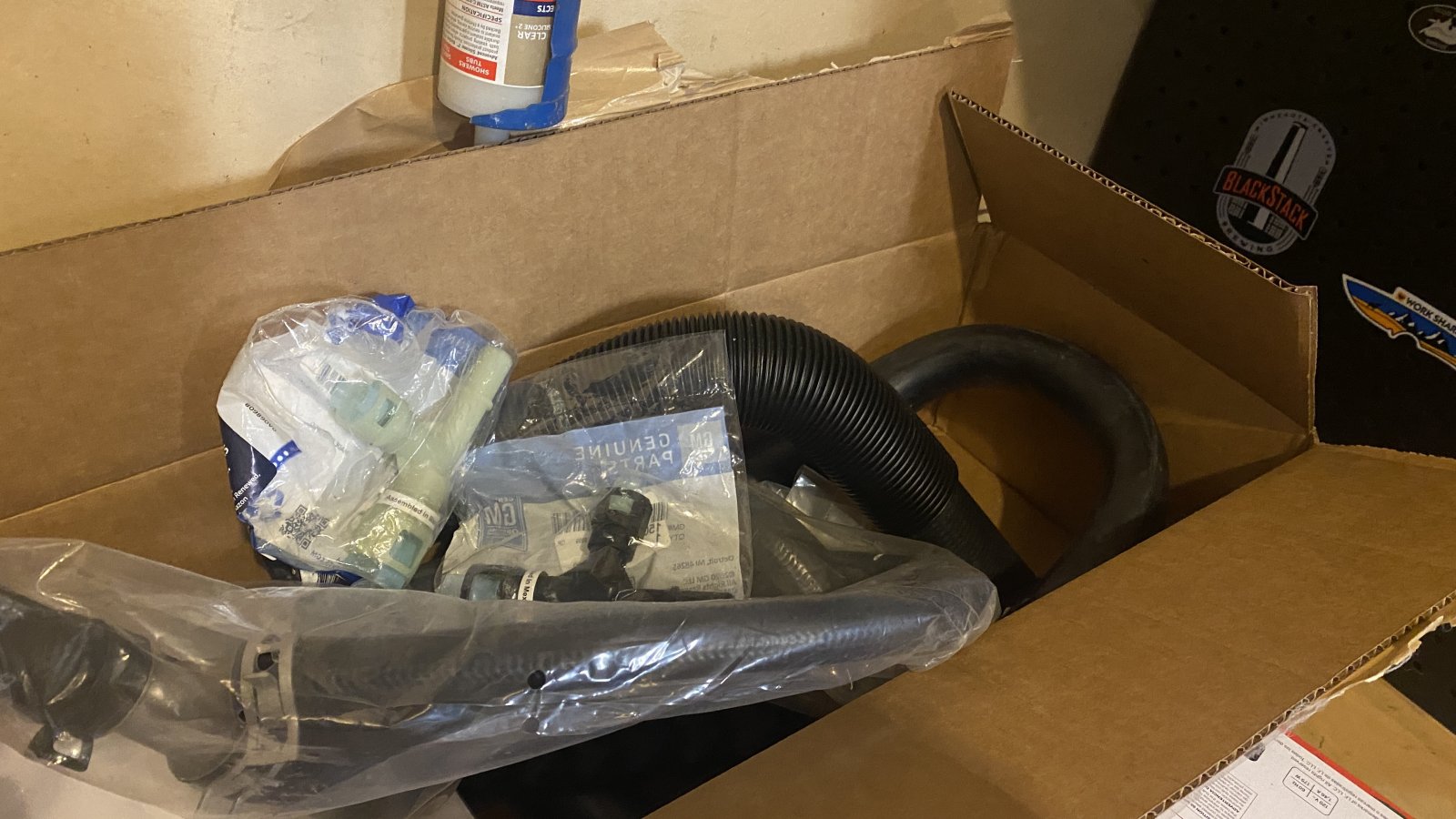

I think all the parts arrived. This is a cooling system overhaul. Pics or it didn’t happen. Radiator, hoses, heater T’s.
