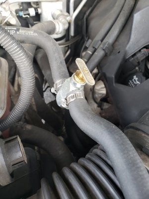

Can we get a pic of the fitting you put in the hose.
This is what I used. I got it from summit. It's done great to stop the coolant from bypassing my thermostat.
Unfortunately I've having another issue now. As soon as winter ended my engine stopped reaching 210° again. It's not bypassing the thermostat like before though. I'm guessing the thermostat is getting stuck open. I don't really care right now since the weather is only going to get hotter. I'll deal with it in the fall.
