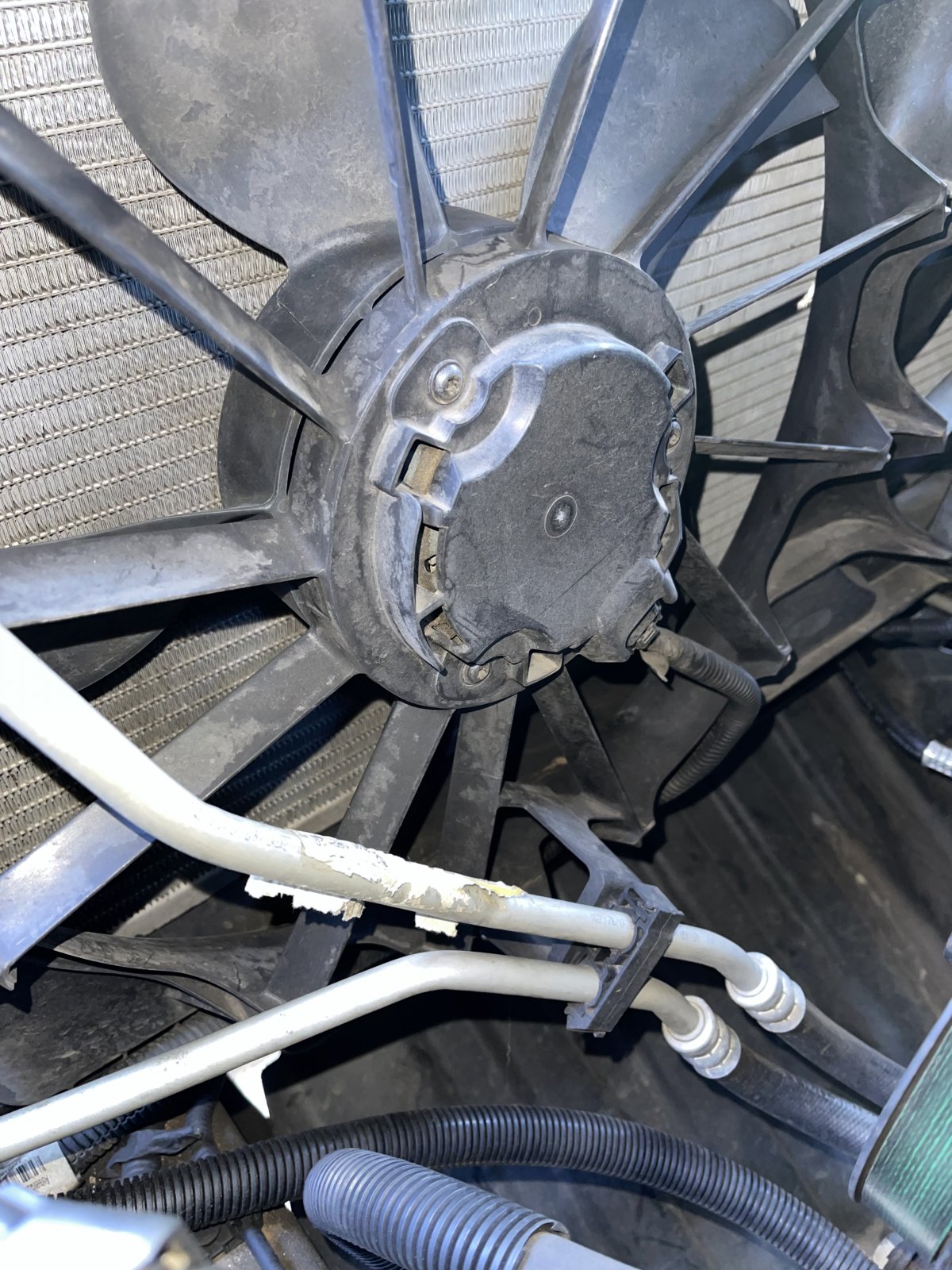

I just got off work, and checked both cooling fans on my Escalade.
Both fans are 5-blade, rimless.
I counted the blades on each fan a few times to make sure I was correct.
Sooo…an upgrade may be in my future.

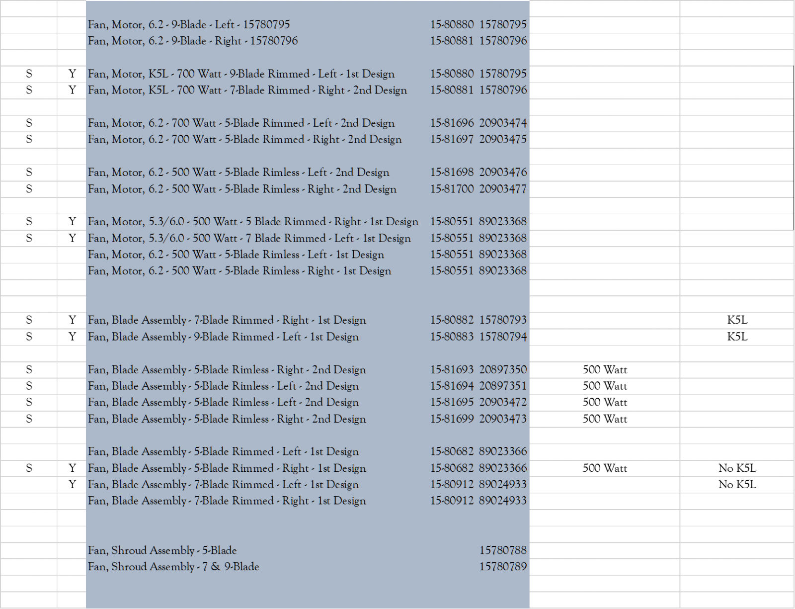

In my research on this topic with both the Yukon, Yukon Denali and 6.2 Sierras, all of the 5 blade rimless designs used 500 watt motors and was the 2nd design.
Here are my notes:
On the left, S is for GMC Sierra and Y is for the GMC Yukons.
This was information gathered from ACDelco, GMPartsDirect and GMPartsGiant. It's probably why I can't see anymore! So much small writing! LOL

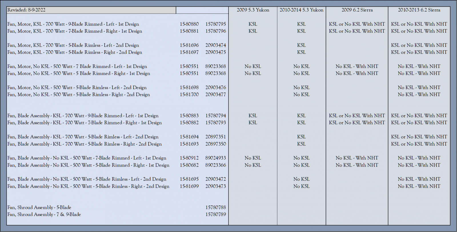

Just remember, I'm half blind and my notes have not been peer reviewed. Some of the data could be inaccurate.
21,382
30,471
Ok, it was bothering me and so I revisited this chart until my eyeballs quit seeing clearly:
This chart was made from my notes and used only ACDelco's parts catalog. I cannot pull up the Denali Yukons on ACDelco's website, don't think it matters though. I was able to pull the 6.2 Yukons for 2010 and 6.0 Yukons for 2009. I did not look up the Hybrids. All of the Escalades have the 700 watt fan motors and use either the 1st design 7 and 9 blade rimmed fans or the 2nd design 5 blade rimless. As Steve Lehto says, questions or comments put them below!

I just looked at both cooling fan motors with a mirror and flashlight.
I was unable to see any kind of part number on the motors. The motors are set in the fan shroud, which covers the motors.

apparently some have a visible part number between the edge of the inner fan blade and motor, otherwise you have to pull the shroud out, take the clip off the front end of the blade assembly and then the 3 bolts on the back. even then the part number may be hard to find depending on the age of the motors and any surface rust. No sense in doing all that unless you have the new motors in hand already.

I think you're good to go, ACDelco's website shows all of the Eskys getting the 700 watt motors and you have the second design with rimless 5-bladed fans.
