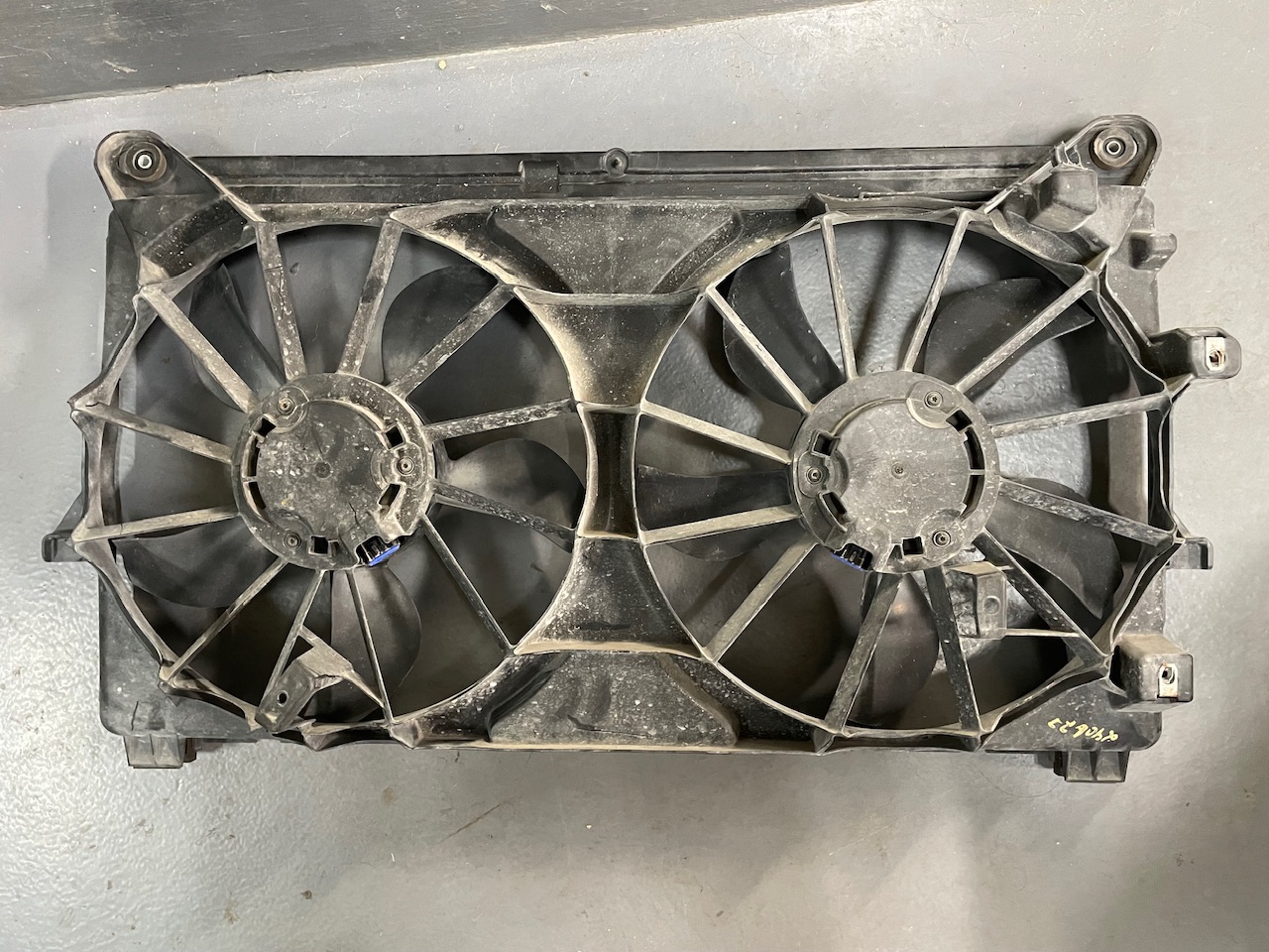

What's the deal with the second design of K5L? (With 5 blades each)
I bought one to replace my 7/9 blade setup because the A/C motor was getting noisy. It was the same price to get a used set as 1 new motor.

My old 7/9 setup had a crack on one of the radial slat supports. Affected nothing, but I figured I might as well try the 5 blade setup.
(2nd design should be better right? Or cheaper...)
I bought one with 100k miles, but I think this truck has been in the dust.
We'll see, I may still need new motors!

Not sure if the second design shrouds are different between 500w or 700w, they do have different part numbers though.
Looking at @Doubeleive's photos, it looks like the 500W 5 blade setup has a bump on the motor mounting plate along with some ridges along the edge.
Whereas the 700W is flat with no ridges.
Mounting bolts look to be located in the same area..
Looks like they use different fans and shrouds despite looking so similar..

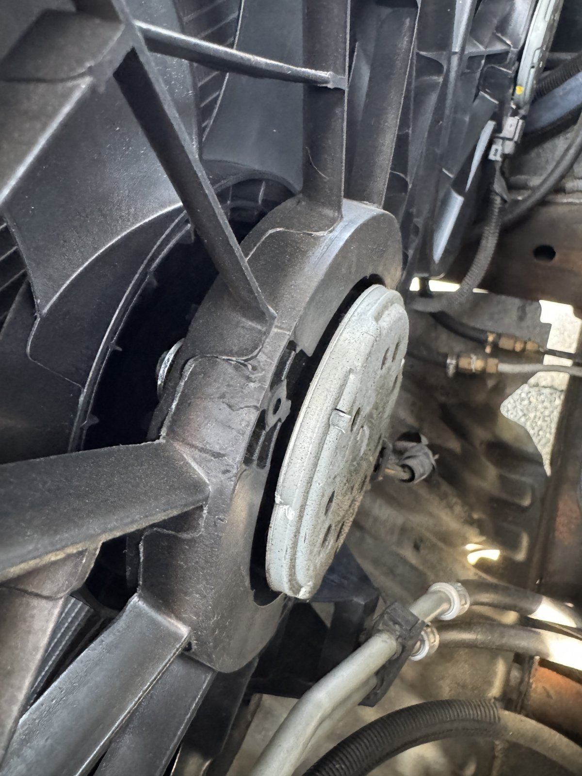

Thanks for taking the time to call them. However, I'd be very surprised if that information is accurate. The factory motors for the non-enhanced cooling package are 500W, and these do a noticeably better job of cooling than the ones I replaced. When these fans kick up to full duty cycle when climbing a grade pulling our camper on a hot day, my coolant temps actually drop significantly back to the center line. That was not the case with the original fans on it. You may remember all of the trouble I had keeping this thing cool originally when I first started experimenting.
Just ran outside to look at the motors, and they are thicker than the motors that came out of it. I believe that thickness is the primary visual difference between the 500W and 700W factory motors.

Just for fun, I dug out the leftover 700W motor I pulled from the previous fan shroud when I threw it away, and measured it. I had replaced one of the motors with a 700W one to see if it would be enough to make a difference, before I bought the whole Dorman assembly (it didn't help enough).
The motors in the Dorman assembly are about 1/4" thinner than the GM 700W motor, but about 1/2" larger in diameter.
