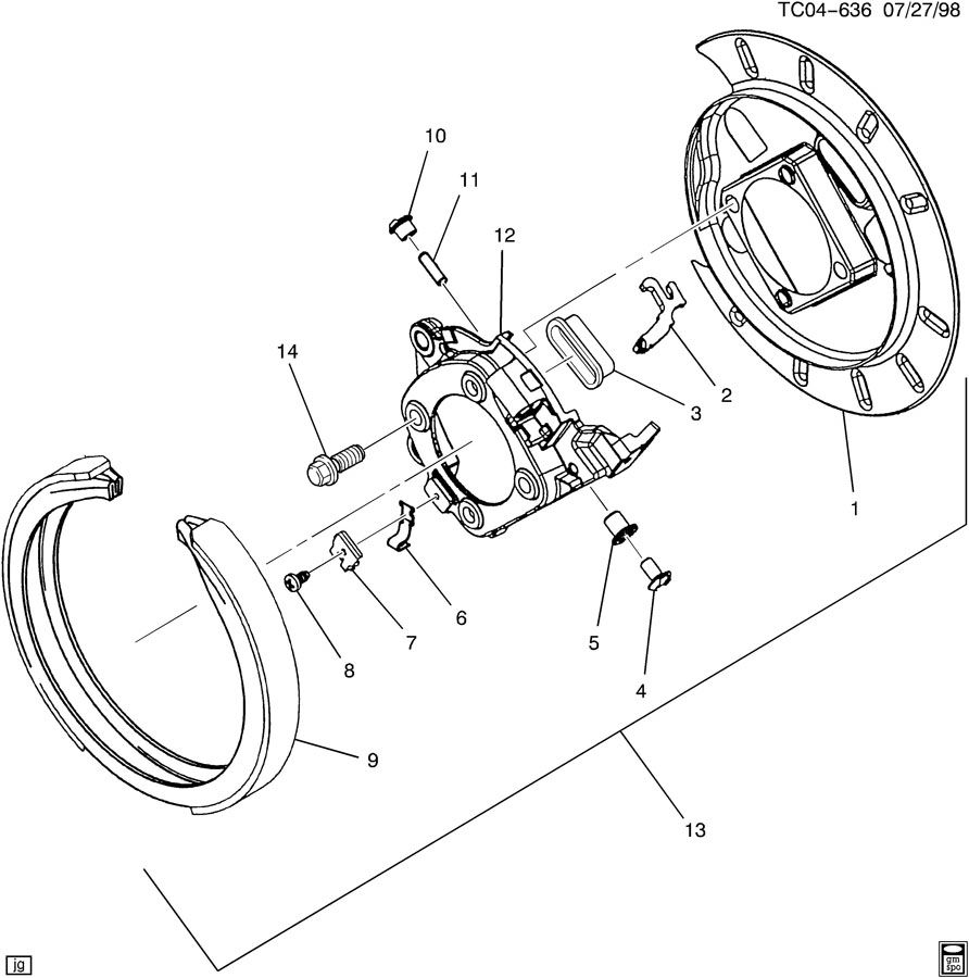

I'm repairing the emergency brake on my 04 Tahoe. I have all the parts I need except one because I don't know the name of it. It is the pivot point that attaches to the end of the brake cable at the backing plate. Any ideas on the name or a part number would be of great help. Thanks.......

image.jpeg I don't think so. It's the lever at the backing plate that in this case the right side parking brake cable clips into. I believe it's #2 in this diagram.

If any one is doing this project, I highly recommend the Dorman 2 piece backing plate, about $18 from Amazon per side and the Dorman hardware kit, $20 for both sides. It's not a bad job and very rewarding when completed. Plenty of videos of how to on line.

Well it seems I jumped the gun. The part I needed is not in the kit even though I was told it was. So I went to the dealer and was informed the only way to get the part I need was to order a complete e brake kit that includes many parts I already have. I ordered the kit and will report back how I make out.....sorry about that....who knew this would be so hard.

Got the ACdelco kit from the dealer today. It does include everything in the diagram above. So it turns out I have an extra set of parking brake shoes. The hardware pack I'll return. If anyone needs it, part #19178801. List $120 for both sides.

@David Paul is everything you needed in this package? Does that also include the parking brake shoes?
Yes this includes the shoes and all hardware for both sides. You might try one of the on line dealers for a better price. That's why I posted the part #. I would have but the truck was up on the lift and I wanted to get the job done. Hope this helps...
