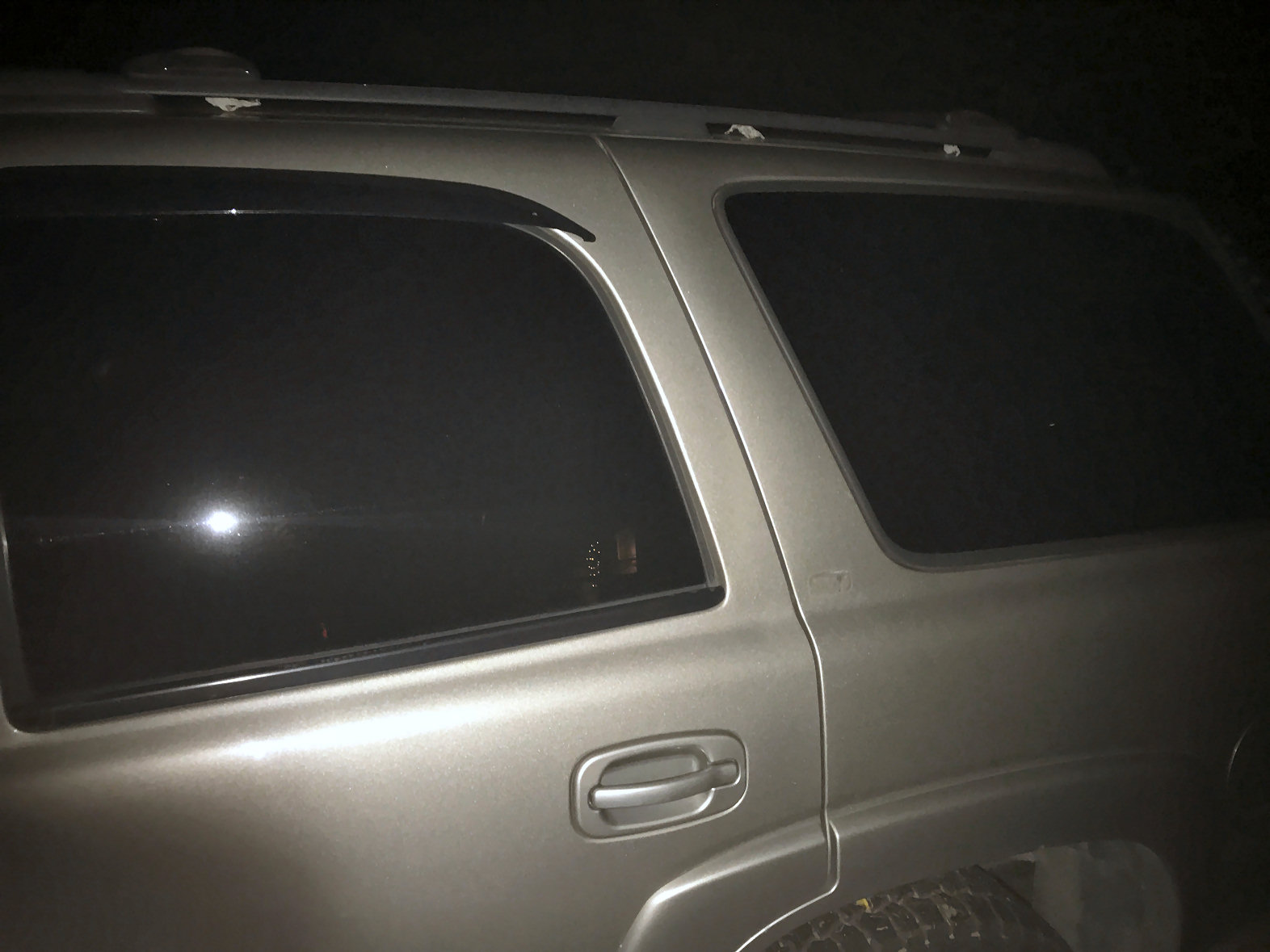

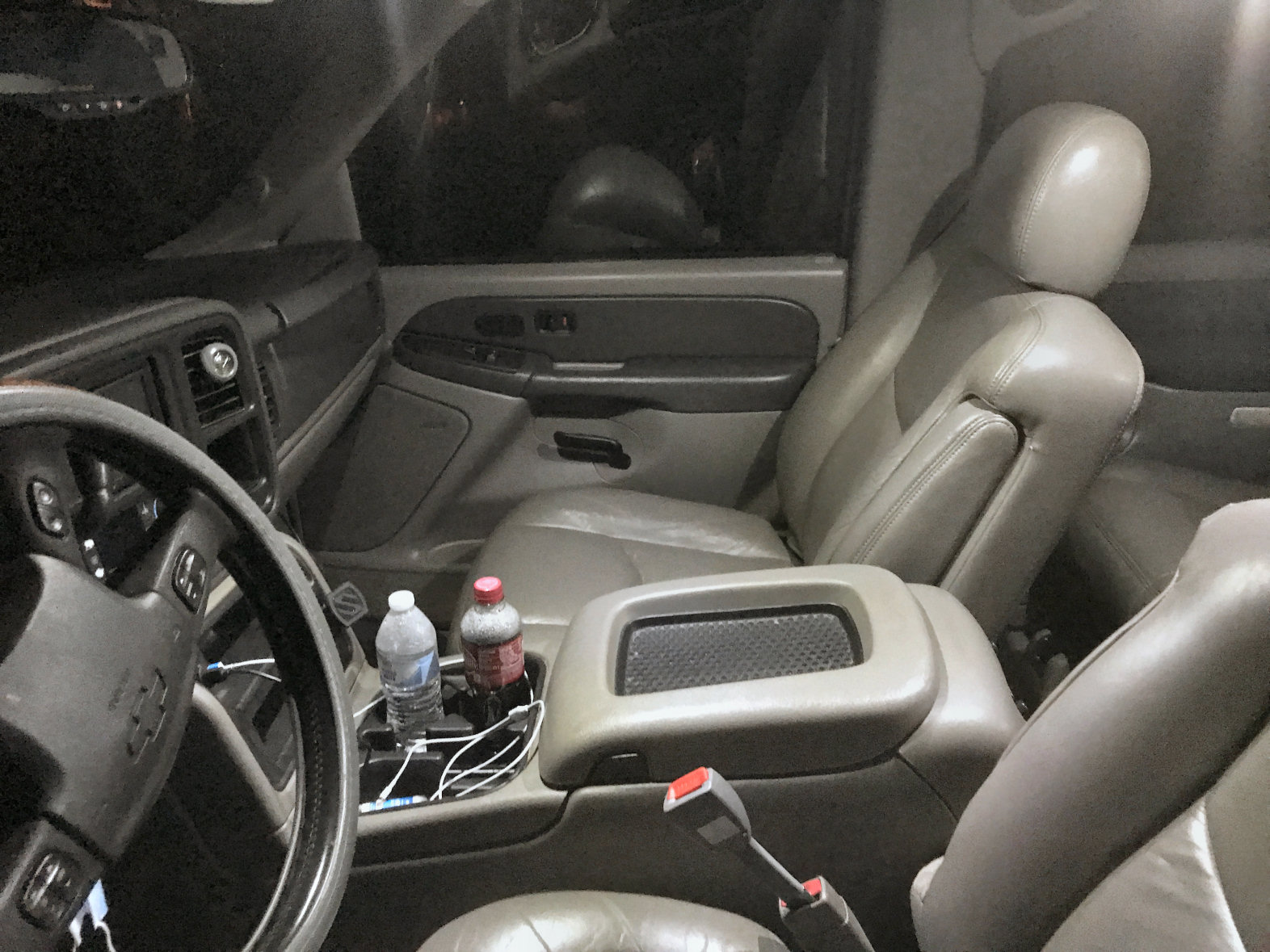

UPDATE
I got my LEDs installed on the inside. They make a HUGE difference, especially since there weren't any lights on the inside when I got it. :(
I didn't realize just how dark the rear tint was until I tried to see my new LED lights through them...
This is with the flash on, because the pic without the flash was completely black. I like it!:cool:

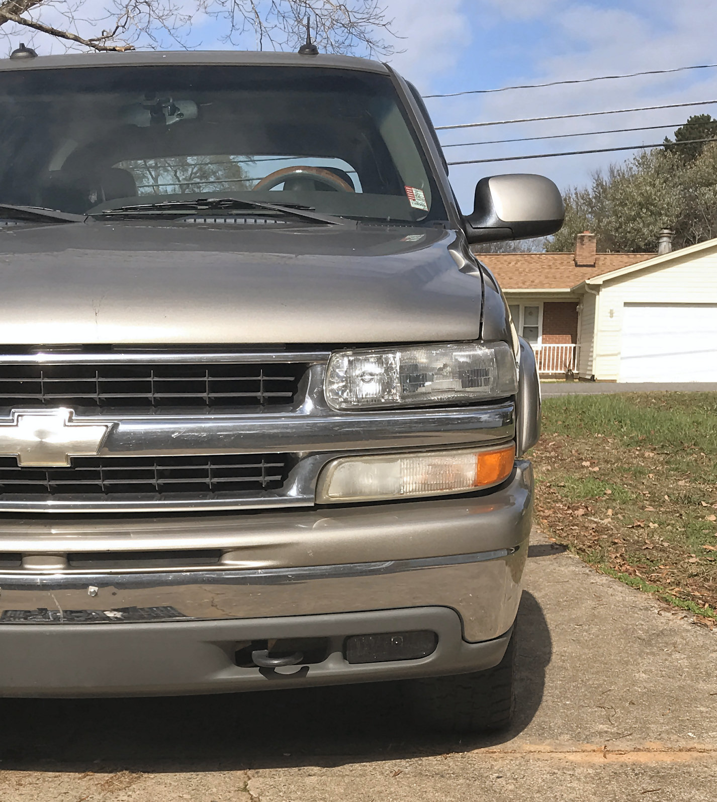

I also got my fog lights replaced. They're OE style replacements with bulbs for now, but they'll be holding LEDs before long.
Take a close look. The smoked lenses look really good, but my headlight is crooked! I also noticed that my bumper sags on the passenger side.
So, I should have guessed it, one project completed, two more projects added to the list.

You have 2 pins holding your headlight in place. Make sure the pins are lined up in the holes correctly. As for the bumper--very common issue, mine is the same way. You could always loosen the bumper on that side and jack it up with a floor jack, then tighten it up. Might work.
Your led bar might look good. I think there was 1 guy on here that did something like that.
