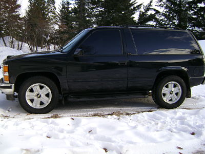

Just finished a 2 inch rear, 2.3 or so front lowering on my 4x4. We have almost exactly the same diameter tires...your are a bit wider. There is a ton of room on the inside though, so if your offset is close to mine, you should have lots of room.

Oh, sorry for double posting, but you will notice something funny when lowering these trucks via keys... The wheels actually push out in an anoying way. I lower all my 4x4 newer style vehicles, and the obs tahoe is the first I have seen that pushed the wheels out so crazy far with just a couple inches of drop.
I will be doing a custom wheel on mine, ordering with a more inset wheel to compensate for the way the wheel is pushed out. I would have felt bad if I didnt mention the way the wheels pushed out, just incase you already had a wheel space to your liking for outer lip to fender well relation. Your 22 inch wheels will push like 3/4 inch outwards per one inch drop you do on the keys.
