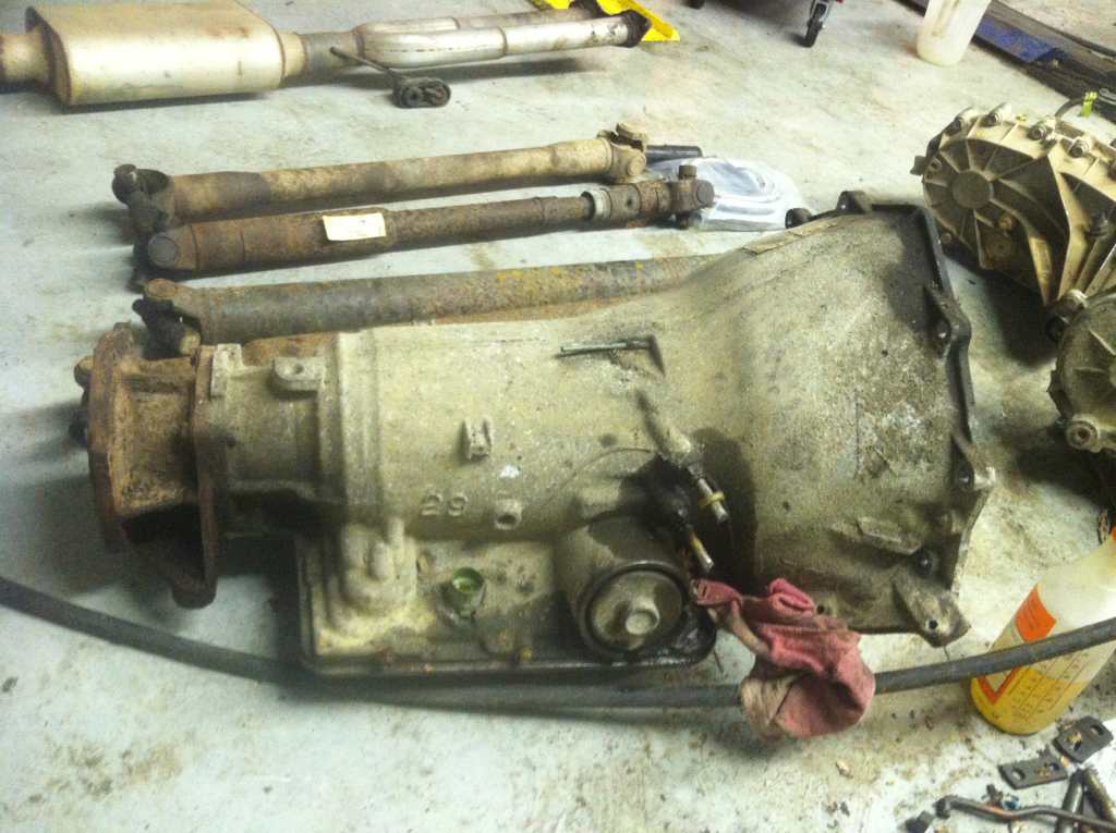

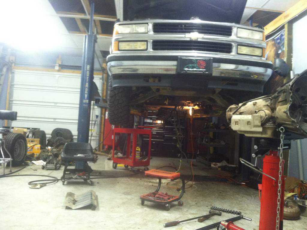

Blew the motor in my 99, grabbed a 97 to pull the drivetrain and swap.
Already the trans and transfer case look a little different..
Can anyone elaborate?
Help explain what I'm in for?
This is as far as I got since yesterday:

Trans could be a one piece case, the flywheel and torque convertor are different ...

You will likely have a autotrac tcase a a differnt tranny bell housing. Reuse everything from the flexplate with starter teath on it back if all still good. Just switch out the long block and all should be fine. Will that suffice?
---------- Post added at 06:55 PM ---------- Previous post was at 06:54 PM ----------
Oh likely need to swap oil pressure switch too as well.

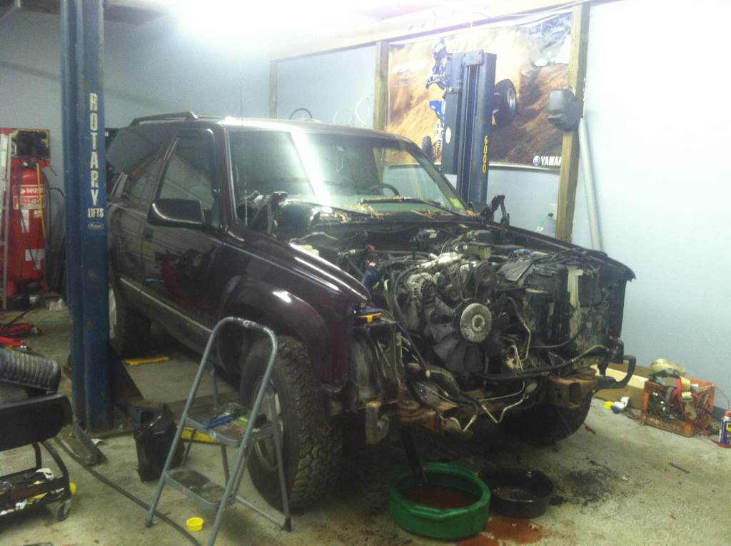

The red 2dr 97 has the good drivetrain.
My intent is to install the engine, trans. And possibly the transfer case all into my 99 black 4dr.
The black one blew a rod and the trans was starting to have real delayed shifts and stuff. Just acted funny.
The red one has a fresher motor, and built trans and transfer case which is why I want to use them as well. The motor is so quiet no ticks or knock.. Doesn't leak a drop or smoke.
So far the measurements are slightly different in length of the trans and transfer case.
Just looking for some input of anyone who's experienced such a similar swap.

If you had auto 4wd in the 99 the 97 tcas will not just drop in you are looking at major work on that alone. The tranny should bolt but improvements on it made since 97 that would not be there now may require some pcm tranny perimeters tweaking.

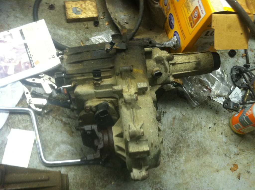

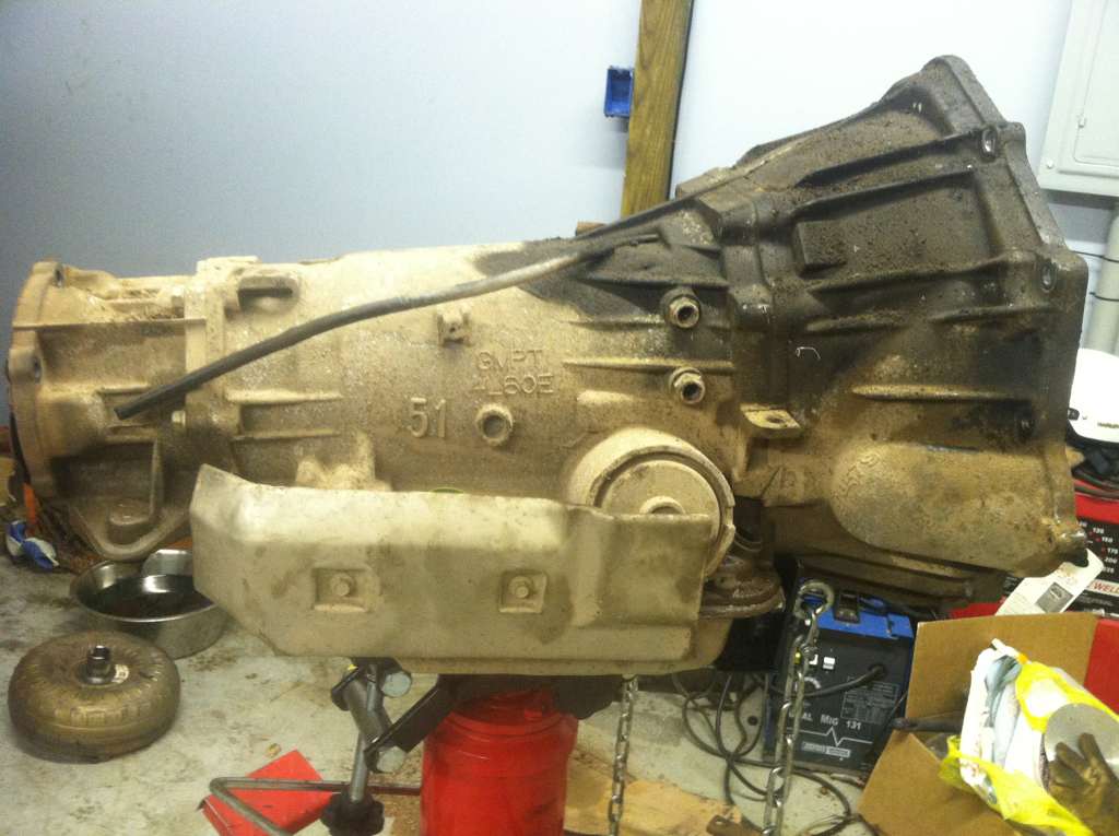

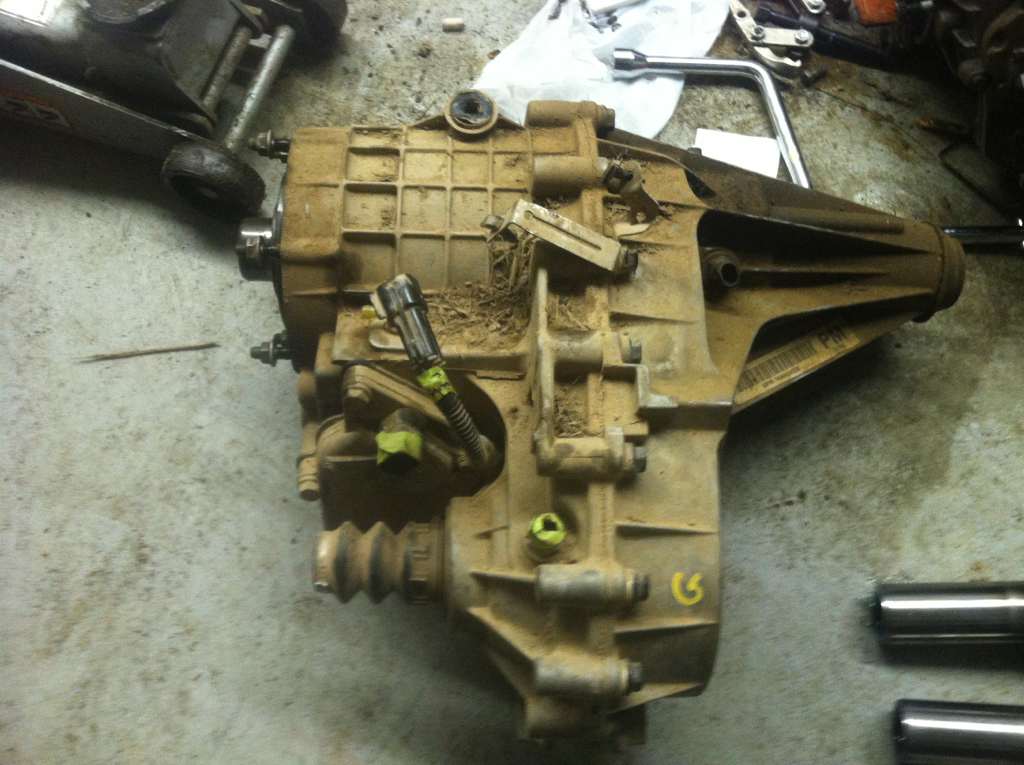

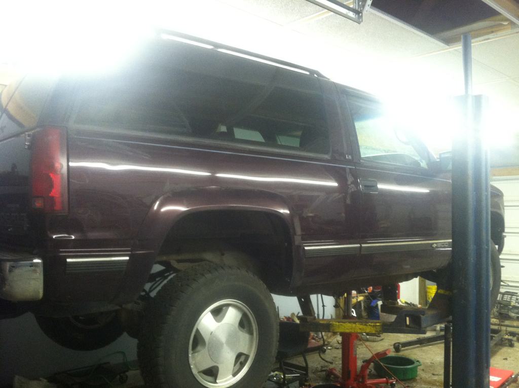

Here's some updated shots
Here's the trans and transfer case from the 97, can anybody help me identify what kind? And what I'm in for if I try and use them in the 99?
Hers the 4l60e from my 99, it has real delayed shifts. Tells me it's on it's way out? Also the torque converter had no fluid in it and sounds like something is loose inside it. Is that correct?

They are both 4L60E transmissions, you can see where it says that on the second one half way down the housing. The first one is a singe piece or one piece case as they call it, the second one shown is a removeable bell housing. That probably has a 300mm input shaft and convertor, that is the more desirable piece but if that's the one slipping no matter.
I don't know about later model transfer cases to go and open my mouth here, someone else can help you there.

there are round id tags on the tcase bodies that identify them. the tranny ones should usually be stamped on the case just above the oil pan.

The top trans photo is from the 97 and it has the removable cast bell housing plate underneath.
The lower trans photo is a one piece and had some stupid flat piece of metal blocking the flywheel bolts.

i mention the tcase id tags cause while auto4wd was the norm in 98-and newer it was still possible to get the non auto or floor shifter. but get the id tag info from both tcases just in case. just move the tranny/engine block as in retain the tcase for reuse but let me know the id tags first. m30 is the rpo code for the 4l60e tranny. L31 is for the vortec 350 if you ever run into that term. the tcase will be np1 for the eshift non-auto nv-243. np8 for the auto4wd case nv-246. and was fluid leaking out anywhere in on the tranny when you found this issue?

Also, what about my trans symptoms form the 99? Is the torque converter supposed to be dry and sound like something is loose inside when shook?
M30 was the code for those ... The angle of the lines is different which leads me to believe you need to double check them. :D
If the torque convertor is dry and you shake it, you will hear the plates and bearing move around.

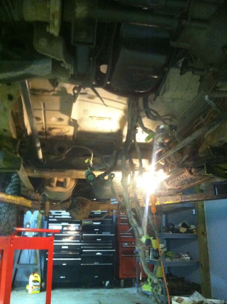

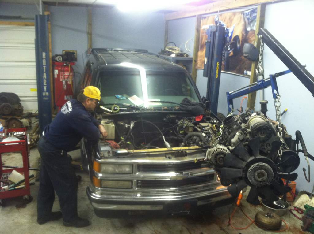

Update pics!
---------- Post added at 09:48 PM ---------- Previous post was at 09:38 PM ----------
Ok I will take them pics of the tags tomorrow as I'm done for the night.
Took 22 hours to dismantle the first truck, only 8 to do the second which includes tagging all connections.
I might actually get good at this! ha.

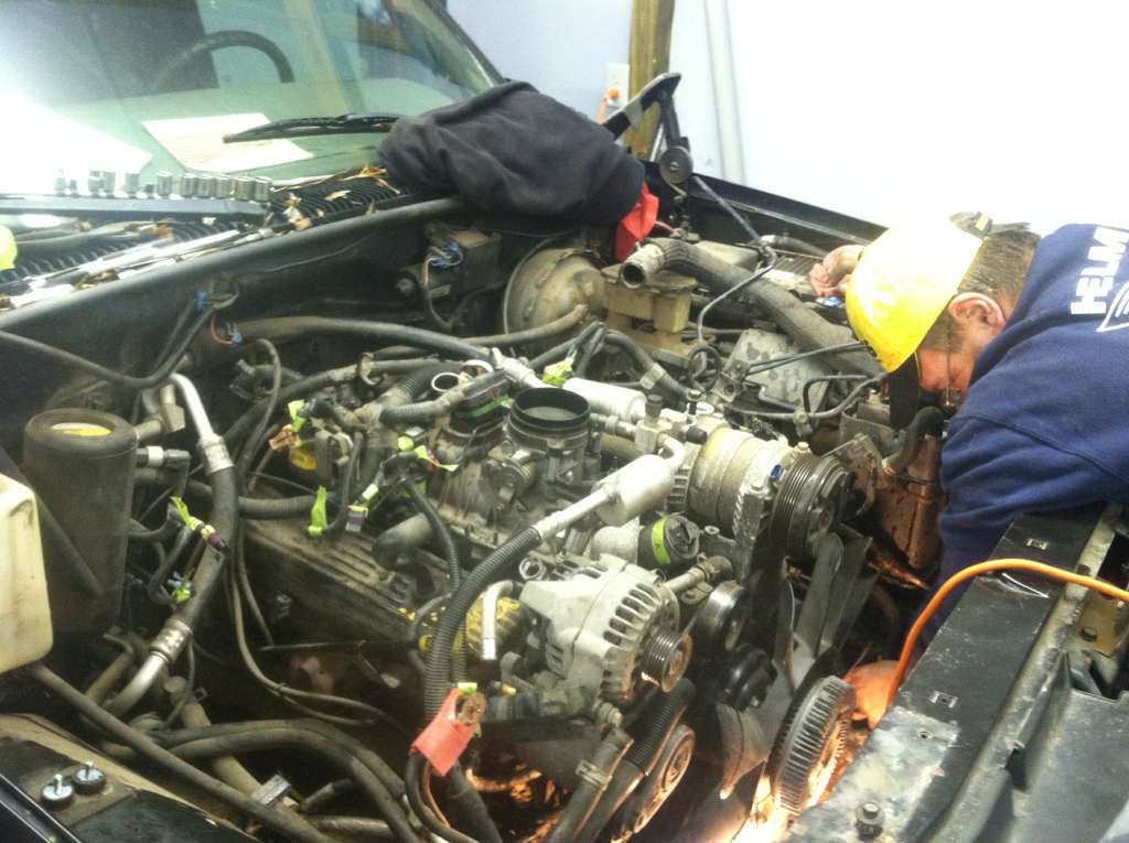

Quick question: Is the motor from the 97 a non-Vortec?
So I think here's my plan of attack:
Clean up and Use good motor from 97. Intake, throttle body, everything. But gonna take my plug wires, coil, and distributor-rotor-cap from the blown motor as they're fairly new. Drop in motor. Connect everything I can.
Mount trans from the 97. Has identical electrical connectors, but the oil lines are slightly angled as you guys said. The ones from the 99 come off straight. Hoping a tubing bender will take care of this..? Trans itself measures 2 inches shorter, but with the other piece bolted to the tail - the overall lengths are the same. Just hoping the splines are the same so I can bolt the autoTcase from the 99 to the 97 trans.
Should it bolt to my existing block and flywheel? Looks real similar..
Or do I need to swap flywheels?
Transfer case: gonna try and use my 99 autoTcase to the 97 trans..
What you guys think?

If you are keeping the 97 motor and 97 trans keep the 97 flywheel and 97 convertor. You will want to keep those 3 together, trans, convertor and flywheel.
97 was a Vortec engine with Vortec heads, there should be a saw tooth pattern on the end of the head if you can see it behind all that bracketry.
If you pulled the distributor from the "new" engine before removing it, then you will have to reset it and it has to be within 2 degrees or you get a code that is somewhat hard to remove.
