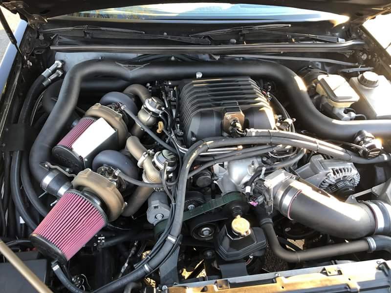

Here's a start..

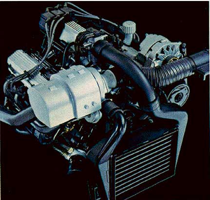

That twin turbo setup was done nicely but not conducive to getting up on boost fast with those long pipes. It might help with traction though. I'd go with a single turbocharger, such as a 60-1 or a little larger for a 5.3 and lay it out to match as close as possible the Buick GN LC2.

I guess you didn't notice the lsa blower sitting in the middle..instant boost!

I wasn't sure what that was. I would call that a large hand grenade. A handsome one, well constructed, but a grenade nonetheless.

That turbo/boost set up has got a lotta WOW factor in it !!!!
