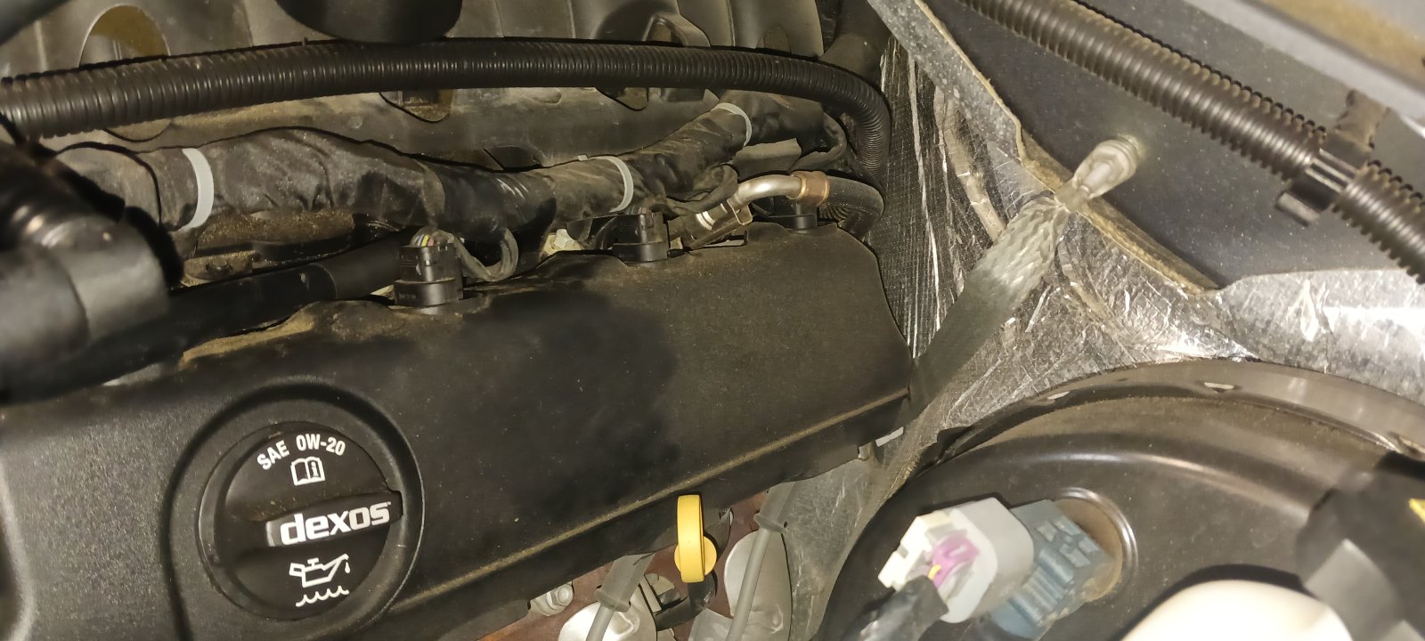

OK, new serpentine belt installed, the belt I removed had a gm part number so I am assuming it was original. HOWEVER the tapping every 10 revolutions continues. Got out the stethoscope and located the source at some pressure hose at engine driver's side rear . Looks like it goes to the intake or VLOM and disappears between the engine and firewall. Visible in the photo above the valve cover almost straight up from the yellow dipstick handle. I hate little strange noises. Guess I could live with it if I knew what it was and it's not terminal.
