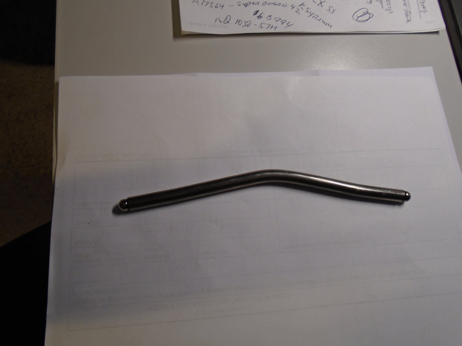

I had the same issue with lifter noise. Well serviced 2018 Silverado 1500/6.2 with 80k miles. Turned out that it was a bent pushrod. I had just finished chemotherapy and could not do the repair myself. No oil change or chemical was going to fix this.
so I paid $5,000 to have half the lifters/pushrod fixed.
View attachment 439898 so I paid $5,000 to have half the lifters/pushrod fixed.
I am in that boat now.......had it towed to a dealership due to an ongoing claim. It happened after the accident, while at the bodyshop, so it's an insurance thing now. I was at the dealership this morning for a loaner and #4 had a bent pushrod. Not sure HOW that even happens......never had a motor do that in my life.
