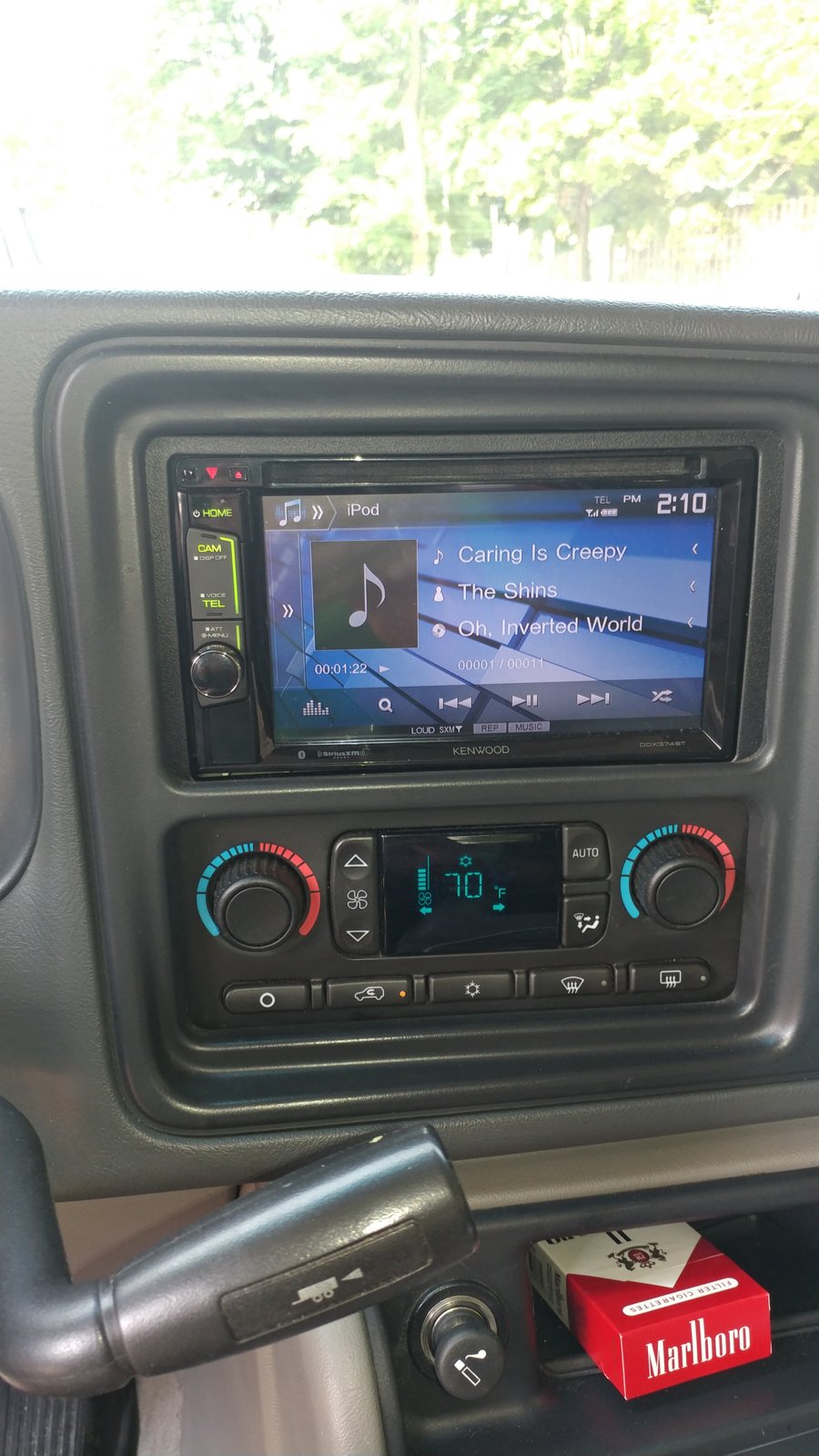

I have a 2004 Tahoe Z71 with Onstar and the Bose system. I am looking to buy a new head unit for the Tahoe and love the double din setup, not looking to spend a fortune. The ones I see online that have been installed have had the dash insert trimmed or cut. Is there a double din stereo out there that does not require any trimming, and if so please do tell?

I just did one in my 04 z71.
With the trim kit. Nothing on the dash side needs trimming.
The part you cut is inside the dash. A vertical reinforcing bar. A decent cut off wheel with a dremel has it out in minutes.
I did mine, including my own soldiering in under 2.5 hours. All in for about $290

Cmc76, yours looks awesome and is exactly what I was talking about. What model and brand is your head unit? Any further info on parts would be sweet too, thanks.

Ill pull my order tomorrow for the details. But its a pretty reasonable hu. The Pac 5 module . Antenna extension. And trim panels .Got mine all from crutchfield in like 2 days

I have a '00 Yukon XL, and I pulled the radio tub and the dash bezel out of an '05 Tahoe and did some trimming to let me install a double-din touch screen radio.
I didn't remove the dash brace.
The radio is just short enough to fit without cutting it.
You MIGHT get lucky and not need to trim, but I'd be prepared if I were you.
