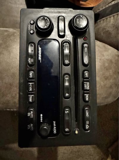

Love my factory Boss, "03 LT Tahoe, setup but cd player stopped working and of course the intermittent no power problem. How much to program replacement factory unit? Only dealer or can I do it myself? Or is this just going to happen again with a use unit? Thx

anything can happen over time but you can install the radio yourself easily, it will need to be vin unlocked. the dealer can do it in the service drive in about 5 minutes by getting a code off of the radio and then getting a decode number to enter into the radio.
there is also a "possible" phone number to call at gm which is automated, you can find it by googling, not sure if that still works or not.
in any case it's not hard to do

Sorry yes "Bose", single cd player with radio Find them on FB market place for under $100 all the time.
Love an upgrade but don't really want or need anything new I'm old school and like OEM. Thx
