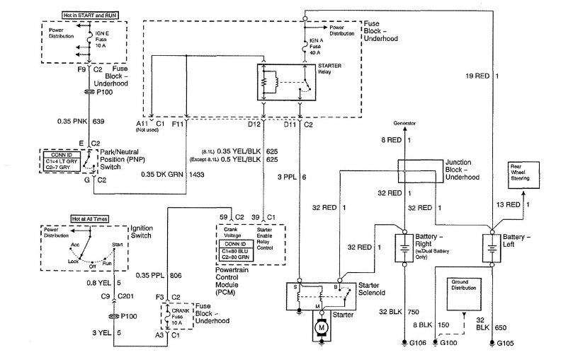

Hi!
After ride, when engine is hot, after 10-30 minuts i'm cant start the engine.
Diagnose - dont have signal from PCM to relay. (Out 39 in C1 blue).
If i ride with open hood or stay with open hood 30-40 minuts - starts okay.
I'll check all wiring, ignition switch is okay. Two fuse block are changed)
I have not confirmed trouble codes U1000, U1096, B2961 and U1255

What year and vehicle are you dealing with here. You will not get the output out of C1-39 if passlock is not satisfied or just faulty. And C1-39 gives a ground to the start relay coil NOT 12v+ so be mindful of that when sticking a voltmeter on it for troubleshooting.

I havent seen enough of the protocol that passlock uses so im not sure if it has to give a constant go ahead via BCM to the PCM or its a one and done once started and go ahead happens. Like the guy above said it wouldnt hurt to check battery cables over real good. Corrosion could cause this symptom as well. If it ends up being the passlock module you will be lucky since its an hour work to change out and cost like $30 for the part.
I would definitely reverify the 12v across the start relay when the fail to start happens. Stick red meter lead on battery positive and black lead on C1 39 or maybe even rig a wire up on start relay socket connection that leads to D12 on the schematic to rule out everything in between D12 and C1 39. Remember this start relay is GROUND seeking. Not 12V positive seeking.

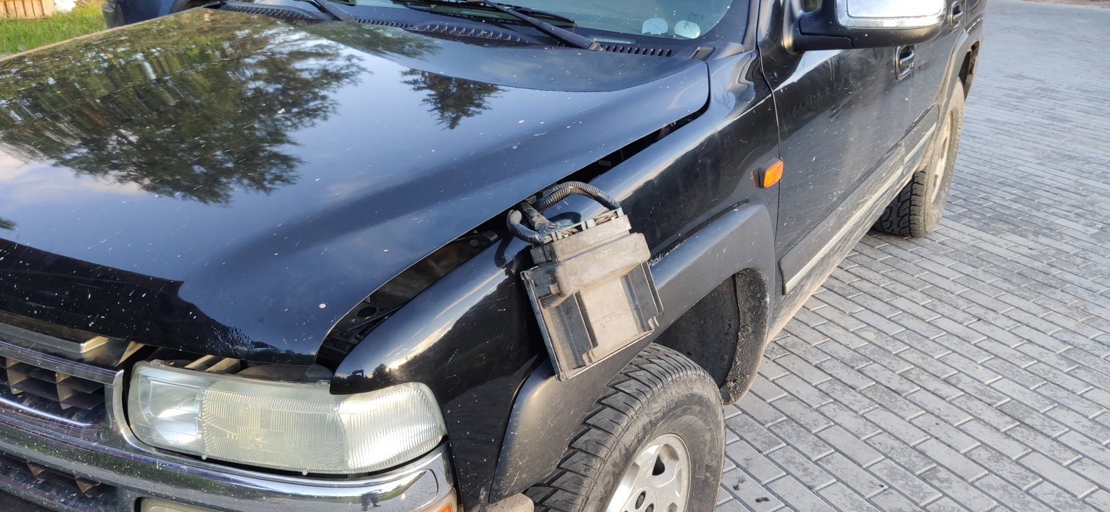

Took the pcm from nest, and placed it near fuse box. When its cold - its okay, when its hot - its not okay. Take a ride, open hood, sthrow it on fender, 3 min and we ready to go again!)
Friend says i'm need a new PCM with the arabic proramm, to disable pk3!)

That sounds like your output transistor in your PCM is electrically opening up when it gets hot. Not very common but not impossible., Ive seen a transistor open when hot and even short when hot then "heal" itself when cooled down. Usually they eventually fail totally open or shorted in due time though. I would grab a PCM off ebay or car-part.com that matches your PCM part# and swap out and see if problem goes away. This problem if in the PCM will be hard to prove without knowing what all permissions are needed to get that output transistor to give a ground to the start relay and be able to monitor them all to see if they are there.

Yes, I came to the same conclusion. It is difficult to understand which of the transistors is open the output. Its 6 pcs in board. And I can't find "ior336a" in local stores.
It can also be a track inside the board.
I'll buy another PCM one of these days and take a look.
Maybe wherever there are any explanations about of the PCM.
