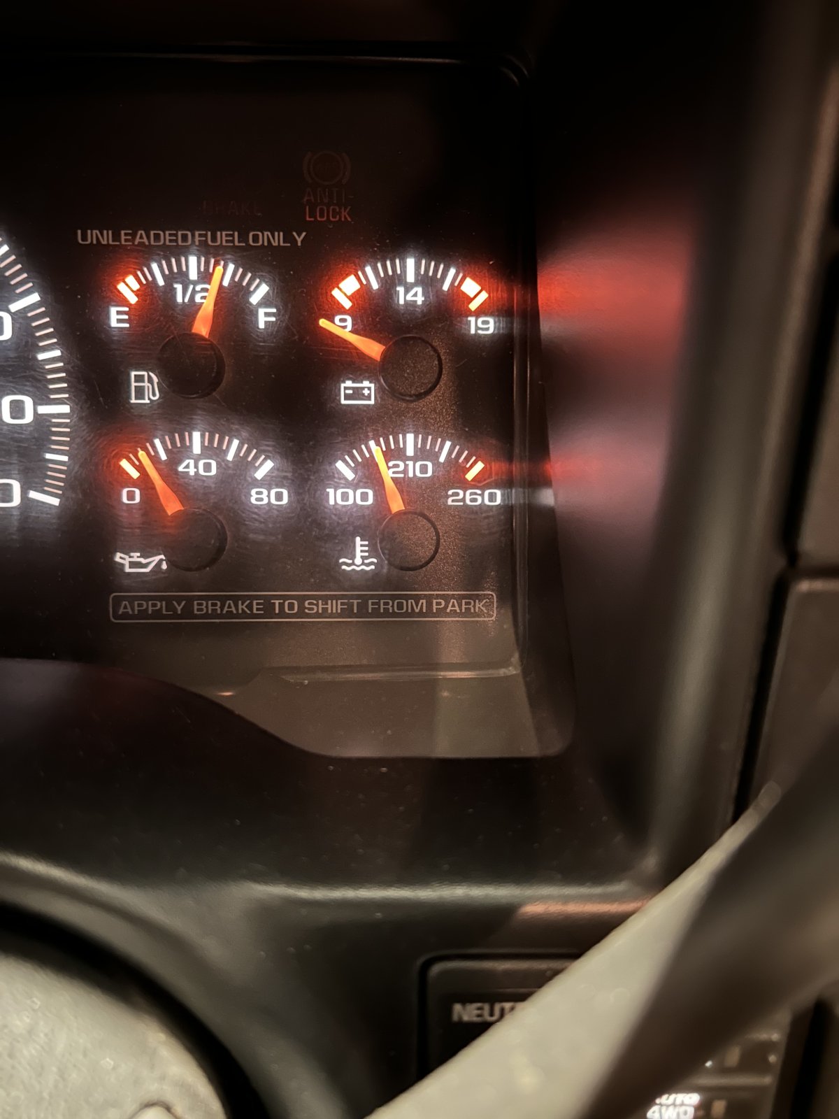

First, the temperature gauge in my instrument cluster is reading around 155° Fahrenheit after the truck reaches operating temperature (see attached photo). Usually, it reads around 173° when it reaches normal operating temperature. I did just get my truck back from my mechanic a few weeks ago. It was there to have an oil leak fixed, but they also replaced the thermostat while they had it. I called them today to make sure that they put in the correct thermostat and they confirmed that the one they put in starts to open at 195°.

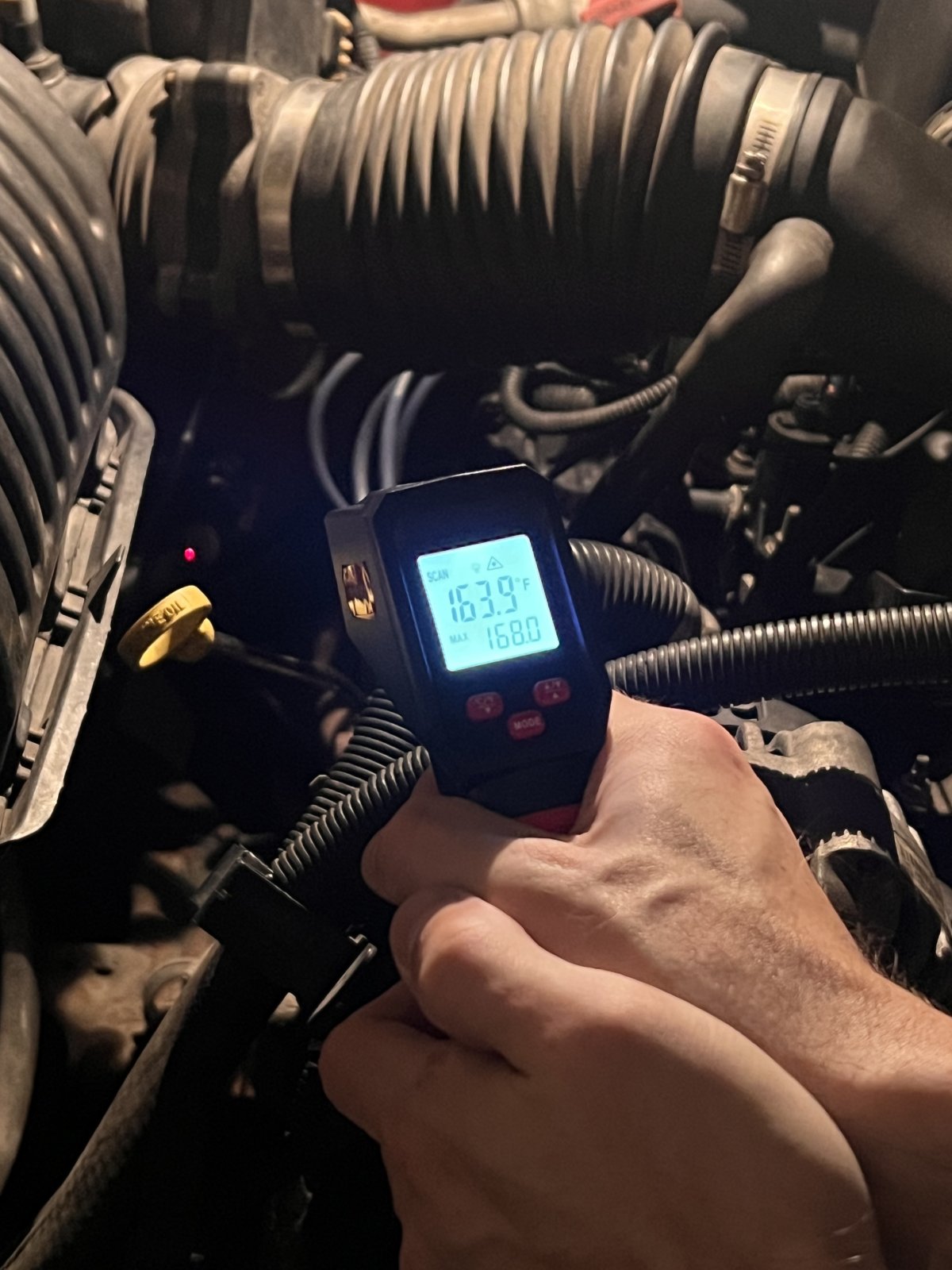

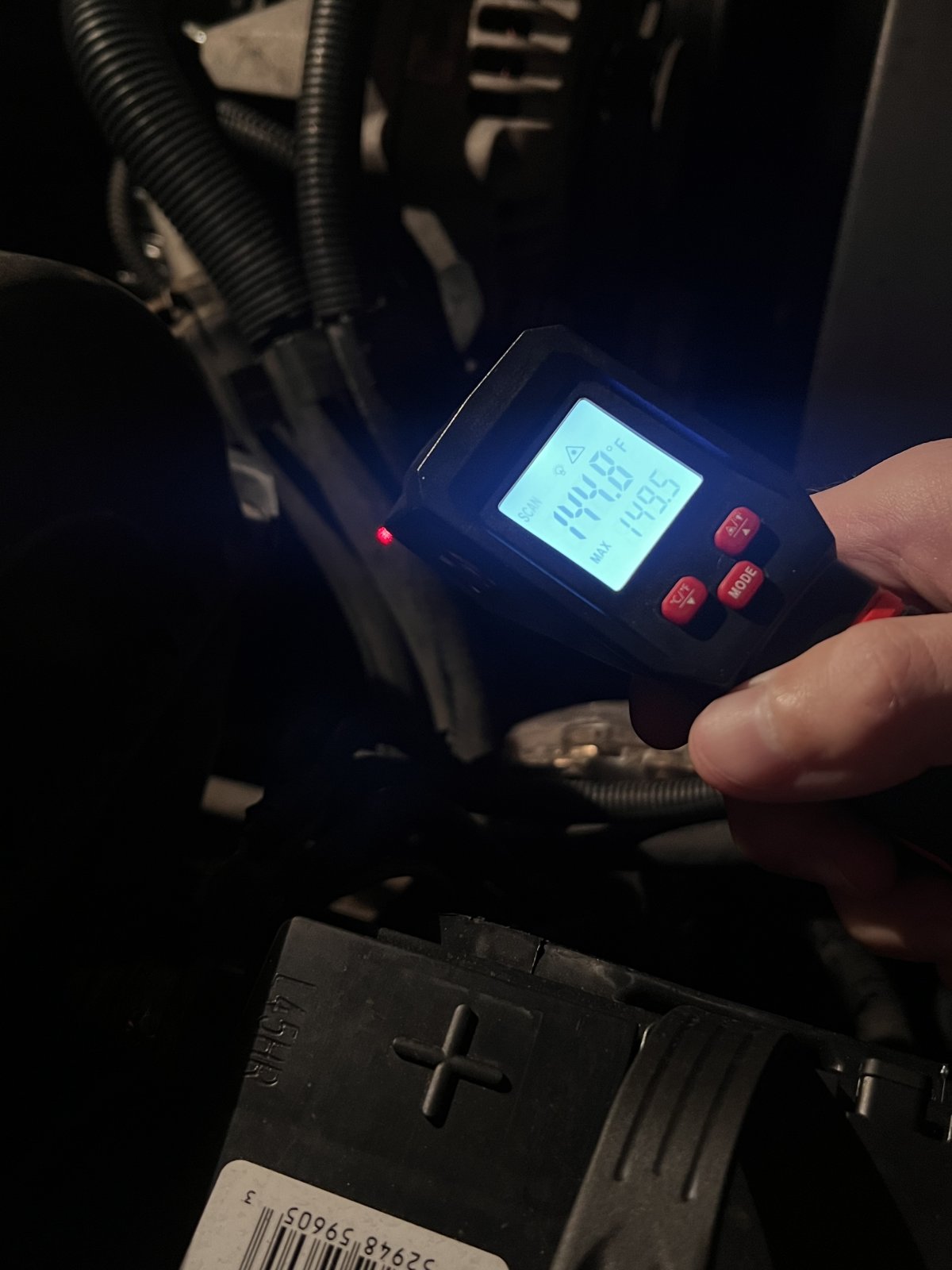

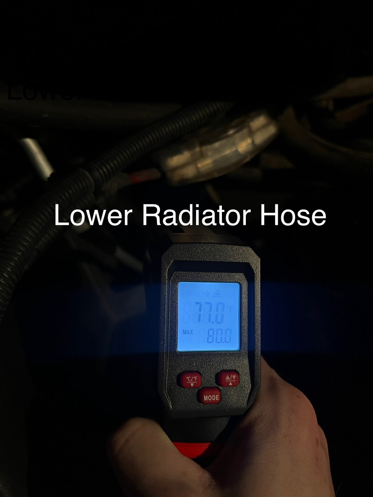

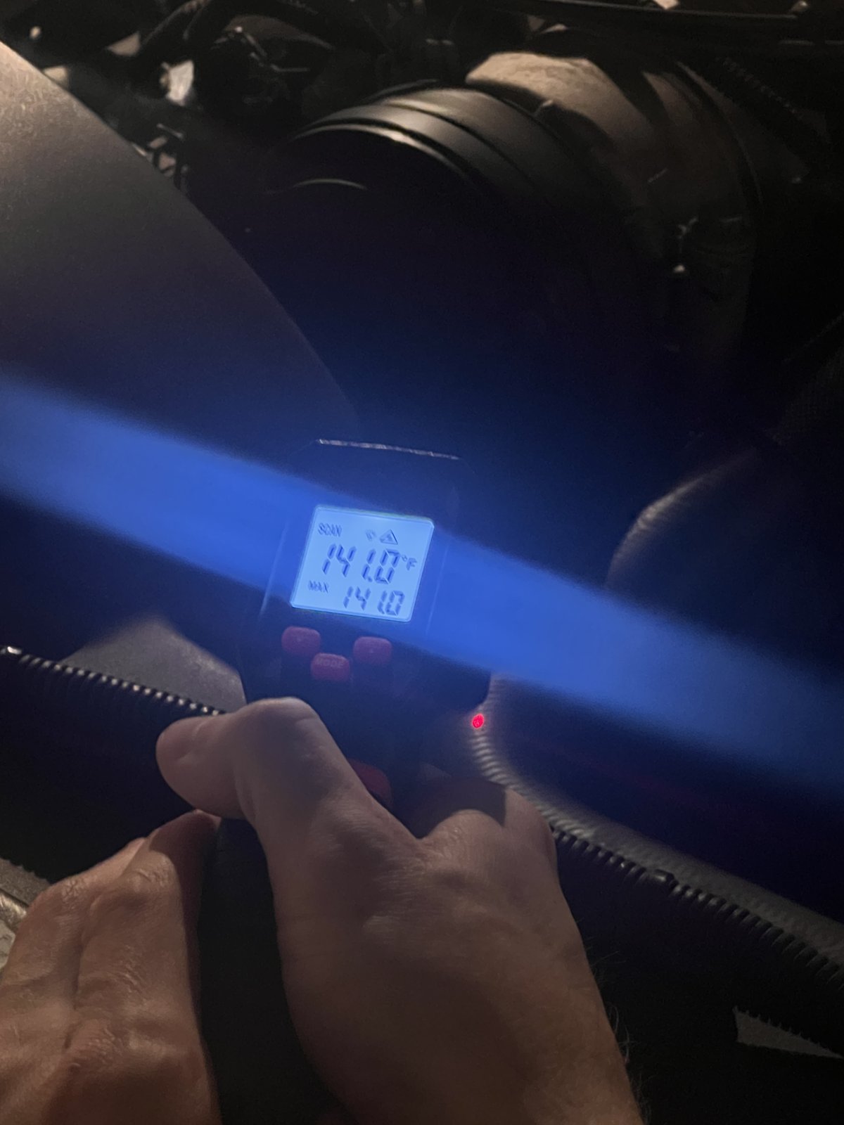

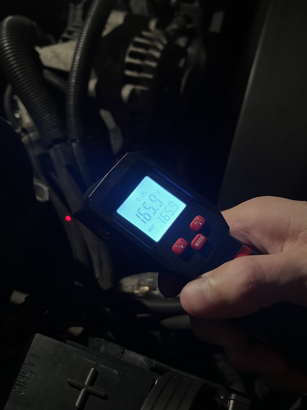

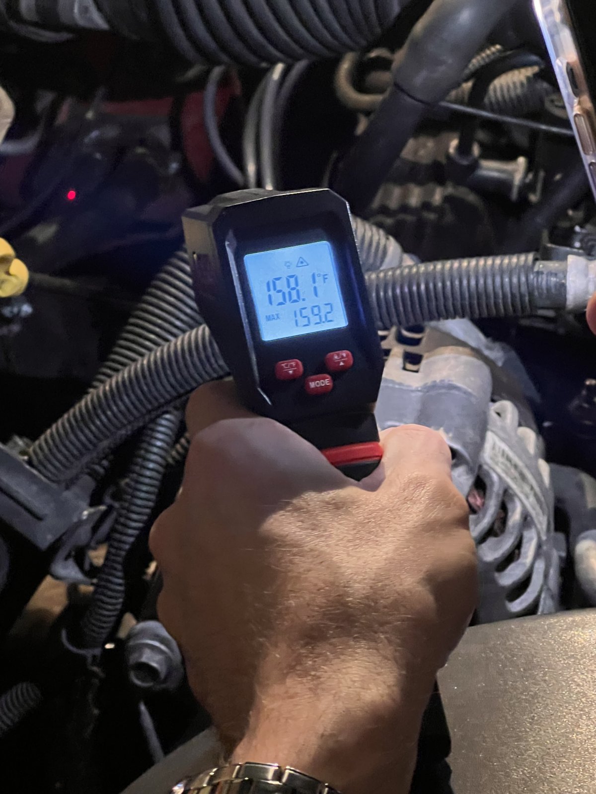

Instead, I used an infrared thermometer to measure the temp of the radiator and heater hoses once my truck reached operating temp. I’m attaching photos of those readings below, but all of the hoses except for the lower radiator hose were between 141°–165° which seems to confirm what the temp gauge in my instrument cluster is indicating.

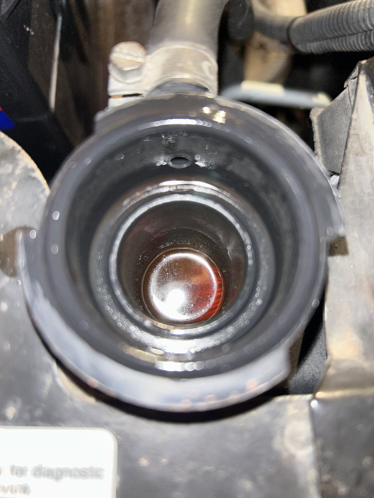

I also checked on the amount of coolant in the radiator after the engine was cool and it was very close to the top (photo attached). I went ahead and tried to burp the system, but I didn’t see any air bubbles come out and the amount of coolant never lowered. However, it did rise almost instantly after turning the truck on to the point that it reached the small hole in the radiator neck and started flowing to the reservoir.
