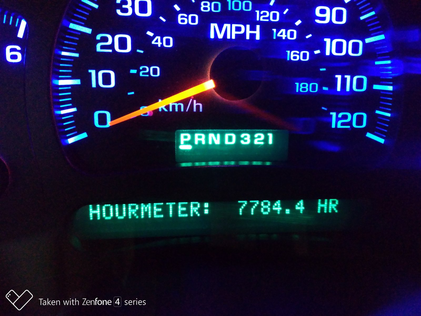

It's with near certainty that your engine hour meter was reset involuntarily. They often reset to zero when the battery fails or of course when the cluster is replaced. My truck's average speed is 27 mph, some time ago a bunch chimed in and the average was about 30.

That information is stored in the cluster. Sometimes the cluster freaks out and it can reset and a replacement cluster can sometimes have the hours reset or programmed to match the old cluster depending on where the cluster was sourced and who installed it.
