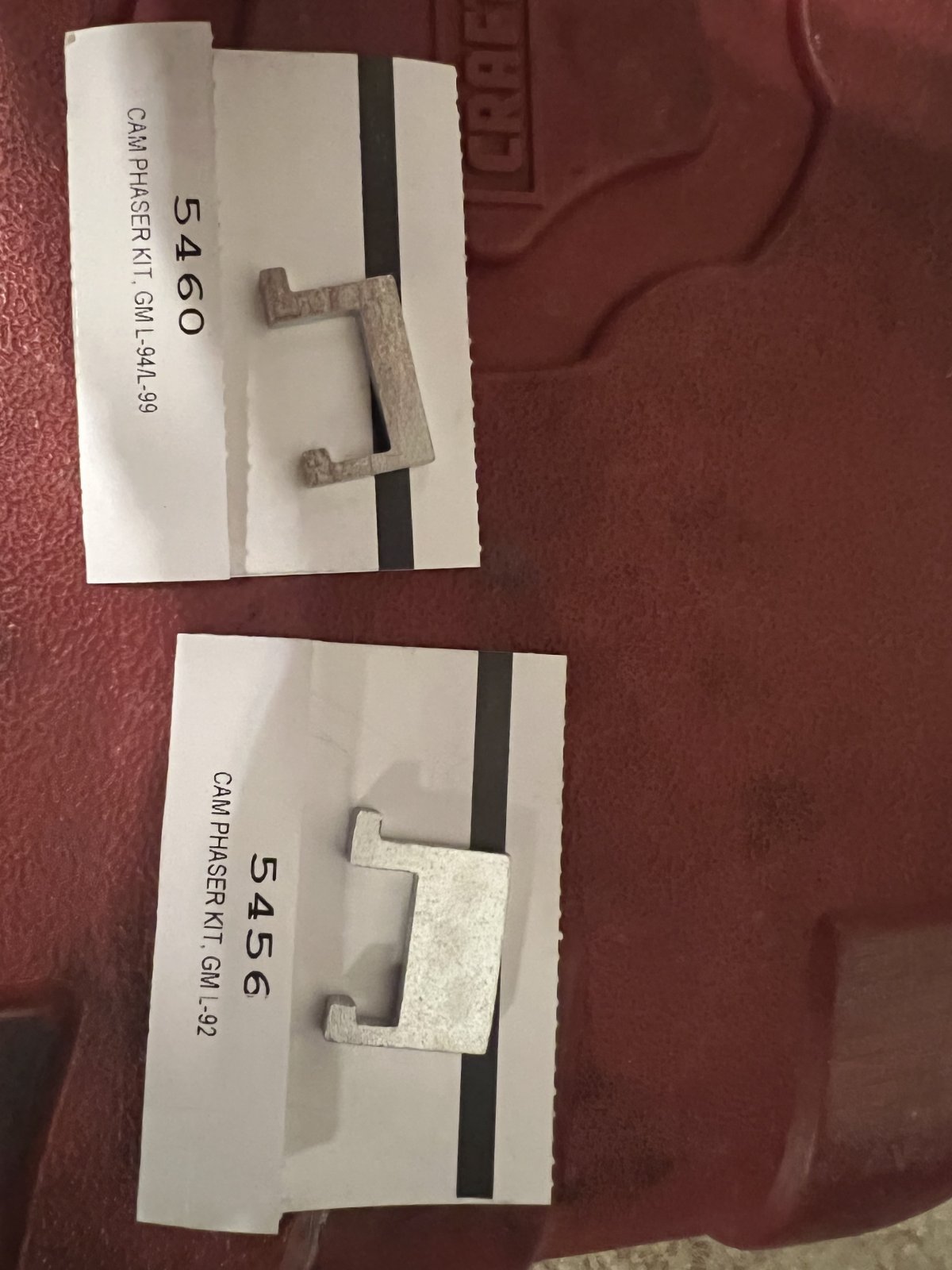

So I still didn’t have any luck with the lock tool in the 5456 kit and after convincing TSP to send me the 5460 I can now say the cam phaser is complete.
If you look at the picture you might be able to tell the difference between the two lol. The phaser block appeared to be exactly the same.
Hurray!! Guess I will order the 5460 from now on if it's easier. Now just make sure that you get that dowl located properly!! Pull it off and on 30 times if needed to make sure, it has bitten many people that got penisy. Lol
Sorry for my ignorance but what dowl are you talking about?
The dowel on the camshaft that goes into the vvt assembly. It's easy to just barely miss it and you don't know it because you can't see it.
Oh yea duh I know what your talking about now. I will check 1000 times and then one more for good measure.
