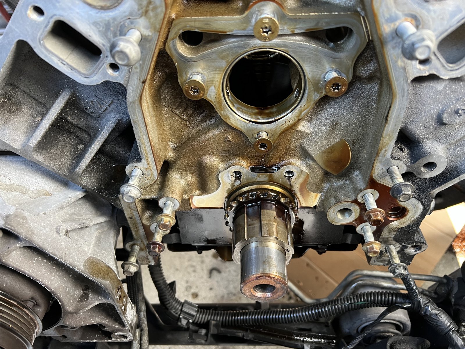

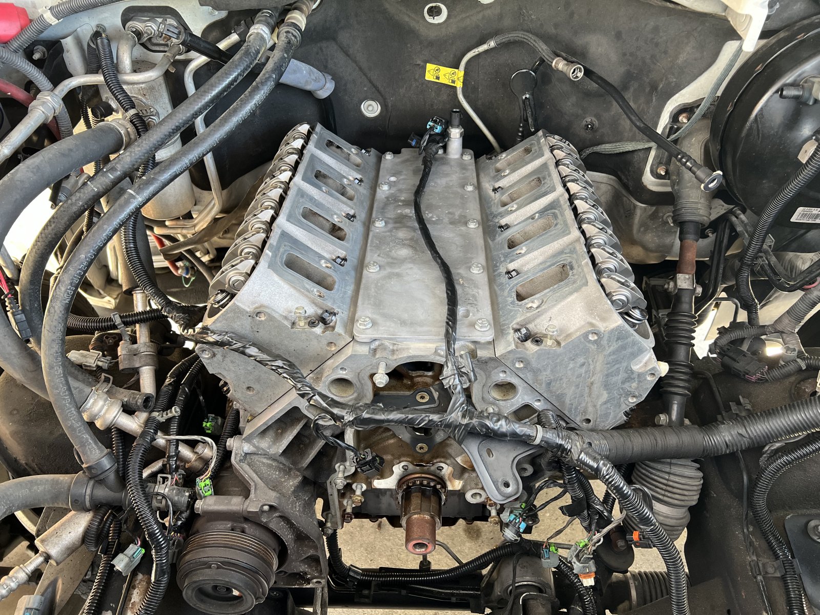

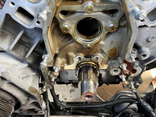

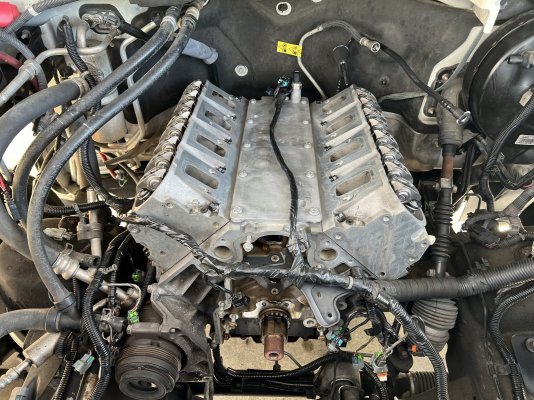

I haven’t started it yet. Between working 13hr days, my wife’s birthday, decorating the house for Christmas I only get half of Sunday to work on it. But today I finally got everything ripped apart 100% and I will clean the heads tomorrow after work.
I found a shop local in Sarasota Skip’s Automotive that will Dyno tune it. They’ve done Sierra’s and Corvettes
Progress

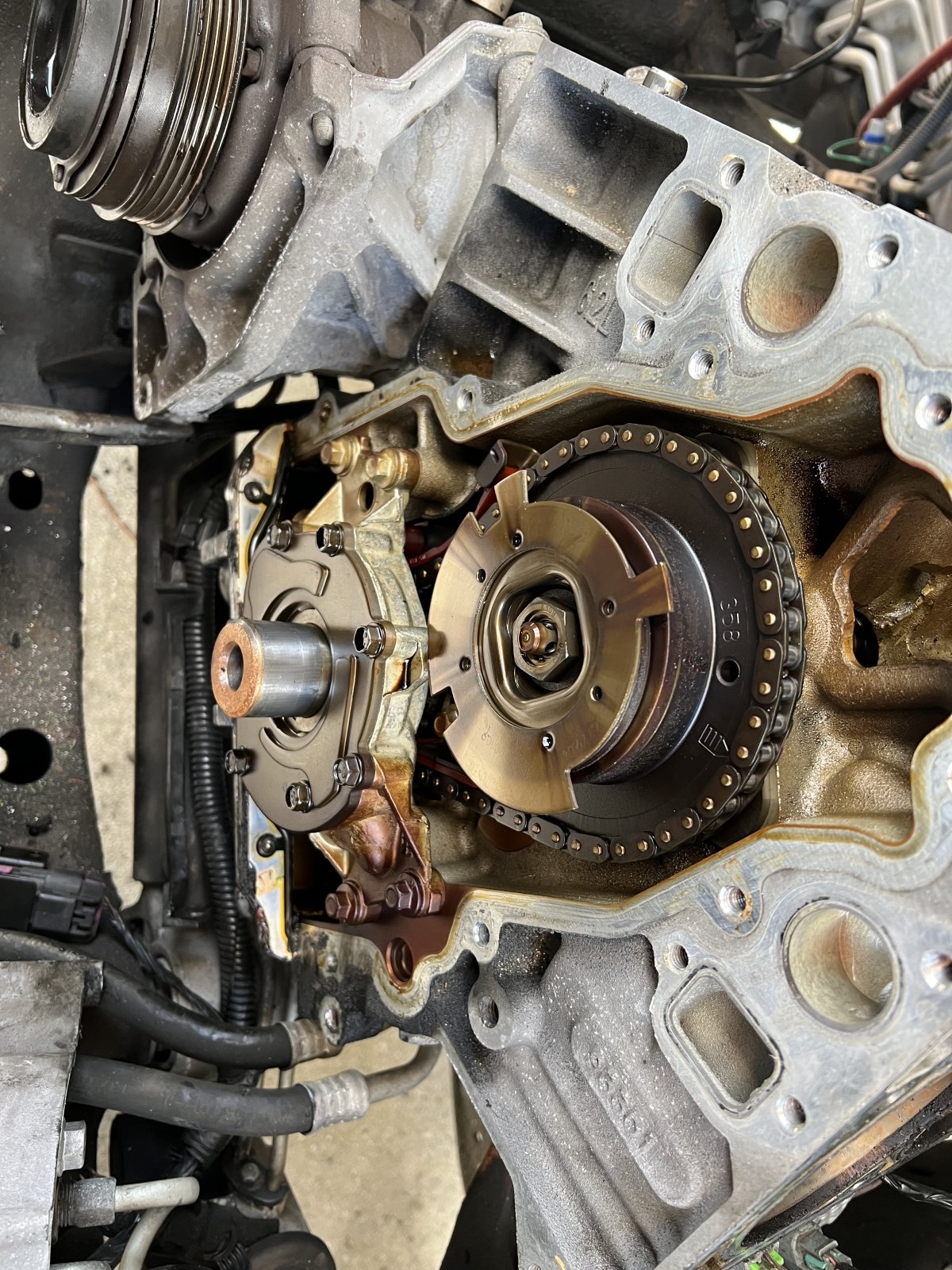

Can anyone with a 6.2L L94 answer this question?
I’m finally able to get around to working on the install of the Delete. When I placed the order with Texas speed I had some questions for them in regards to the engine codes the website was saying. It kept referring to the L92 and I have a L94 they assured me everything will work. Ok cool I ordered everything and found out they didn’t ship my valley cover, called them up and they shipped it right out but while I was on the phone with them they told me I was sent the wrong CAM Phaser they sent me one for a LT4 5450, they sent me a new one and it’s for a L92 5456.
So I’ve been trying for the past hour to get the spring lock to stay in place and it keeps popping out. So after some research of my own I found a part number for the L94 5460.
So questions are:
Will the L92 CAM Phaser work?
Is the cam for an L92 going to work in an L94?
I wouldn’t have questioned it but the whole CAM Phaser thing makes me think everything is incorrect

The l94 is just a l92 with flex fuel injectors and fuel pump, as well as displacement on demand. Once you delete the dod, it will turn into an l9h which is a flex fuel version of the l92.
Oh, and you are using the wrong CAM Phaser limiter, the 5456 is for the early model Phaser, you have the laster model Phaser, so the second part number is the one you want. It isn't am l92vs l94 thing, it's a year of engine thing. 2010 and up use the later model Phaser, and thus, the later model limiter you correctly identified you indeed need

Thank you for clarify that. Well this sucks lol I don’t have much personal time to do projects like this and because of a mistake that TSP made I can’t finish putting this together.
