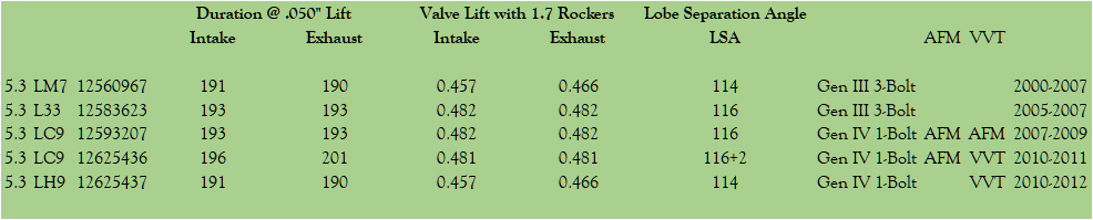

Sorry I meant a LM7 cam from TSP so I can keep VVT
I guess those guys bought a lot of those camshafts and that's why they keep peddling them. An LM7 camshaft is SMALLER then your stock cam and they never had provisions for VVT.
So, if your engine has VVT, the original camshaft is 12625436 and as you can see from the specs, it's quite different than the old LM7/L59 Gen III camshafts. If the replacement they sent you does indeed share those LM7 specs and has provisions for VVT, it should be the 12625437 LH9 camshaft.
When the earlier 5.3 LMG/LY5/LC9 motors do an AFM delete, we use the L33 camshaft as it has the exact same specs as our original sans AFM. We did not have VVT in these earlier motors. There is no exact equivalent for yours. You might consider an L9H 6.2 cam 12623065 or a BTR Truck Torque cam which is a single pattern grind but don't remember if it is VVT compatible or not.

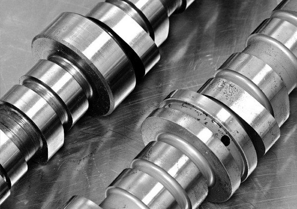

The cam will physically bolt up but if there is not a groove and hole cut into the 2nd cam journal, VVT is not going to work as it will be starved of oil.
Sadly, most cams are not designed to work with VVT. I reckon it requires much R&D time and folks just aren't willing to pay for it compared to what it ultimately delivers.
Worse, he's going to lose horsepower with that cam VVT or no VVT.
