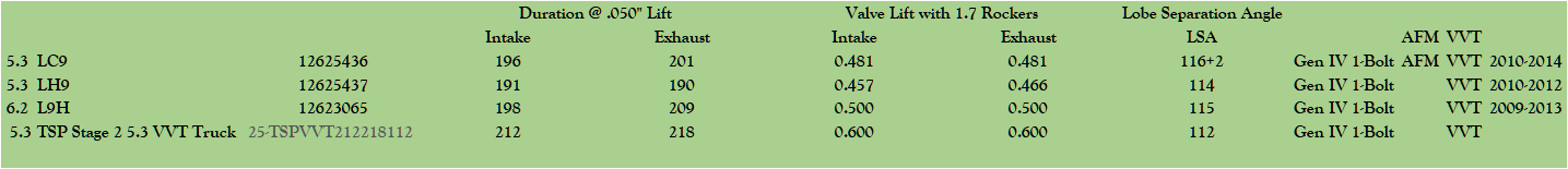

Well here they are, which is closest to your original while still keeping VVT? Another thing, you'll only gain about 5-7 horsepower by increasing the lift over .500 with stock 243 heads, hardly worth the strain on the valvetrain IMO.

Chris, what do you think his best cam choice would be if he wants to stay as close to "stock" as possible? If he didn't want to keep VVT I'd recommend the L33 camshaft myself but you know more about this than I do.
45,011
Close to stock but without AFM? L9H cam.
Close to stock as possible but without AFM and VVT? LQ9 cam.
My choice would be to keep VVT and go with the L9H cam.

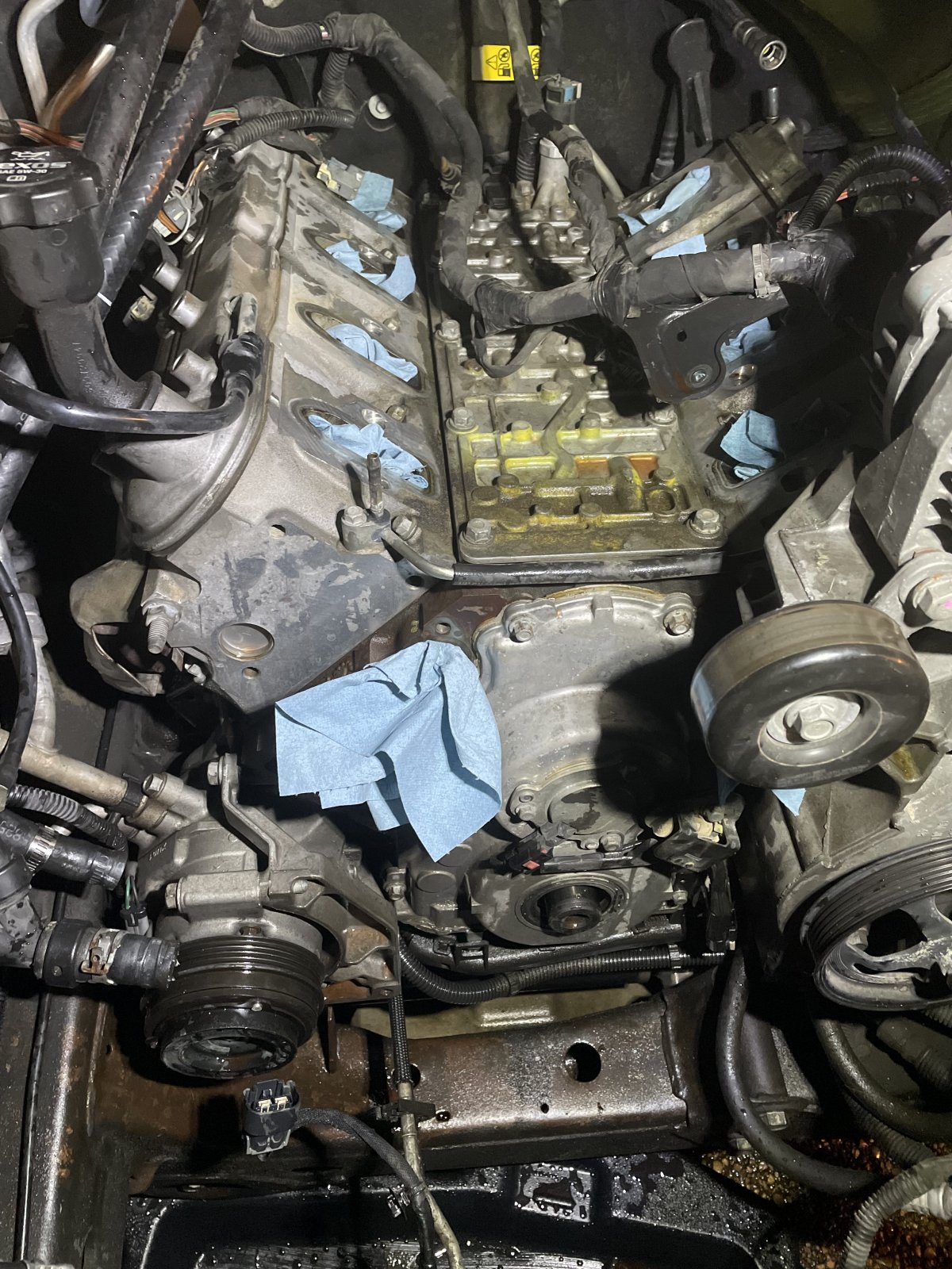

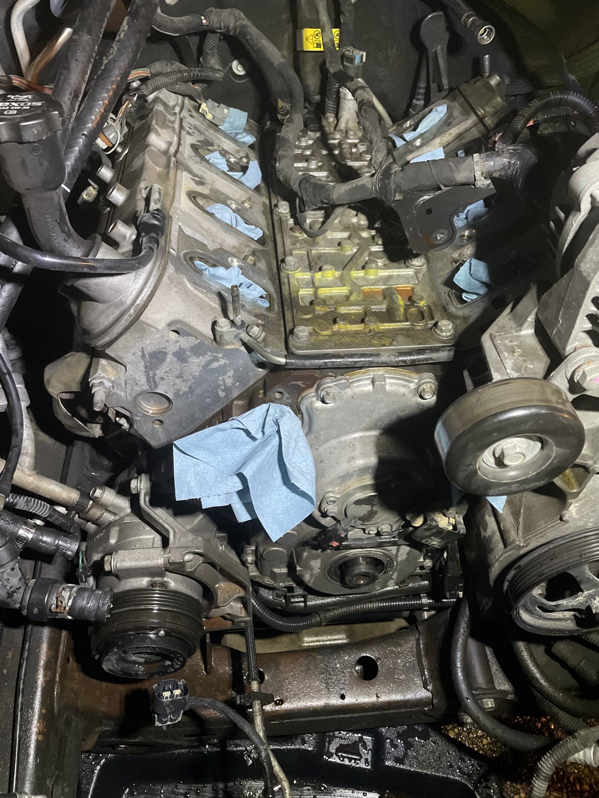

Started the tear down yesterday, got the intake manifold off, coil packs off, water pump off, harmonic balancer off, most of the exhaust manifold bolts out (left the two behind the dip stick cause I haven’t pulled it yet), and the fans and radiator. I’m gonna try and pull the the heads tomorrow if the weather permits. But here’s the progress so far
Oh and I was able to diagnose the problem as being the cylinder #1 exhaust valve lifter. It’s either collapsed or could possibly be turned in the tray. I think it might be turned because as crazy as it sounds, I could hear a cracking plasticy sound when I had it running yesterday.

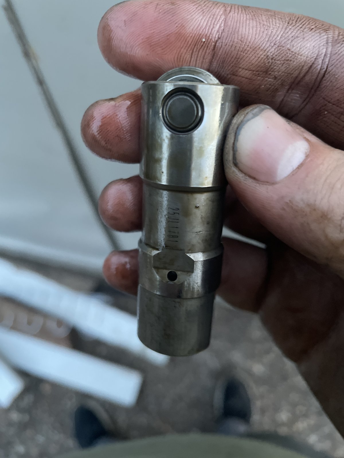

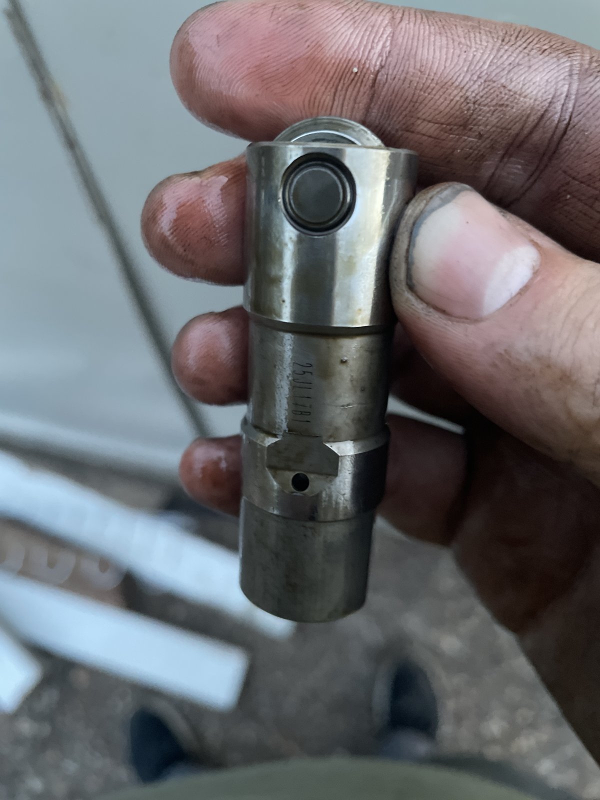

Ok got the driver side head off and found that the cylinder #1 exhaust lifter had been spinning in the tray and the roller is pretty torn up. I’m guessing the cam looks about the same. Only thing I’m curious about is what orientation the no dod rollers when I go to re assemble. I see the little oil ports on the side of them but is there a specific direction they need to be pointing?

Ok got the driver side head off and found that the cylinder #1 exhaust lifter had been spinning in the tray and the roller is pretty torn up. I’m guessing the cam looks about the same. Only thing I’m curious about is what orientation the no dod rollers when I go to re assemble. I see the little oil ports on the side of them but is there a specific direction they need to be pointing? View attachment 345180
It doesn’t matter. I installed all of mine with the oil port facing up but it truly doesn’t matter. Whatever you do though, use new OEM lifter trays only.
