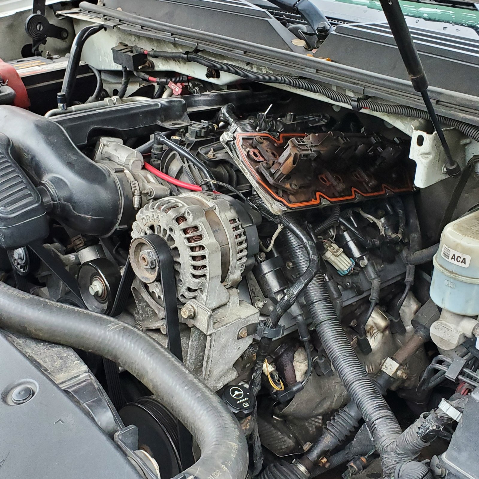

After dod delete driveablity is horrible without a tune(shifts hard, 4cyl limp mode, stumble, etc) plug in the old vlom to get by
