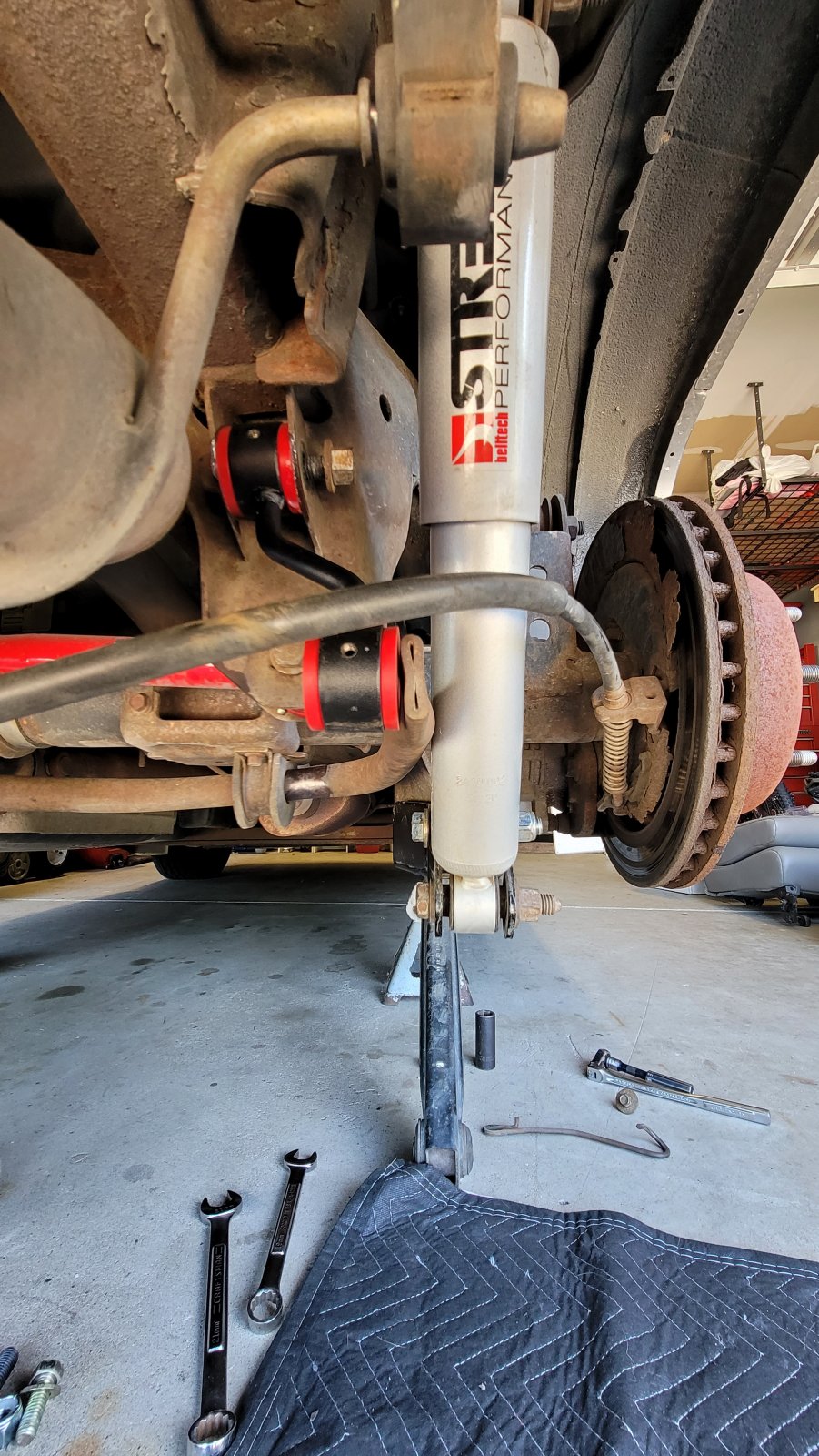

I'm working on installing the DJM kit and nothing seems to be lining up. The sway bar won't move over far enough to bolt onto the link before it hits the shock.

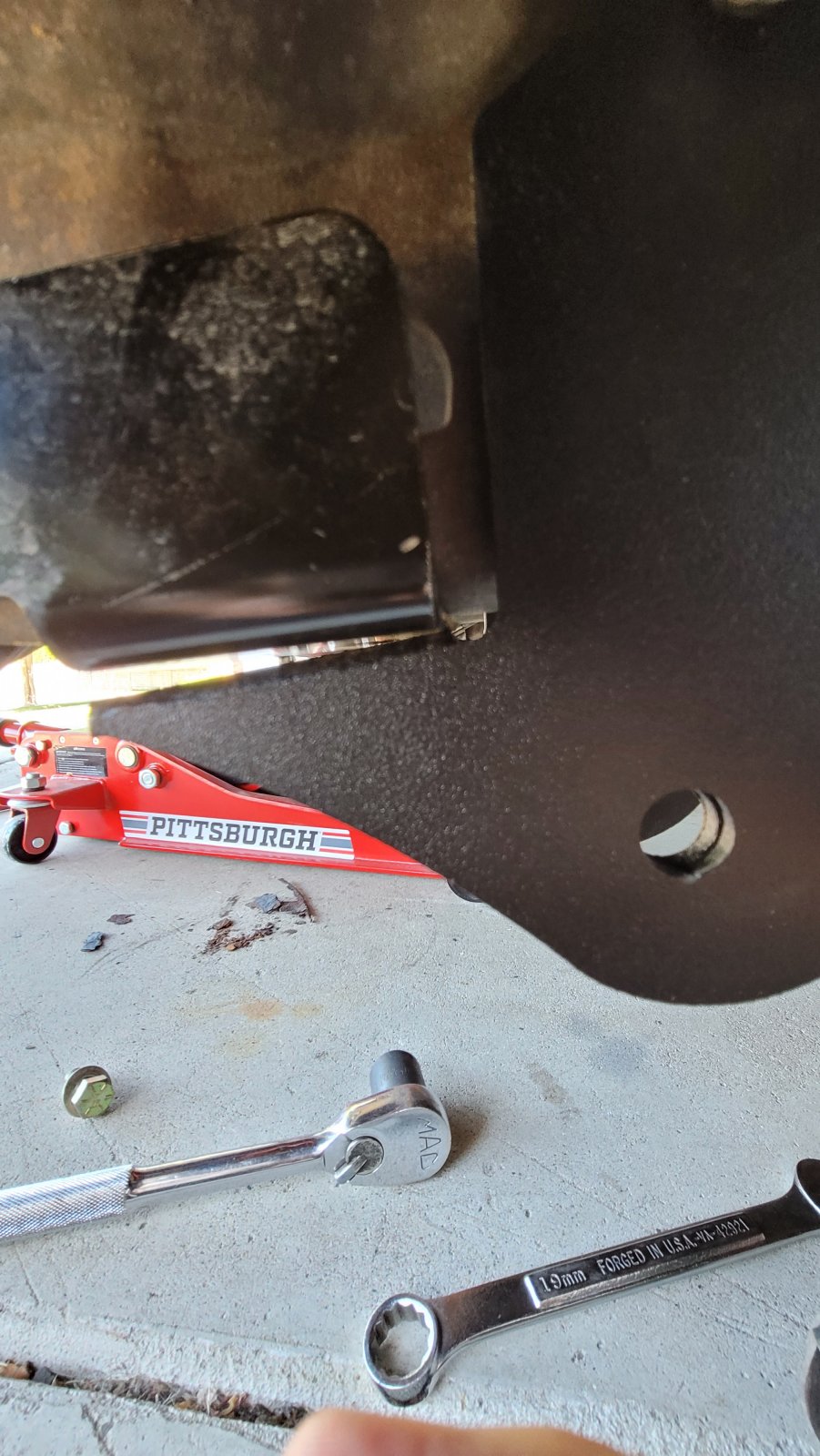

The lower control arm relocation bracket won't sit flush, this I assume because their kit may not work with the Belltech shock relocation bracket?

Just guesses here:
Are you sure you have the offset links on their correct sides?
I think you need the DJM style of shock extender to run the LCA relocators.
Also, is your axle centered? I see you have an adjustable panhard bar. Make sure your axle isn't too far to the left.

The pass side of the bar won't even move far enough to bolt onto the link. The driver side hasn't been bolted on yet, so nothing to cause an issue.
Yes the axle is centered.
I'll check about the shock extenders.

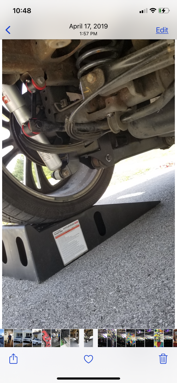

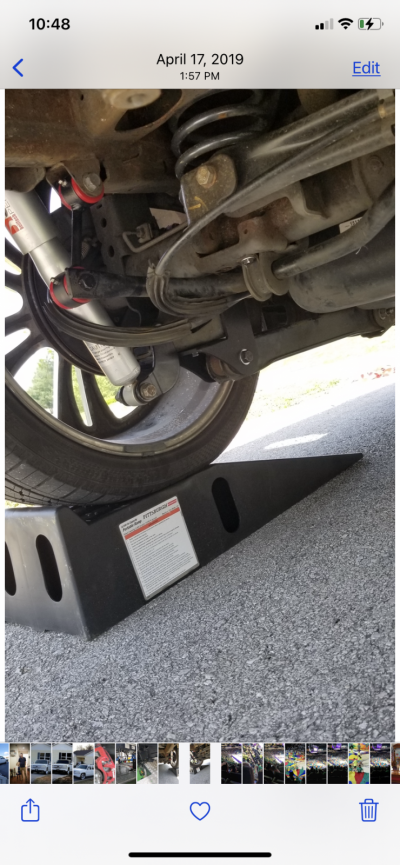

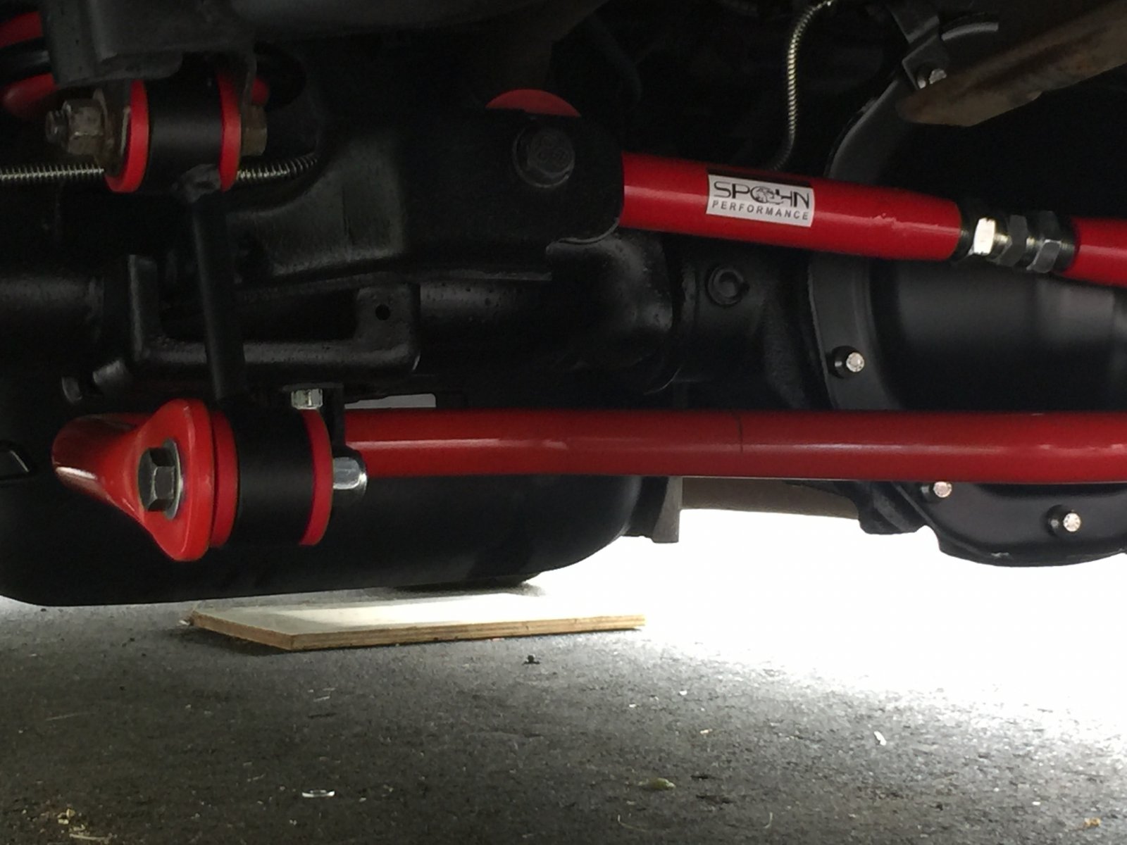

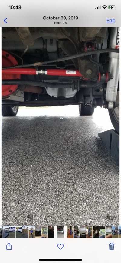

Here is a pic of mine. Hope this helps Also the relocation bracket for the lower control arm WILL NOT work with belltech shock extension or any made that way. I’ve lowered bout 6 of these Tahoe’s including mine an they do not fit. Have to use mcgaughys shock extenders as u can look up an see how different they are.
It also looks like your offset end link (passenger side) has the bar welded to the center of the bushed ends whereas the OP's upper bushed end is off center.

I would not recommend sticking the belltech shock relocation brackets between the DJM trailering arm relocator bracket.
You will need DJM or mcgaughys style shock relocation brackets if you dont plan to get the proper length drop shocks.

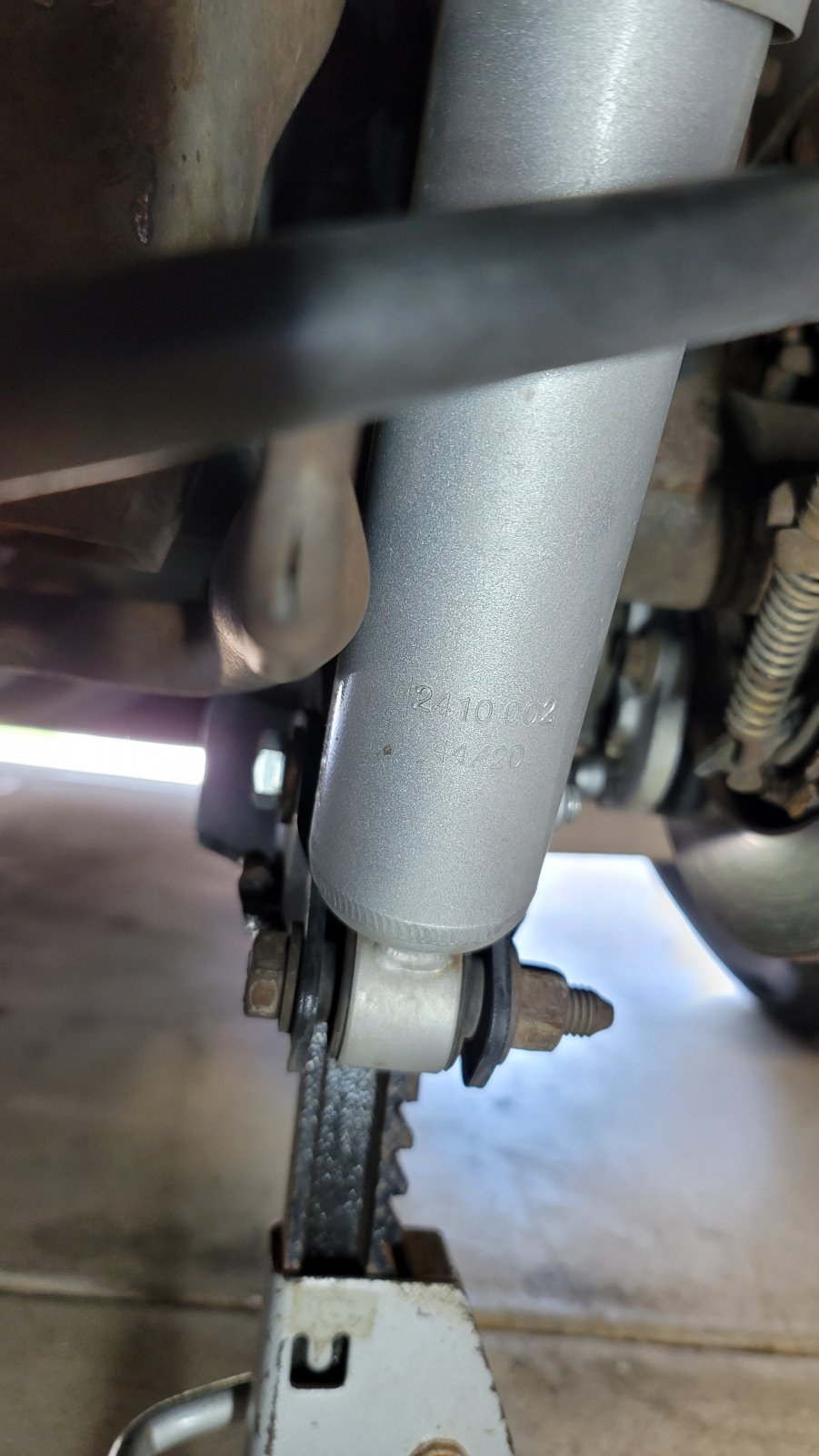

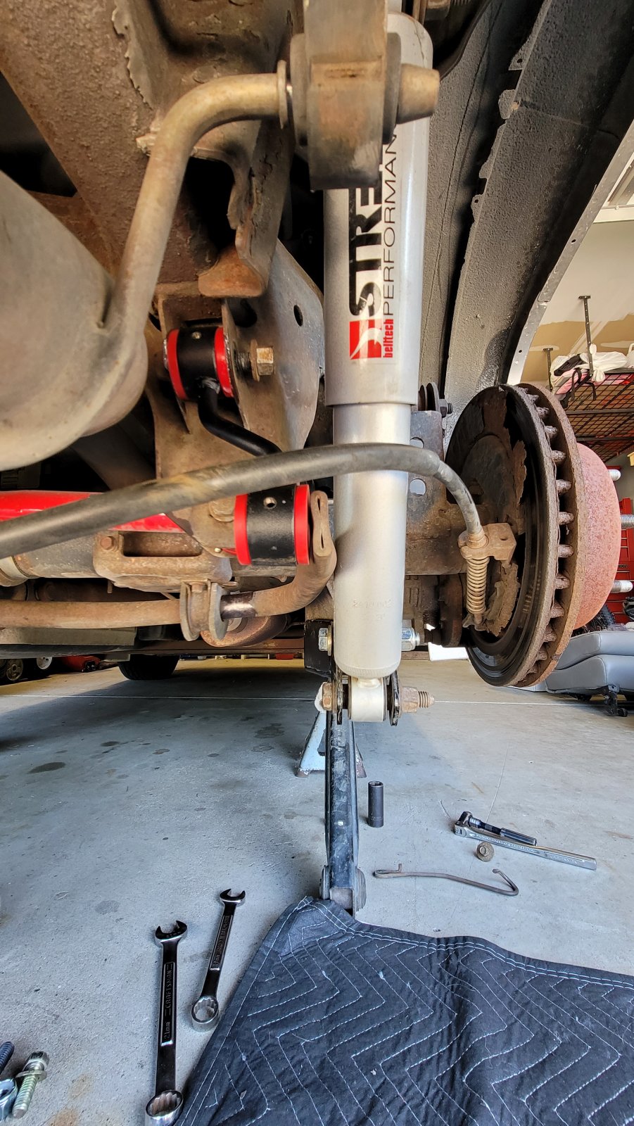

OK, slow to follow up on this. I talked to DJM and they basically said the link looks fine. So, I tried reinstalling. Lifted the rear of the vehicle, axle sitting at ride height. Shifted the bar over to the new mounting spot on the driver side. Installed the driver side link and it shoved the sway bar right into the shock on the pass side. I can't even get the bar lifted up far enough to bolt up to the pass side link. I sent DJM pics again, waiting for a reply.

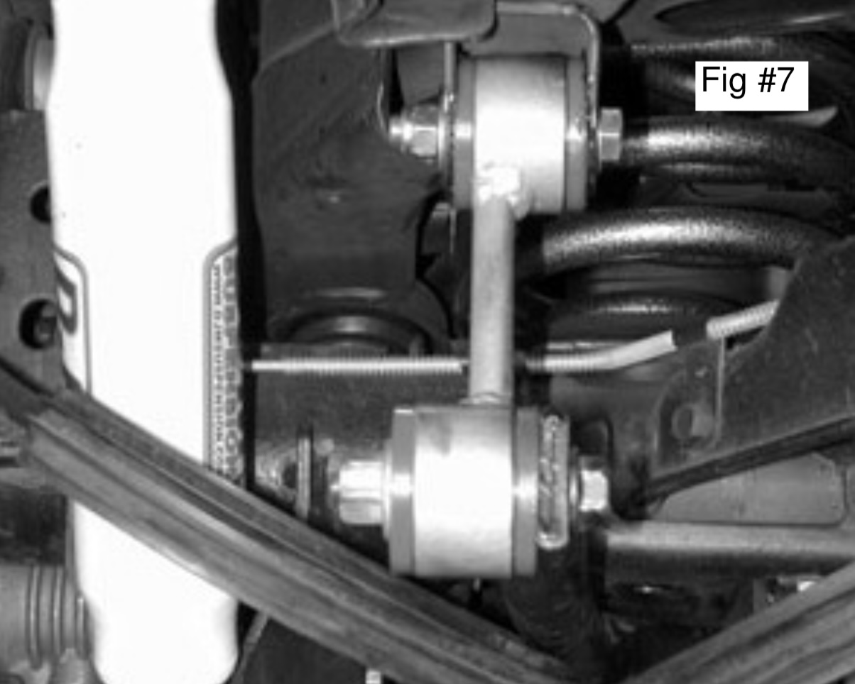

Have a pic looking up at the drivers side alignment similar to their instructions?
ks03
Fool Excess Member
May 3, 2019
307
299
View attachment 247612 So i ended up 180 on the driver side and left the passenger side the way it was. It was the only way I could fit the link inside the sway bar. The instructions show a picture with the bar on the inside but mention to bolt it to the outside. My axle is centered and there is no contact at all so I’m happy.
looks like you’re not the first, and the directions maybe wrong, sounds like flipping the driver side link to switch the direction of the off set, and mounting the bar to the outer side worked for that guy
wording from the instructions are
Apply some grease to the bushing and bolt the driver side end link to the factory upper mount using factory hardware. The lower end is offset to the passenger side. Bolt the sway bar to the outside of the end link using 1/2” x 2-3/4” bolts (Fig # 7).
Which is opposite the picture in the instructions, but how it is in the first attachment in this post

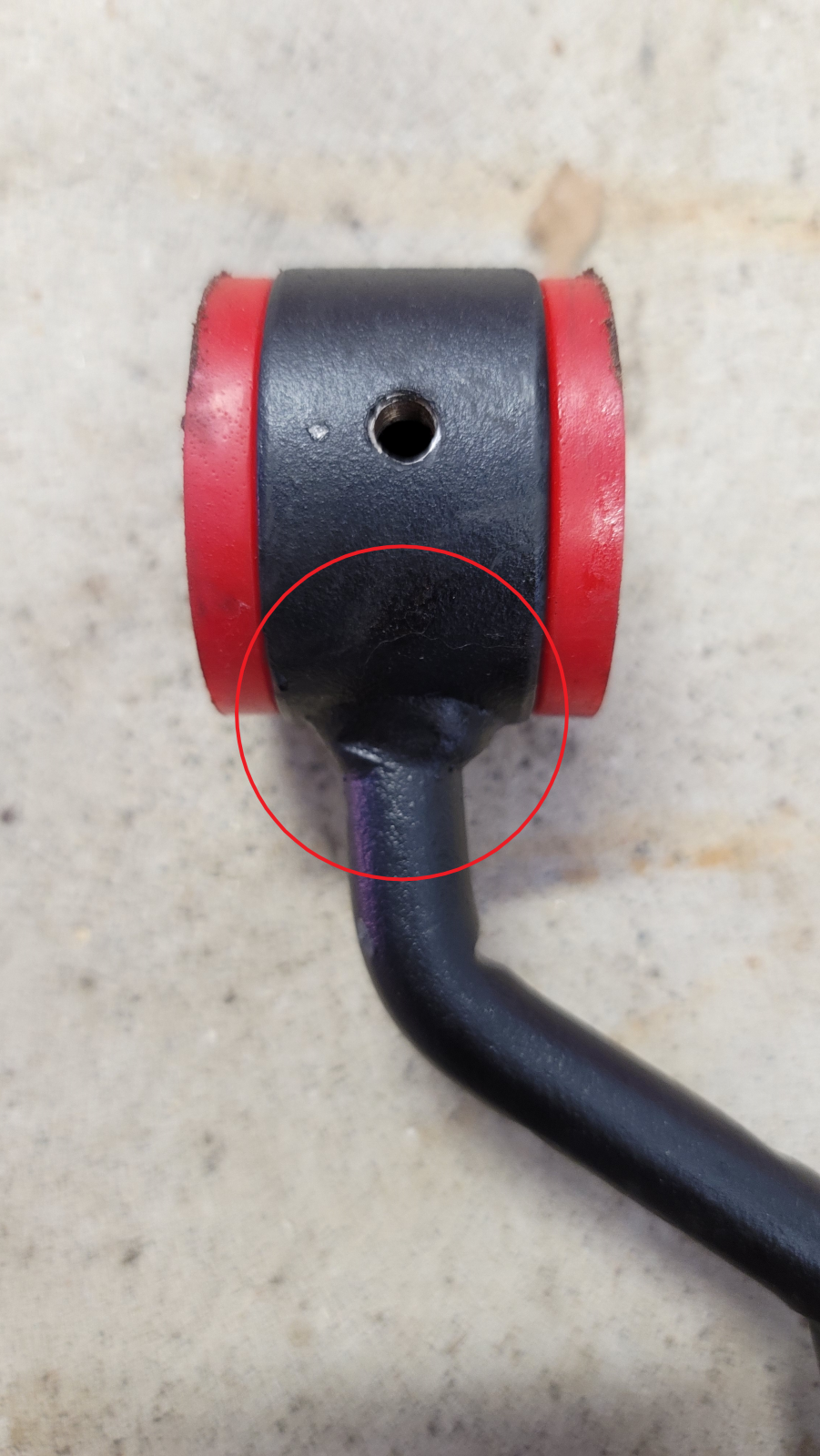

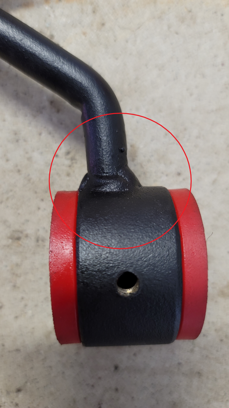

OK, after getting back under there, flipping the driver side won't matter since I think the passenger side link is still welded wrong. The passenger side link will still be in the same position, unless I put serious tension on the sway bar, which will end up snapping an end link. The passenger side end link is pushing the sway bar out too far, causing it to interfere with the shock. If the welds were both centered on the end link, it would pull the mount point for the sway bar away from the shock.
