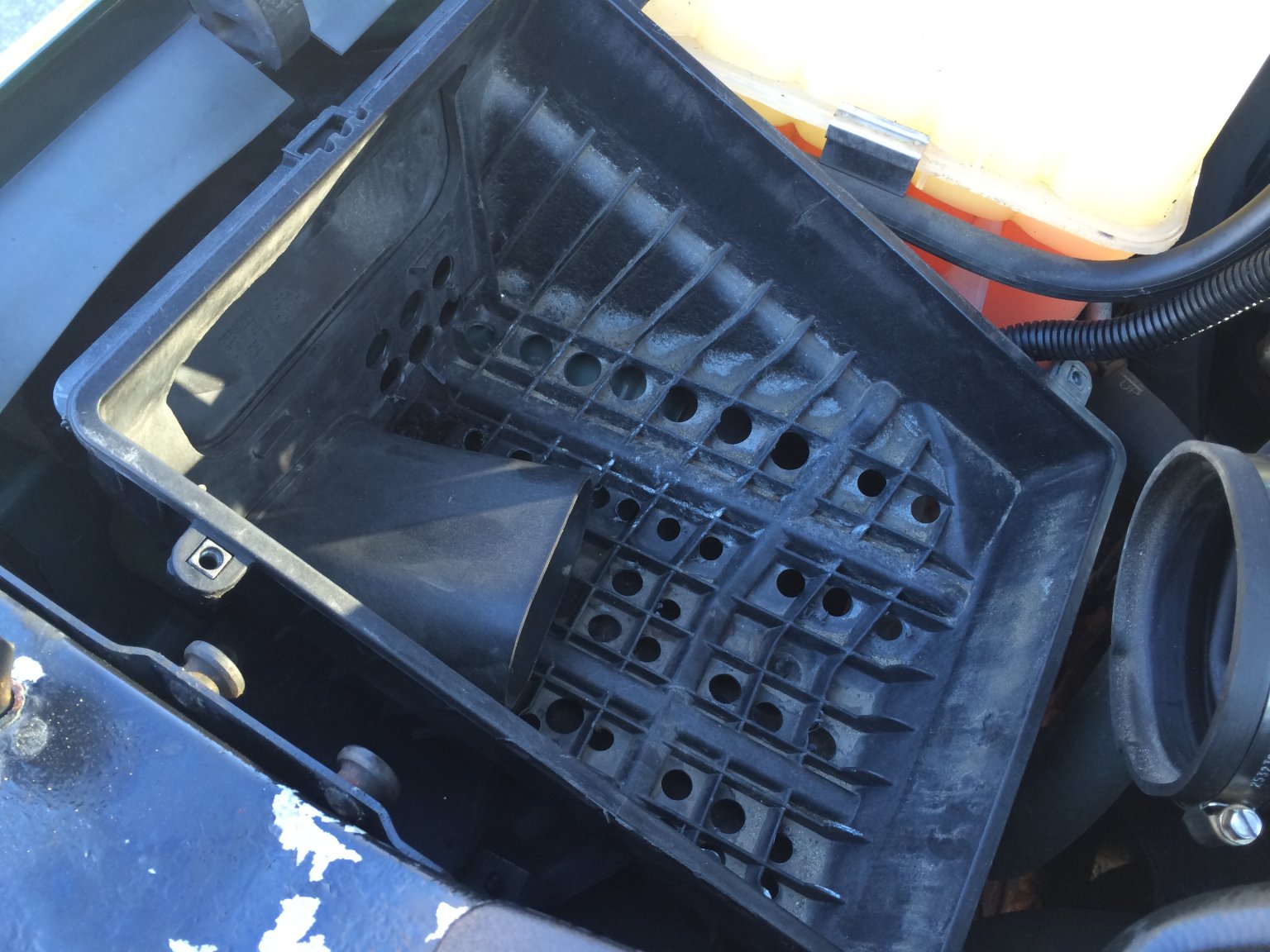

Then skip it. Or at the minimum, get another oem box to chop up for street use and use the non modded for playing offroad.
Just had that thought myself. It takes like 30 seconds to swap out the box. I could chop one up and then when Im gonna hit the trails just throw on the unmodified box. 30 seconds of labor and far less risk.
That sounds like a good idea. I'm sure you can get one for almost nothing.

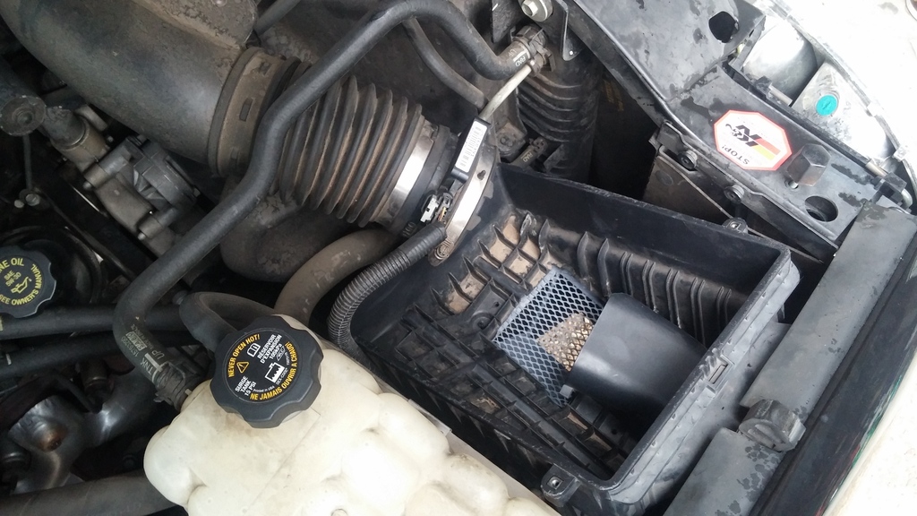

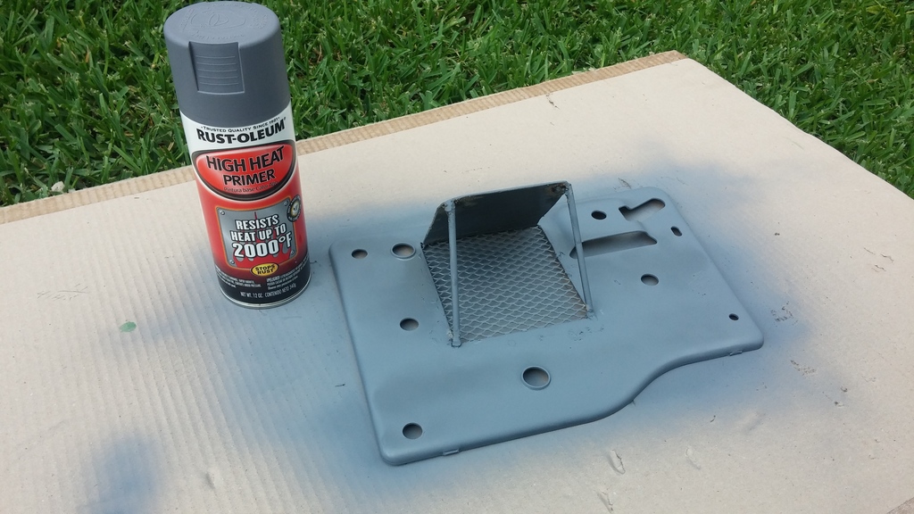

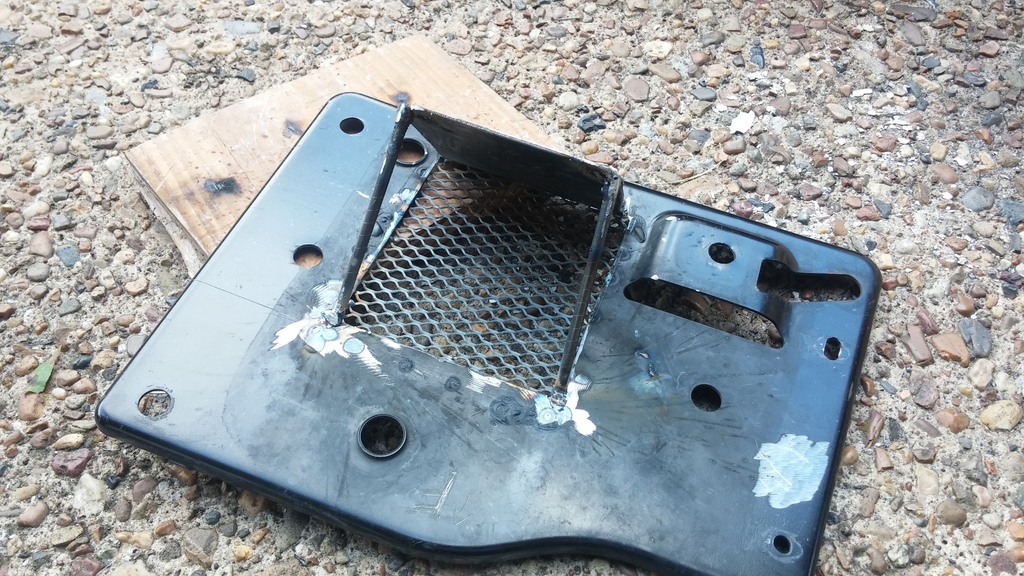

I see that people have been doing this mod for a while, so I don't want to bore you with tedious detail. I tried a variation on the idea earlier today and wanted to share my results.
I cut a large rectangular hole in the bottom of the air box. However, I only cut three sides in the steel plate and just scored the side closest to the fender so I could hinge it there and make a flap. I'm really not sure if the flap will do anything whatsoever, but I wanted to try it and I have access to a welder and power tools.
Like I said, I'm not trying to bore you with minutia, so here are some "finished" pictures to illustrate.
If I were to do this again, or redo it, I would try to weld some sort of pipe to the bottom of the plate to make a snorkel for cool outside air. I might also try adding a scrap piece of steel to the side of the flap closest to the engine to try and block some ambient heat. As it is, I think it will get cooler air than the traditional swiss cheese "holes everywhere" method.
BTW, first post. Thanks.
