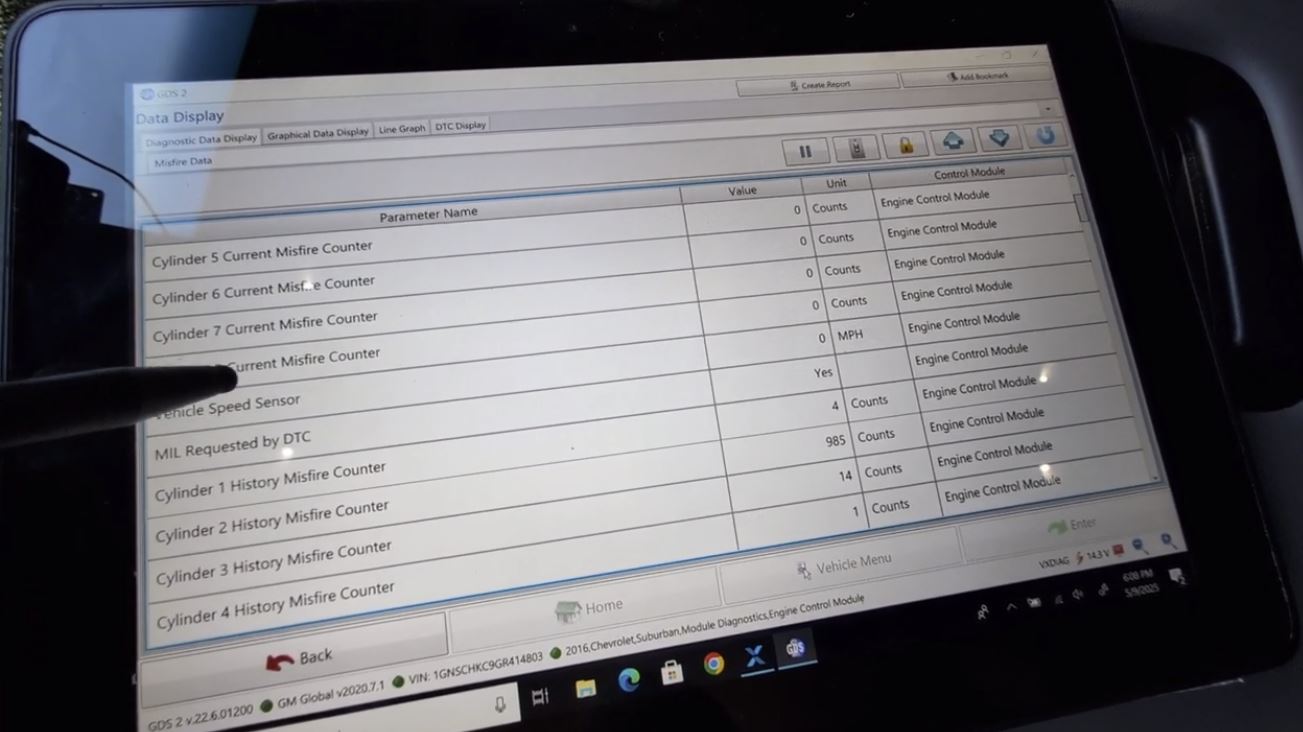

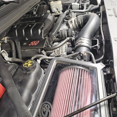

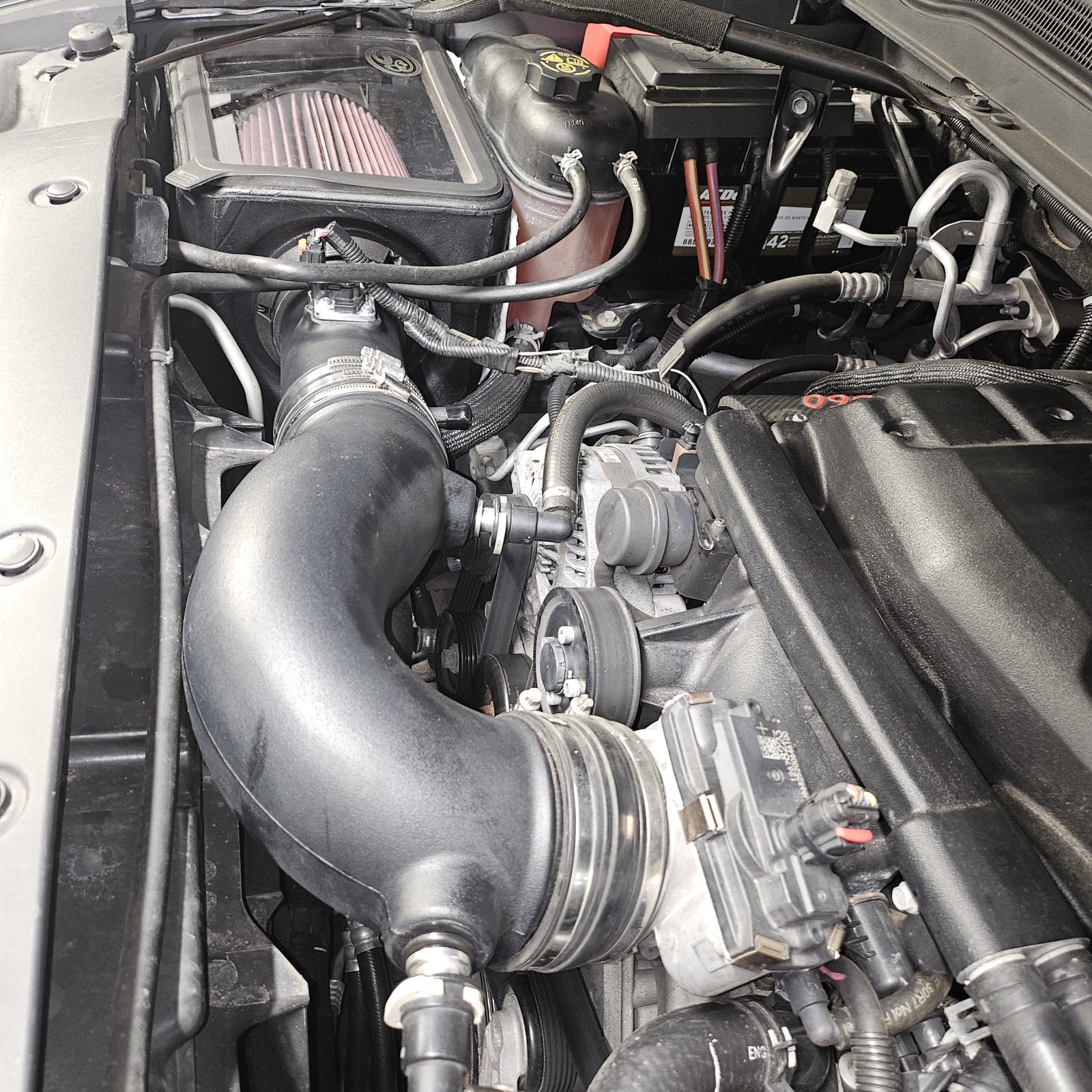

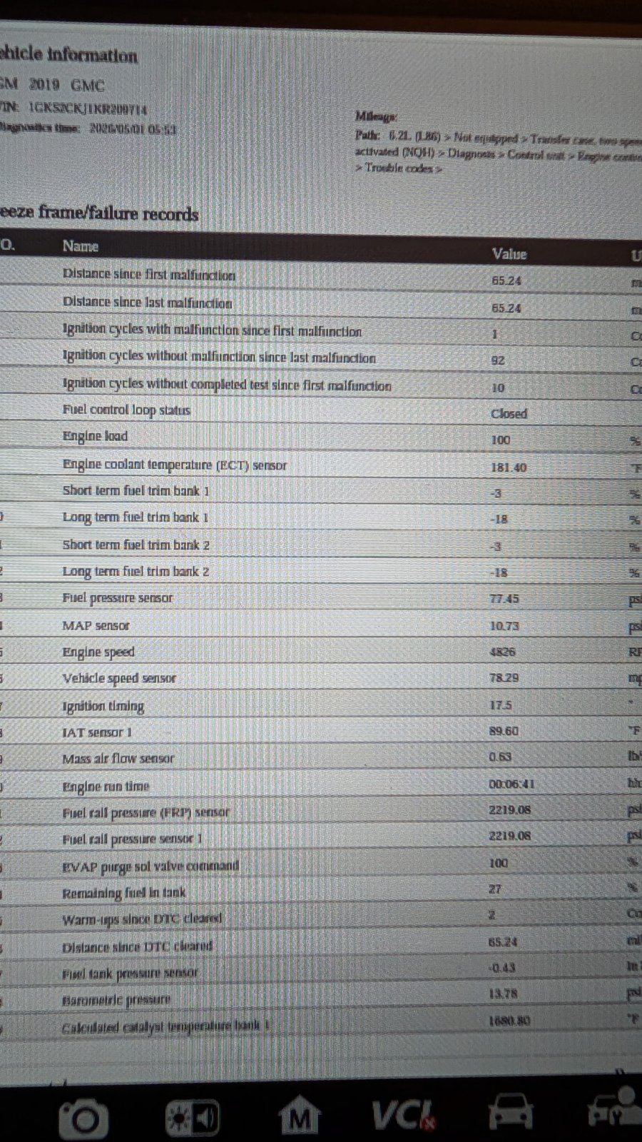

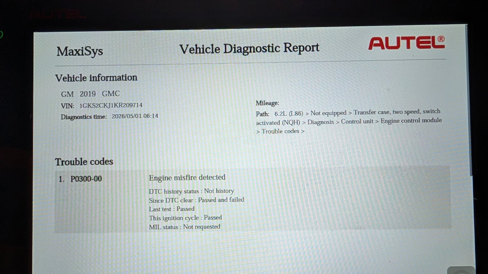

Here's a partial report from a scan and a pic of my intake mod. The funny thing is that the code it popped shows it was 64 miles back. But I had just run it at WOT and experienced the missing above 4,500 RPM steadily. For some reason it does not always pop a code.

Please review the scans below. The original Callaway "Honker" CAI intake box was changed out because it sucked for filter changes and the mounting lugs had broken so I figured a change from a flat K&B CAI filter to a cone would be good (what could go wrong)? I really was not looking for more "umph", just convenience. The plugs were replaced last year and no issues until recently. Callaway has their own tune that is proprietary, so a full on custom may be all I could do if I don't want to go backwards.

mass air flow showing .63 lb/hr should be more than that at 4800rpm
make sure its plugged in fully and in the intake tube the correct way - should be an arrow pointing at the engine
In addition, what's with the rich LT fuel trims? Short term looks okay, but you might reconsider resetting the long term trims to see if they continue to go rich.
that data is not what you want to look at it, I mean it is just for basics but what you need to see is knock retard, and individual misfire counts and maybe 02 sensor data. This needs to be looked at while in high rpm/under a load with the problem occurring in real time. (also during cold start as you noted that issue, I would guess that is injectors since these are a known issue on the k2's) The injectors on these could be misfiring hundreds of times and you would not feel it or get a code until it reaches a certain threshold

If i go out and even adjust my CAI (it has a insert) it will throw a code, I do not get a driveability issue but these engines are pretty sensitive I also do not have forced induction. but I would imagine anything that is changed is amplified by a supercharger.
in this instance shown below, the DTC was already previously set, the misfire counts shown were not noticeable (sound wise), no rotational noise and would not have caused a code to set if I had cleared it previous to this instance, yet they show up with a scan. The outcome was bad injectors and it was a ongoing issue, in other scans the counts varied from a few to over a 1000 on either bank. It drove "ok" but was sort of a dog lacking power.
I noticed that also, but my hunch is without the maf working, running 100% on speed density those tables werent dialed in real close in the tune.
