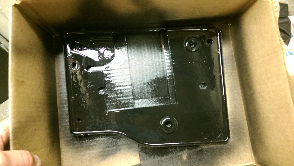

Here's some pics of mine.
Cut out most of the bottom of the filter box, added a screen and bent it to fit in place, threw on some black silicone and a bit of black spray paint.

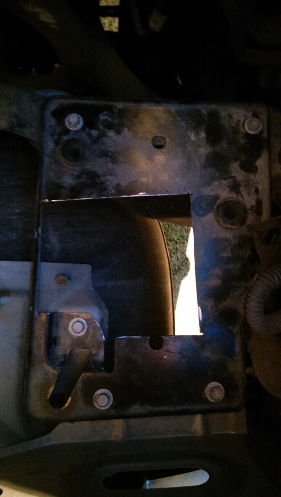

Took a look @ the bracket in place. The cuts in the bracket line up with the opening in the airbox, looks kind of haphazard here... I didn't want to cut out more than necessary.
Hit it with paint
Did it make any difference? Who knows. Maybe someday I'll hit WOT on the freeway and find out.
It cost nothing but a few minutes of my time and materials that I had laying around in the garage. Had fun with my grinder and dremel too.
Looks like the inner fender well liner might scoop air up into this area.

Way better than before. I would still cut alot more of that plate if not just toss it over the shoulder.
Does removing this much material drastically increase the risk of getting lots of water in there?
TheAutumnWind
Jan 8, 2015
3,254
1,993
You think so? The hole in the plate is nearly the same as the opening in the filter box. I really can't see any air flow improvements by removing it at this point, and I don't like the idea of the filter box bouncing around up there.
---------- Post added at 02:00 PM ---------- Previous post was at 01:58 PM ----------
There really isn't any reason to think that lots of water could get pushed up there. There is the plastic inner fender liner blocking any water that would get thrown off the tire. I can't think of anything short of fording a river that would cause an issue, which I certainly don't plan to do, and I'm not sure that I could even find a river that was deep enough in CA to do that in right now anyways. (ugh drought)
