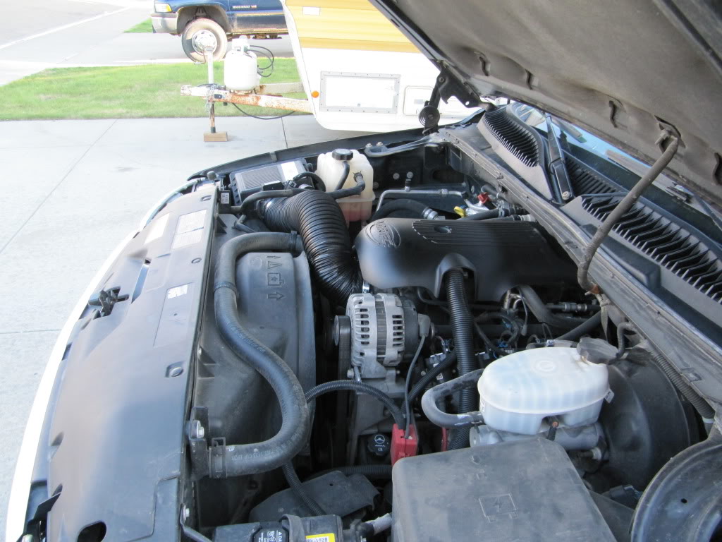

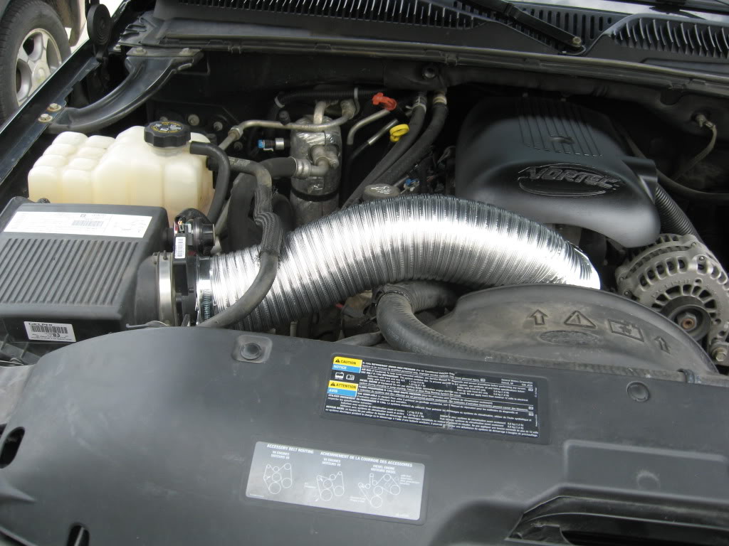

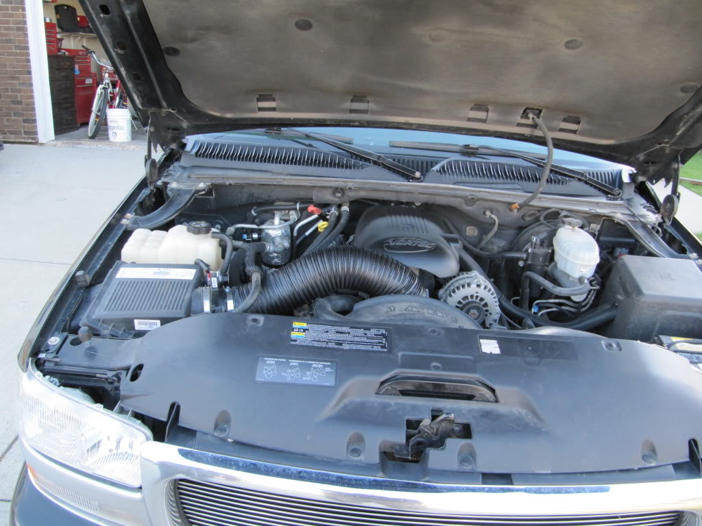

added a air tube
so i have added to mine by removing the baffled plastic from the maf to the tb and replaced it with flex tin hose for furnace vents it came in like a 3ft chunk 4" in diameter i then used hose clamps to hold it on, works well and i think it looks not to shabby

how thick is that stuff highrollin?
looks pretty good I'd shoot it with some rubberized undercoating or something to make it a little more rigid and make it black :)

hey ya its super rigid, you have to bend it and it holds its form and i have been checking it all day today to make sure still good and its perfect not to mention it feels cooler to the touch to me thn the plastic seemed to get, i like the coating it idea i think i might do that for the colour change plus couldnt hurt to safety seal it
oh and it sounds better and has a little more get up and go, a lot deeper it was the perfect accent to the swiss cheese and magnaflow

i just used the tube i curved it, it is flexible, and at the tb side it fit perfect but at the maf side it is a little bigger so i duct taped it where i put the hose clamp incase it tore the vent, i had to get two 5" hose clamps aswell, i plan on coating it with a rhino liner next days off

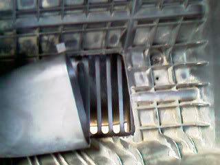

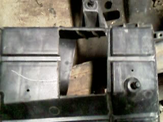

This is a great thread. I did something similar to my 2001 Camaro a couple years ago. So this thread convinced me to go for the 02 Tahoe. I have to say thanks to the guy who figured out that the plate under the filter housing had open space under it. I took some photos of what I did and figured I would share them with ya'll. Let me know what you think.
Since you all know the basics I will spare the play by play of taking the housing and the plate off.

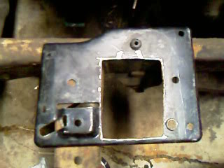

After I got the lower filter housing and the plate that it sits on off, I got a piece of card board and measured the size of hole I wanted to cut by sitting the housing on the plate for a reference. I scratched the outline of the cardboard onto the plate, then used a grinder and cut it out.:893Chainsaw-Smilie- It was really pretty easy to do. Only took about 15 min to cut the hole out.
I then placed the plate onto the lower filter housing and scratched the bottom of the housing as a guide for that cut. Just made it easier to ensure that the hole would be lined up.Then I used the grinder to cut the housing. The housing was cut in a couple min.

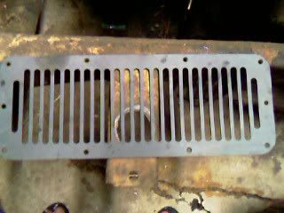

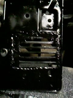

I am in the middle of a frame off restoration of a 1979 CJ7 so I had the old hood vent. I figured it would be good to weld into the hole in the plate to reduce any leaves or other debris that might try and get in there. You could use anything. I used the cardboard template as a guide to cut the hood vent. took about 5 min.
Well it's been round 15 years since I have welded and I have been needing to practice but never got around to it. So I didn't take any pics of my shotty weld job. Really though it only took about 15 min to weld up and I could have cleaned it up better but I was getting impatient.:secret: I grabbed a can of flat black paint and put a couple coats on to keep the rust out.
After the paint dried it was time to reinstall. A little more time cleaning the shotty weld job would have made it look better. I can always go back and fix it later after I practice a bit more. Here are the rest of the pics. I think it looks really good with the housing on.
It only took about 1hr and 20min to do, not too bad! Probably going to add some holes on the back side of the lower housing for a bit more air. I can tell difference in response and it should get much better when I get the K&N drop in in there. :driver:

Just finished the "highrollin" swiss cheese flexible dryer vent intake and I have to say so far I'm pretty impressed. Throttle response is better. Don't have a very noticeable growl. Doesn't seem to heat soak any worse than the stock one did. I'll see how it goes for a couple days.
