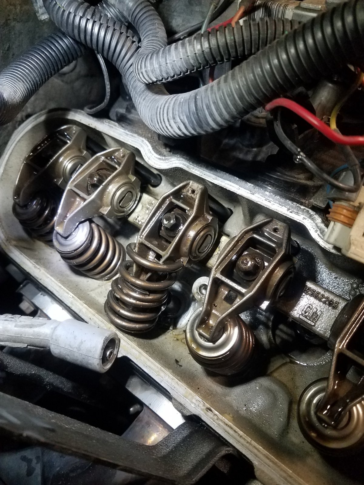

Did a 6.0 swap in your 1/2T....what cam did you use in the 6.0?

This is why I suggested either a low lift cam or dual springs. I should have taken my own advice :banghead:

Ouch! Looks like that head is done for? Do you know what caused this or what happened right before it went bang? What springs were you running with the cam? I have been considering the TSP stg 2 high lift cam kit which came with springs included and the other necessary parts. Good luck with getting that back in shape and together again. Did you ever run your 6.0 with the factory 1721 cam for comparison sake?

Just get better Quality springs and you won’t have to worry about it. PSI 1511 or if your cam is bigger than those get the BTR duals.
