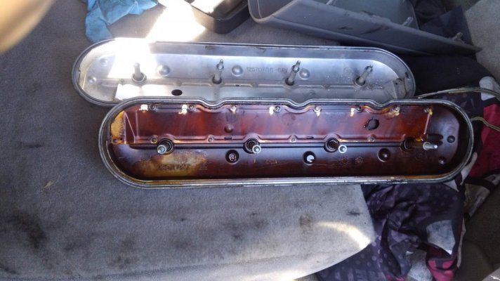

I did a bit more research on the valve cover revisions. There are 4 versions of the driver's side valve cover. 1) removable PCV valve, 2) fixed PCV orifice with 3 round breather holes, 3) fixed PCV orifice with 1 round breather hole, 4) fixed PCV orifice with square breather hole with wings. The 3 breather hole valve cover can be seen in this thread, and I think it was what GM used before the single round hole.
I recently saw a valve cover with the updated part # 12570427 but it was not the most updated valve cover. So be careful buying just off the part # alone. 12570427 should be the square hole breather with wings but there apparently were using that # at some point on the single round hole breather.
This was spotted at a local Pick A Part on an 05 Suburban. The clean valve cover, part # 12570696 was sitting in the back of the Sub, so I assumed it had been replaced with the revised valve cover. I pulled the driver's side valve cover off the engine and what I found was functionally the same exact valve cover, single hole & fixed orifice. But the two covers have two different part #'s on them. See pic.
