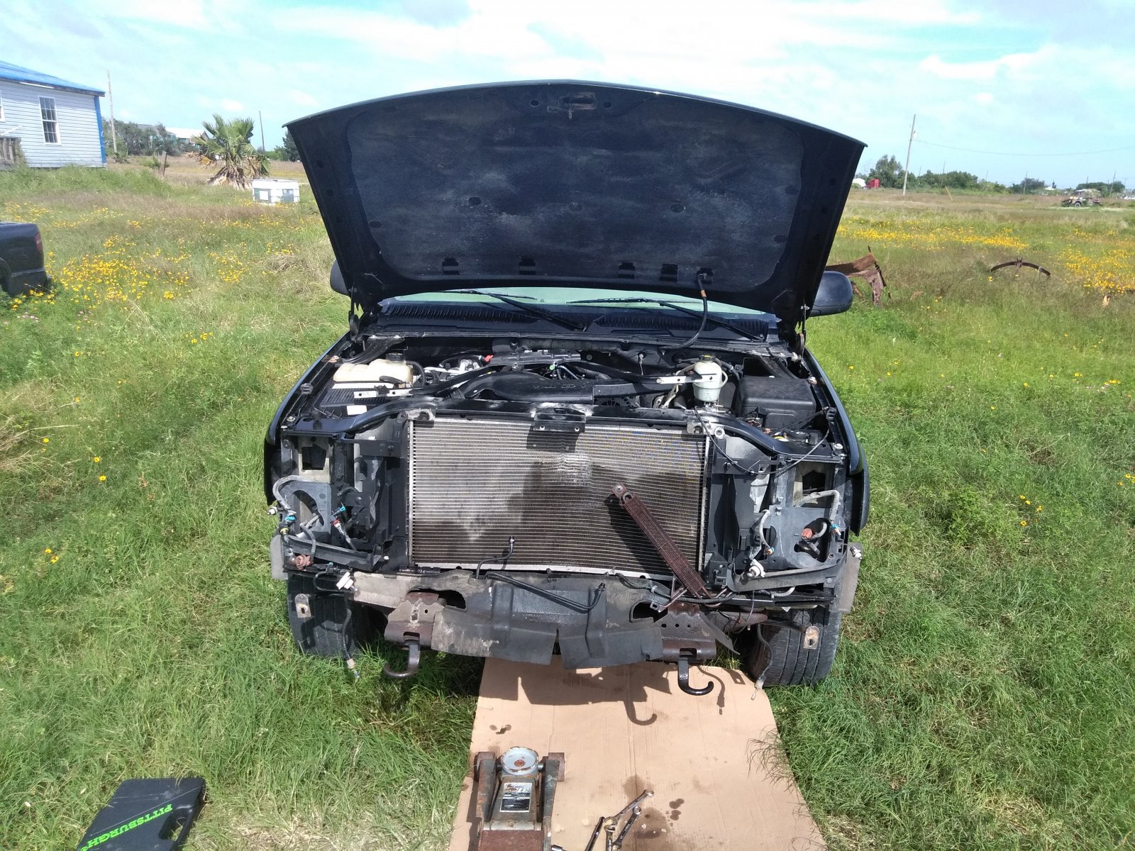

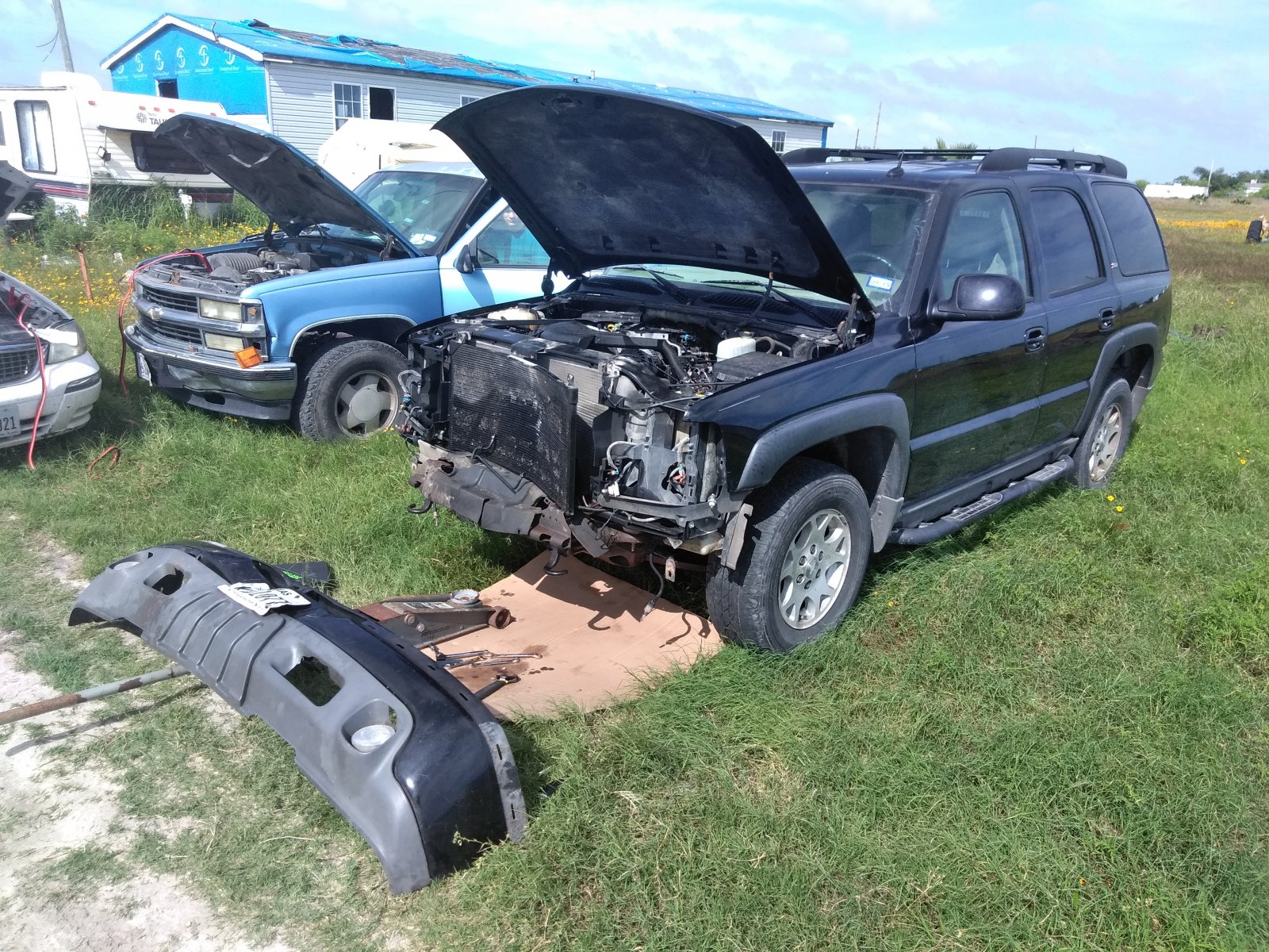

So, let's just say I got into an accident with my crowning pride and joy, my black 2005 4x4 Z71 Tahoe. The front end is smashed up and the bumper, grille, headlight assembly, transmission oil cooler, AC condenser, and my radiator all need to be replaced.
Any thoughts or ideas anyone?
I was also thinking of replacing the front with a custom grille and headlights. Opinions?

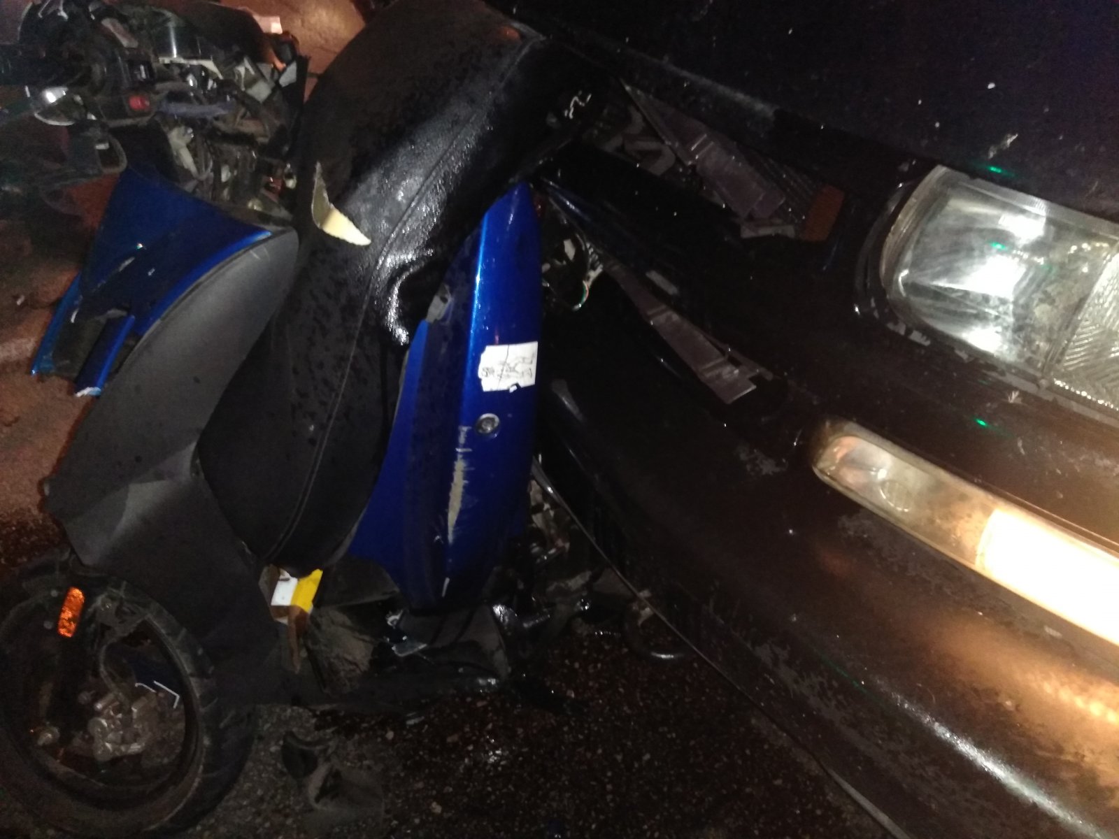

I sandwiched a moped between my car and one in front of me. My brakes failed going 65mph at a red light on the highway, managed to slow to about 35mph before collision.

SnowDrifter
Sep 5, 2016
2,490
2,930
Sasquatch Country
^^Hard lesson there. Ouch. I hope everyone involved is OK.
As to the truck: It's too early to tell at this point. Pull soft cover off the front. Any damage to the frame?
I'd have it towed to an alignment shop if it appears relatively OK. They can pull some measurements from the wheels and from that, determine if the frame is tweaked.
In particular, the measurements to look at that would be:
- Thrust angle, which would indicate a tweaked frame or rear control arm / axle damage
- SAI, which would suggest either control arm damage or a shifted frame in the front end
- Turning angle difference. The inner wheel of a turn needs to angle more than the outer wheel. If that's off, it could indicate damage to one of many things: Center link, pitman arm, steering box, associated mounts, idler arm, idler arm bracker, associated mounts, or the steering knuckle.
Other stuff to check:
- Body mounts. Verify they've not shifted. Admittedly there is a fair bit of forgiveness in these, just make sure nothing is excessively tweaked
- Front diff, axle, t-case, transmission mounts and motor mounts. Force may have been sent up through the driveline. Inspect for damage
- T-case operation - due to above. Do you have selectable 4wd, or full time 4wd? If selectable, and the t-case was placed in neutral during the tow - no problem. If the trans was in neutral during the tow and/or you have full time 4wd - problem.
- Front CV axles. Make sure they're not bent.
- 4wd actuator on the front diff
- General front end wiring. Trace all wires in / around the area and make sure nothing was busted
That's all I got for ya besides giving everything in general a once over. Radiator support, headlight brackets, fender liners, etc etc. Check all the stuff out prior to making a decision, as bent/broken items here add up in the repair bill

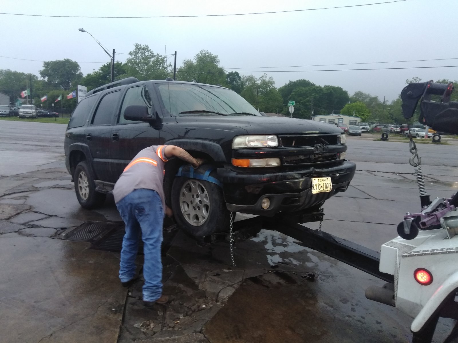

I have selectable 4WD, but it was towed while in park on a trailer.
(Why would towing it in the other manners you described be a bad idea?)
I have had wiring issues from time to time before the accident. One time I had it where for some reason all of the warnings on my dash start going off simultaneously while the head unit (Factory GM 2005 Navigation Stereo) and my all my accessory controls (HVAC and window controls for example) all shut off while I was driving down the highway.
Any help with that?
And the biggest problem I'm worried about. After the accident, with my busted transmission oil cooler I tried getting at least a few miles further down the road to get off the highway and into a parking lot, and in the process I was having to rev my engine up to 4 to 5 thousand RPM's just to go about 20 to 35 mph.
By the time I came to a good place to stop and get towed, a burnt smell emanated from my car. I'm worried I might have burned out my torque converter with the lack of fluid, maybe even possibly damaged my transmission (Its got +210,000 miles on it), but I won't know for sure until I can put a solid line through where the transmission oil cooler was to get fluid back in the system and test it.
What are your guys' thoughts?

Towed in park implies it was towed w/ the transfer case in neutral. All good there. Trying to put the trans in neutral to tow it will shred the internal of the trans. It has no provisions for lubrication with the engine off.
5k at 20mph w/ a burnt smell? Trans is hosed. Burnt the clutches. It didn't have enough hydraulic pressure to maintain application force on the clutches/bands. In addition to the clutches, running sans oil is hell on the gearset, bearings, and oil pump. Factor in full rebuild or replacement into the cost of repair. If it works. And that's IF, it won't last long.
There's a case to be made for the trans is you intend to go through insurance as it was damaged as a result of the collision. Document whatever you need to prove it.
Edit: Looks like it's not common for insurance to cover damages associated with driving a vehicle post collision. BUT like I mentioned, there's a case to be made for safe evacuation from a highway. YMMV?
