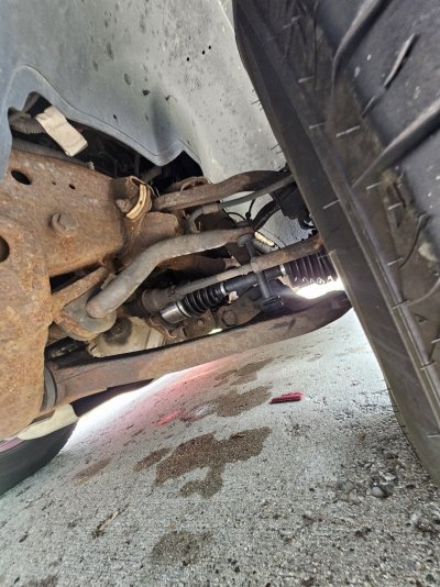

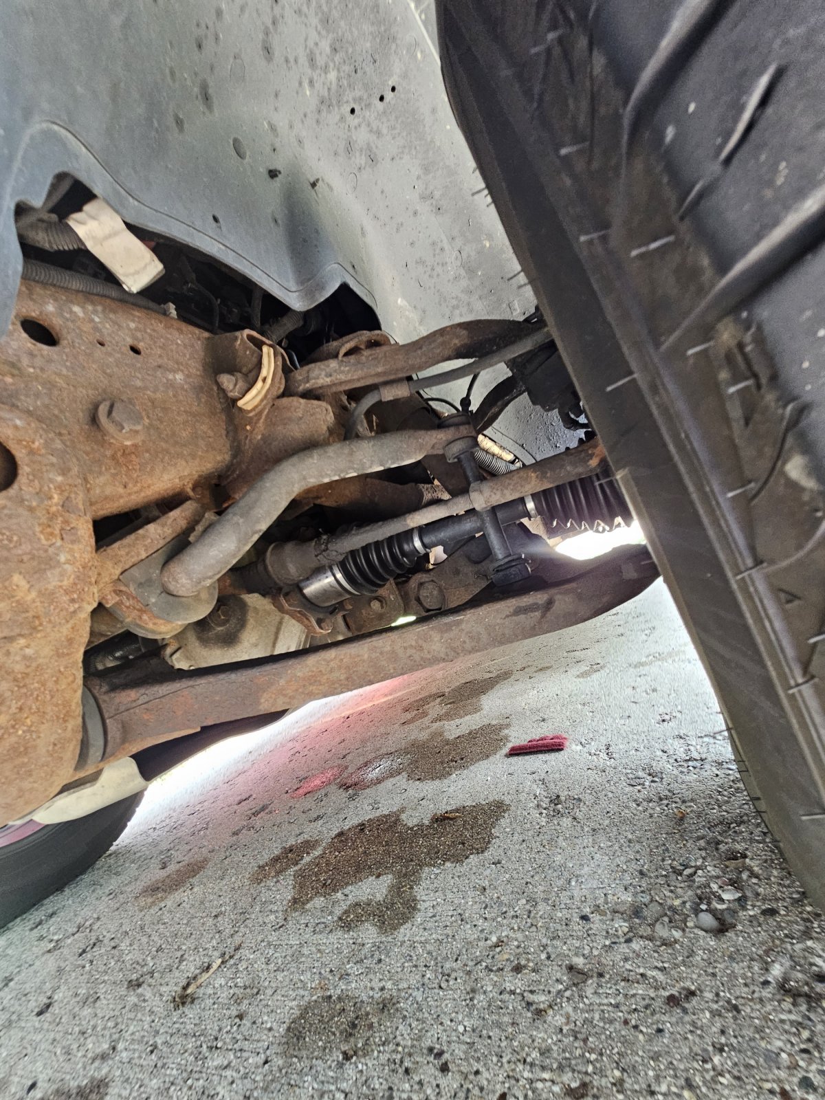

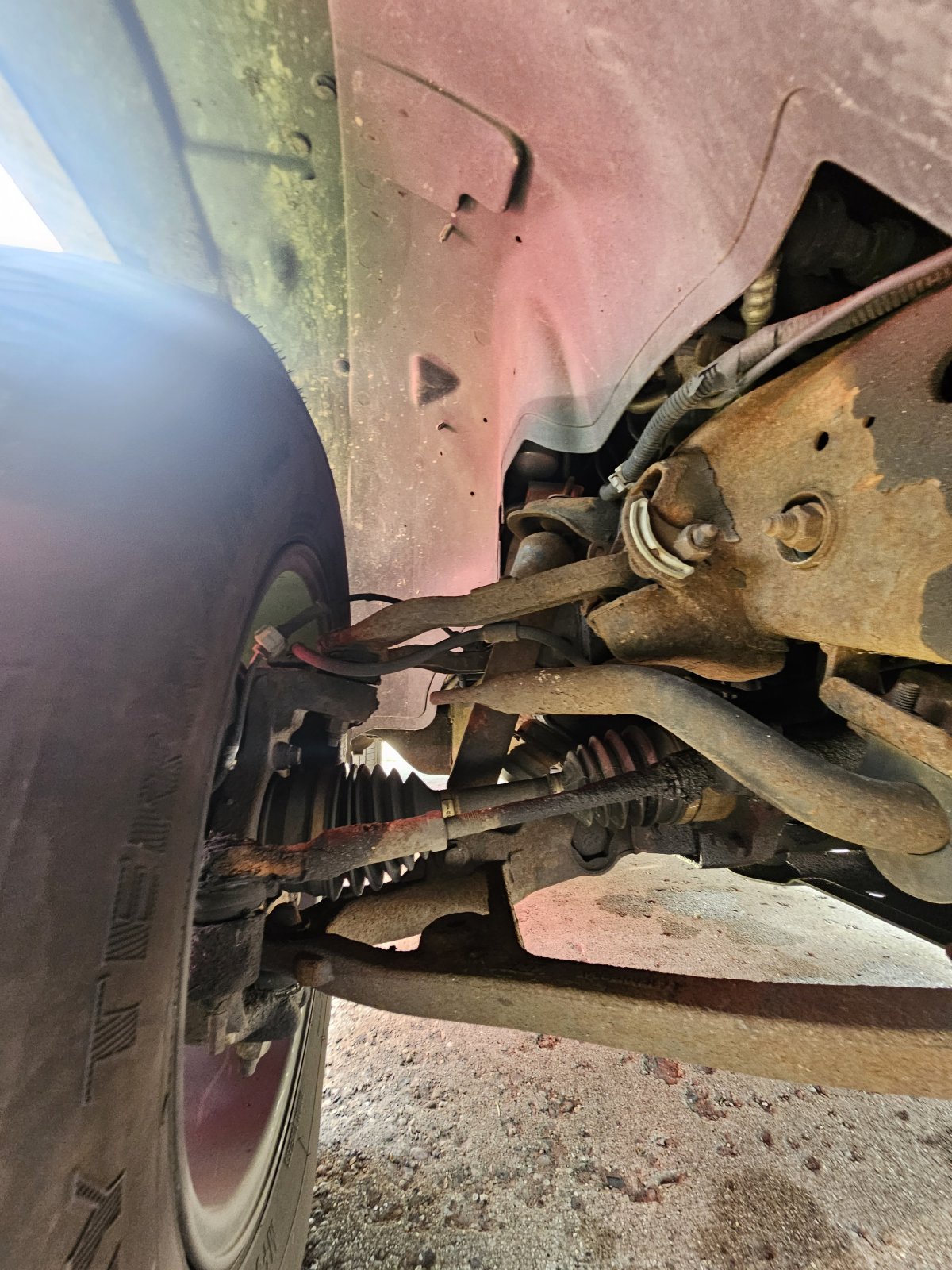

Looking to rebuild the frontnend suspension on my 2005 tahoe 4x4 z71 lt.. is there an assembly kit where I can get everything all at once? And where or what site to use to get my parts from? Also need a new sway bar bolt or whole new sway bar? Help? Also I know it's bad. But this my new project vechile and I'm trying to get to all put together before the husband comes home from his contact over sea? Any ideas? Or pointers would be great.

I just did it. I demoed everything and replaced all worn parts. Its quite a bit of work. My axles weren't worn but i replaced them because I lifted the truck 6.5"
2000YukonXLPro
Feb 9, 2023
12
I kept the lower control arms but did new ball joints. Truck rides great now. Your pictures dont look bad but miles and maintenance play a big part. Do you have a shit ride on highway? Wheel vibration?
Heres my parts list:
Wheel bearings
CV axel assemblys
Pads & rotors
Brake lines
Tie rods
Ball joints
Upper control arm
Sway brackets and bushings
Antiseize, brake fluid, PB blaster, saw and grinder blades
Assortment of brackets & hardware
Buckets of patience
