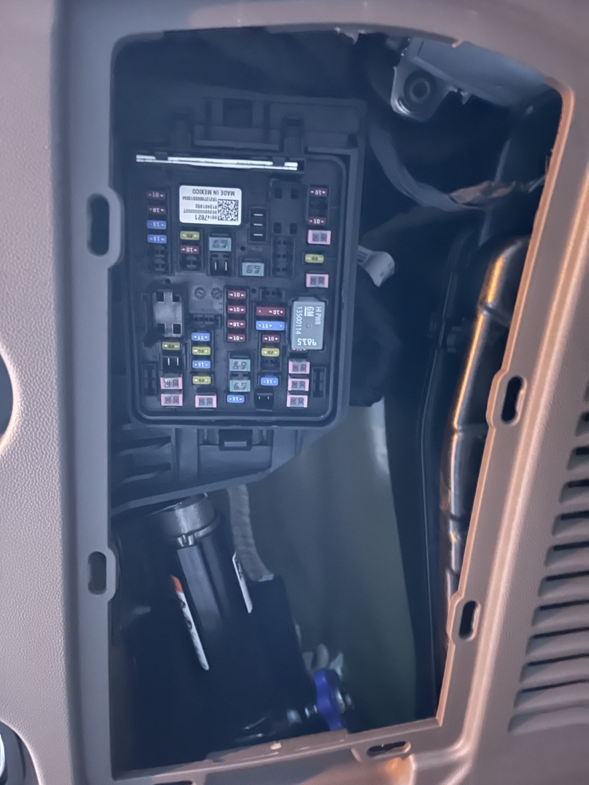

Originally I was thinking I would find a place to do a simple sub install, but the more I ask around, the less I trust anyone to work on this thing, they just don't know what they are talking about. I found the Bose sub in the back left quarter panel, and I was surprised to see the fuse box right next to it, got me excited thinking that I could mount AND wire the amp right there off of the fuse box, or close by anyway. Thoughts? I had visions of having to run a power supply all the way to the battery. I suppose that is still probably ideal but I would prefer not to if I can help it, it sure is a far distance. Also, it appears I can just get an amp with high-level inputs and unplug the bose right there?
I plan to run a small 200-400 watt RMS amp and then build a small ported enclosure for a JL 12TW3-D4 2 inch subwoofer. There really is not much room what the 3rd row up.
Any thoughts or experience with the wiring back there on a 21 or 22??

2 points:
For the JL W3 speaker, I would recommend an amp with a minimum 500 watts RMS, as that speaker needs some real power to make it sound full.
Check the size of the wire going into that fuse box. Unless it is a heavy gauge wire, #6 or lower, you are still going to have to run a power wire out to that battery to power the amp.

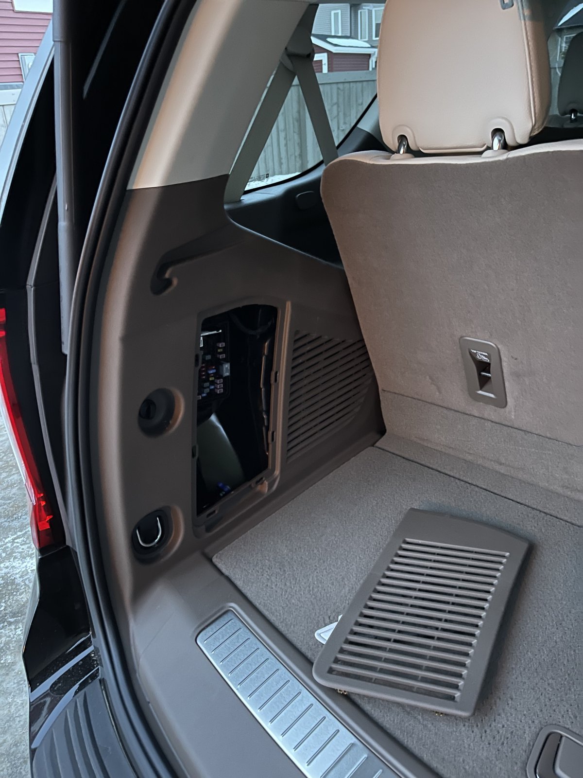

Where is the stock sub? Is it behind the plastic grate to the right of the open panel in your picture? I think I'll just want a slight upgrade from stock so might just look at replacing the stock sub and keep it in the same location so I don't lose space.

It is, yes. just to the right of the fuse box. I have been unable to locate any "stealth boxes" yet as they haven't been manufactured yet. I reached out to JL audio, the main builder of quality hidden boxes and they said it was "in the works"... I can't wait. I think a good shop could do up a fibreglass box that would fit in there. I got a great deal on this 10" not installed yet, but It can be removed if extra space is required, and certainly will hold me over until something better is made.

Might be tricky putting a sub under the 2nd row captians since they flip up and slide back and forth, there is a fair amount of mechanical stuff under there.
To the OP, there is definitely room to mount an amp under the floor in the cargo area, and it might allow you to run your power supply wires outside the vehicle, along the frame, to the rear then come in through the floor. But, as for where to put the sub...thats a tougher call.

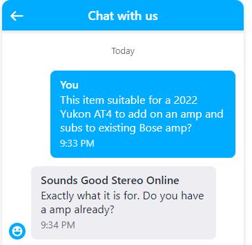

Does the Sierra Denali have the same amp? Wonder if this would work? https://soundsgoodstereo.com/produc..._medium=notification_email&utm_source=spently

Looks like we have a winner here.
Sounds Good Stereo OnlineGot it, so just make sure your amplifier can handle 6v of input on the RCA side
