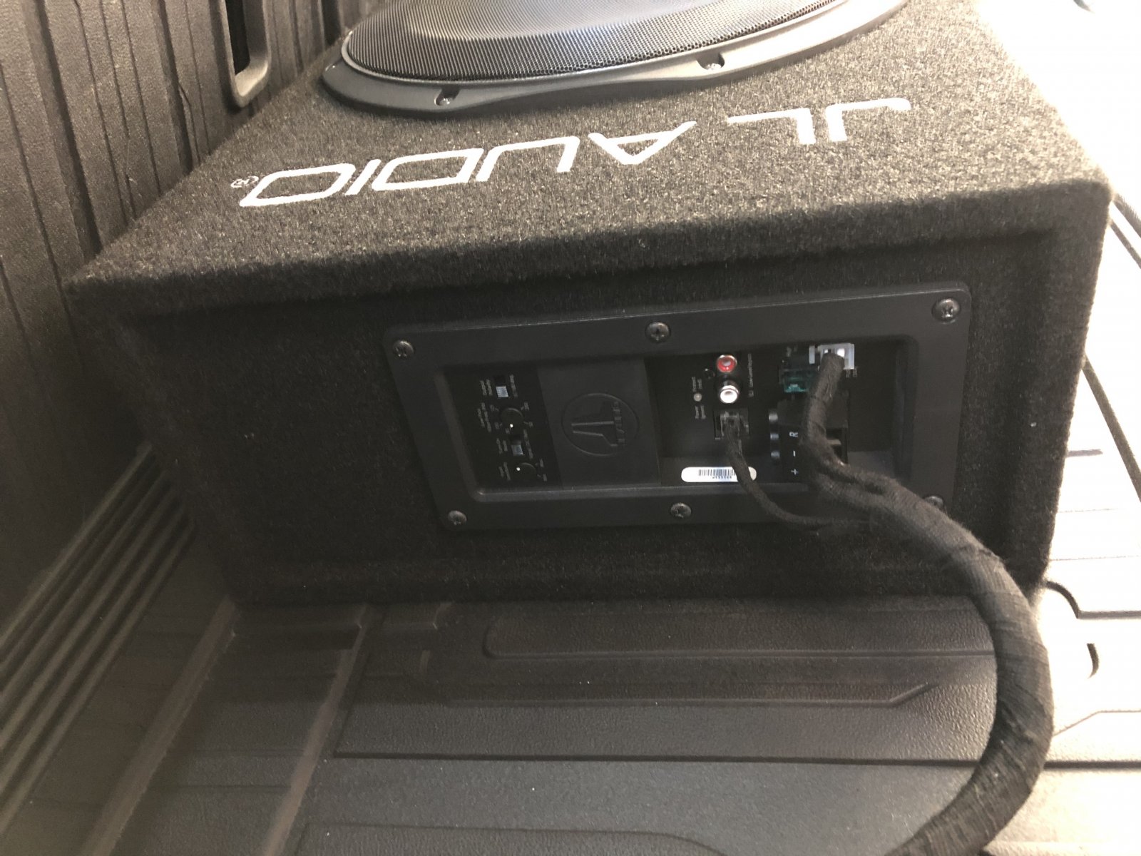

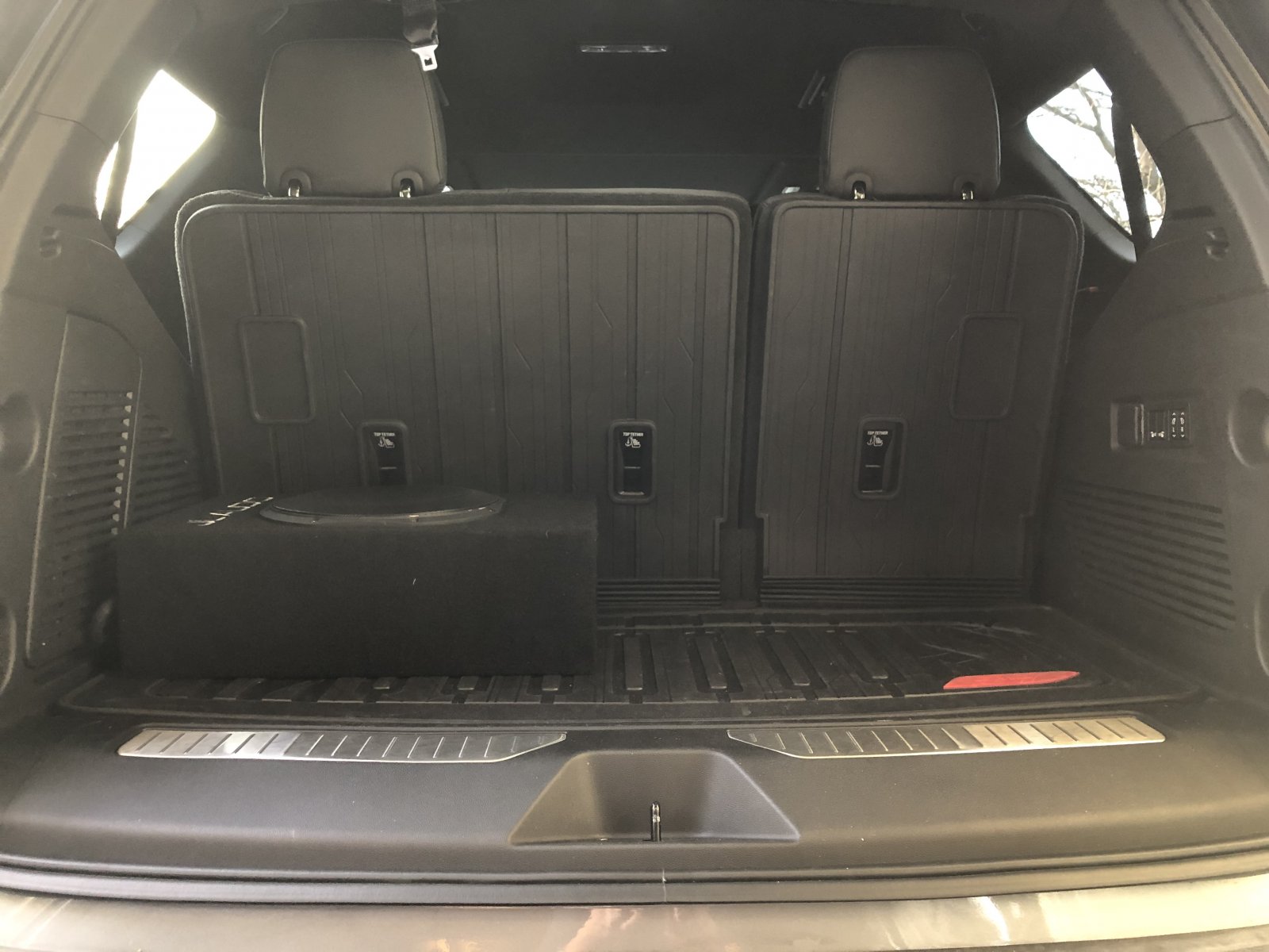

I was in the same boat as you. Didn't want to sacrifice much trunk space but wanted fuller sound. I couldn't find a solution that would work in the lift gate or under the side panels. So I ended up getting one of these, JL Audio 12TW1 PowerWedge+. It has a pretty slim profile, allowing me to place things in front of it or flip it on its back and place things on top of it if needed. I was never a fan of powered subs (but then again, I never gave them a try before this) but I've always trusted the quality of JL Audio, so I gave these ones a bang and I can honestly say it doesn't disappoint. The other nice thing about this is the connections are all quick disconnects, so if you need to remove/reinstall, it's as easy as unplugging/replugging in a matter of seconds.

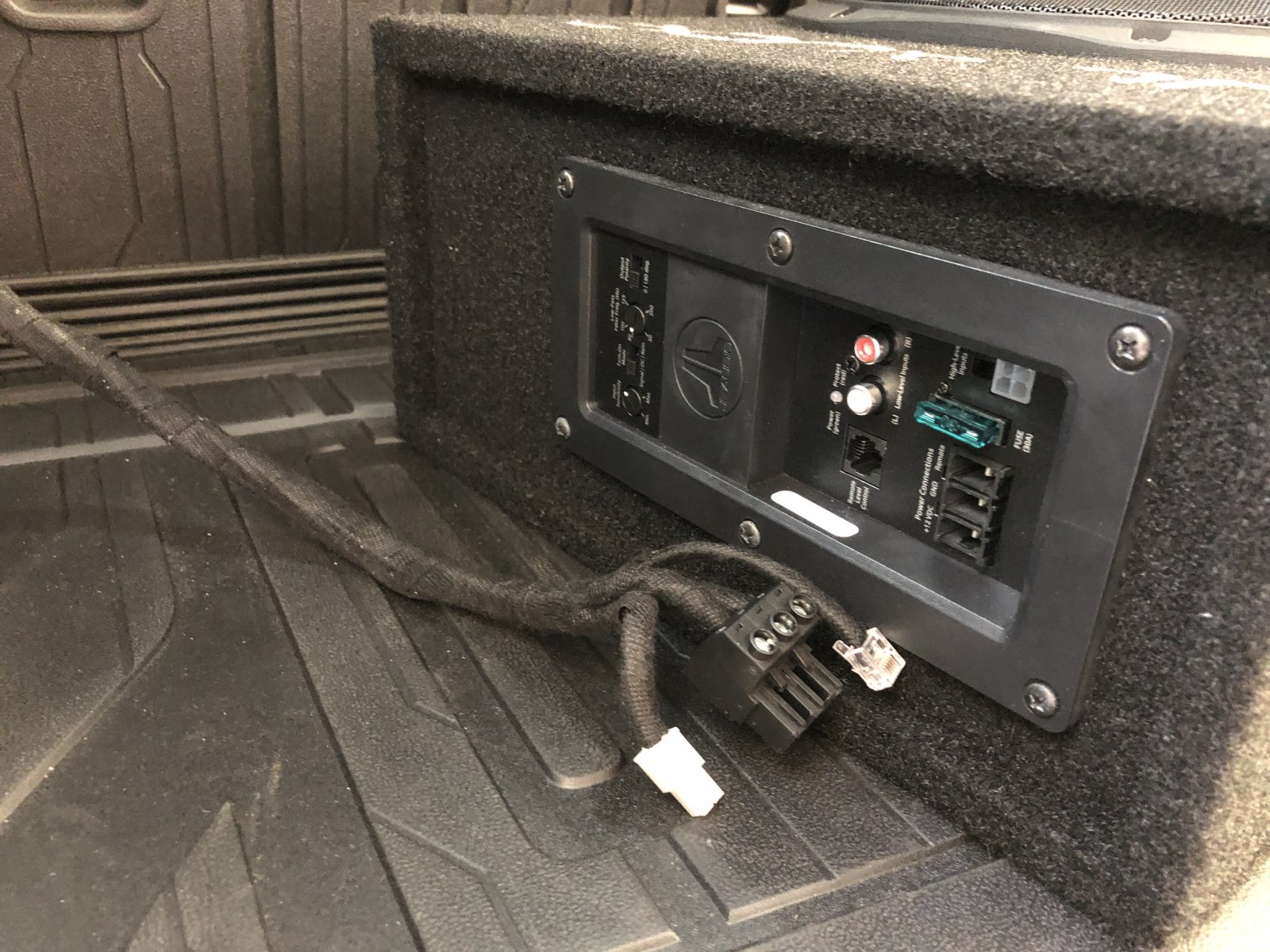

So I didn’t install this myself, I had my local car audio shop do this for me. Originally I was planning on moving my old wedge style sub enclosure to my new Yukon, but ended up seeing this new powered sub in the shop’s showroom and testing it out. It actually sounded better than my old sub setup. It ended up working out better since there was no external amp taking up space under any of the seats or in the trunk. All the wiring (power, audio, and level control) make a home run to the sub enclosure.

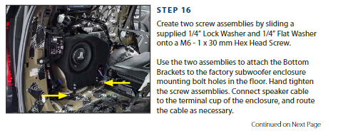

Jl Audio now offers a stealthbox for 2021 and up..
full custom build in the works..
You just made my morning! They sure do -- can't wait till it's available. Going to make for a clean install!
ATrainTX
Oct 14, 2022
14
13
Installation manual is up for the JL stealthbox for 21+ doesn't look too crazy of an install. I'm trying to figure out where I'd stash a small amp to try and minimize the existing cargo space usage.

"Estimated time: 1 hour" ... with a team of 6 automotive engineers working at the speed of a NASCAR pit crew.
The instructions are nice but sure do leave you hanging with the amp install.
