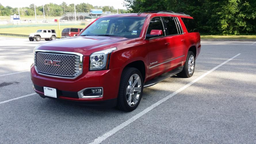

Well I figured it out. Pay the dealer $100 and enjoy your new grill.

I think it looks much better. It actually rides better and has more power since it thinks its a Denali. :waytogo:

The chrome looks great with the red!
