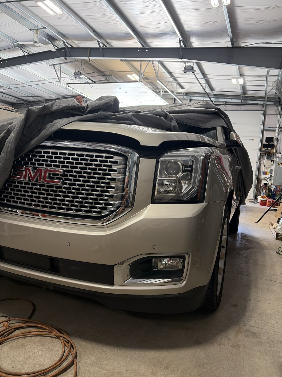

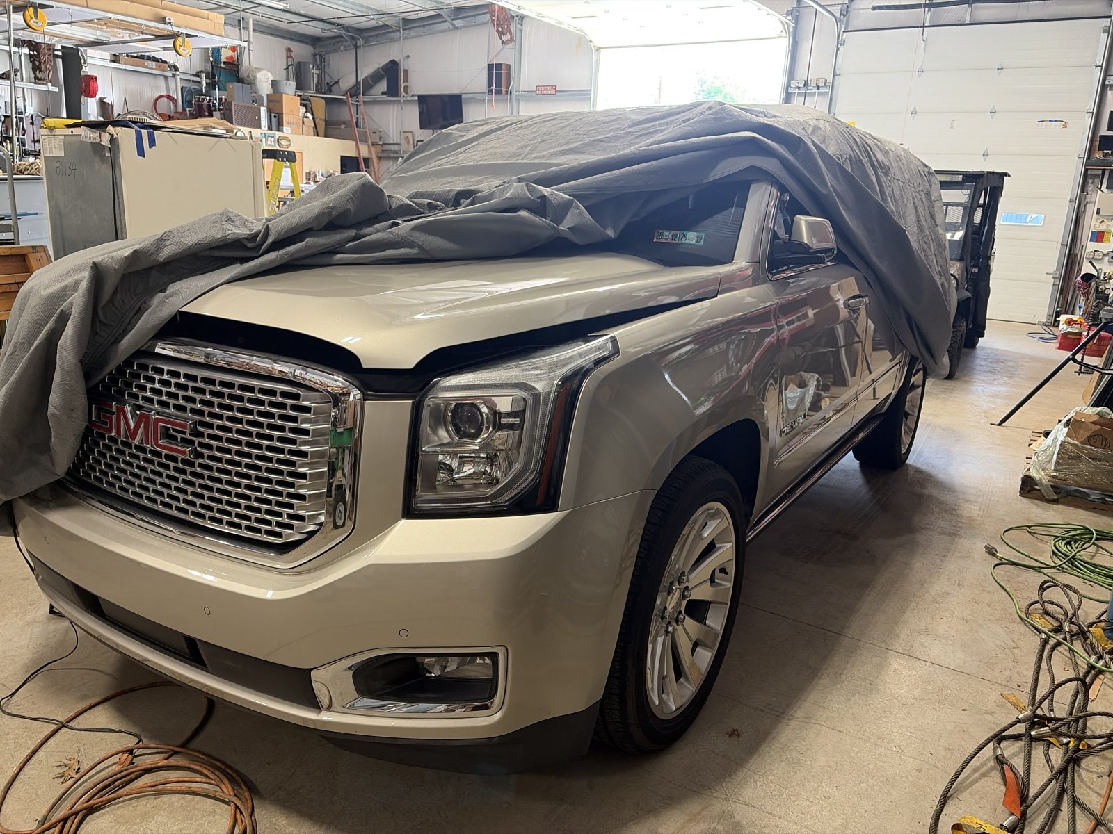

Pics of the truck, please. If we can't see it, it does not exist.

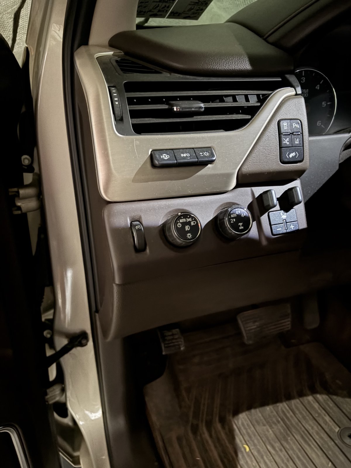

Thanks for the feedback. The Yukon has spent the majority of its life in the shop undercover. Has only pulled a trailer once without trailer brakes. The battery is newer and is typically on a trickle charger. I’ll dig into the ground connections again and will probably replace the dash board controller.
