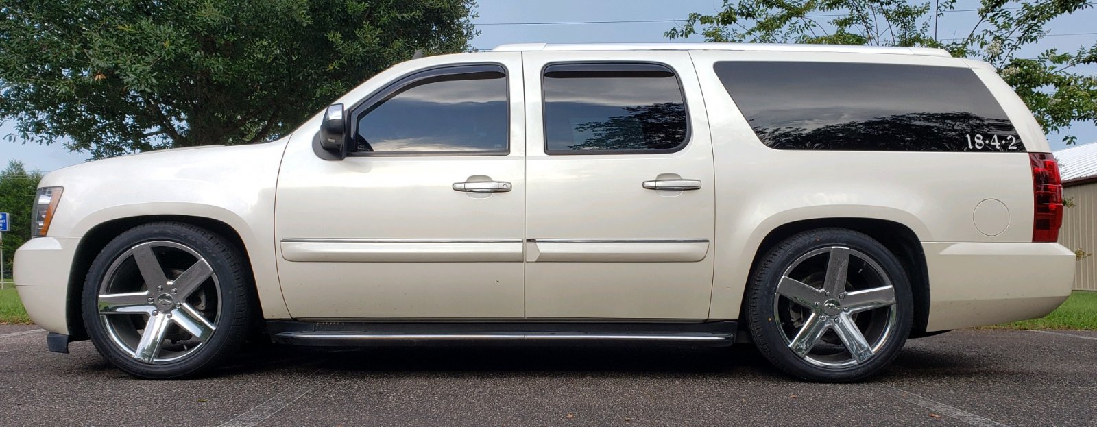

Just to add to the conversation... my 4/6 dropped Burb rides as good or better, depending on your preference, than stock and I also kept the auto leveling for the rearend.
Like Chris said, a 2/4 drop wouldn't be an issue if done properly.
But to each their own.
