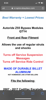

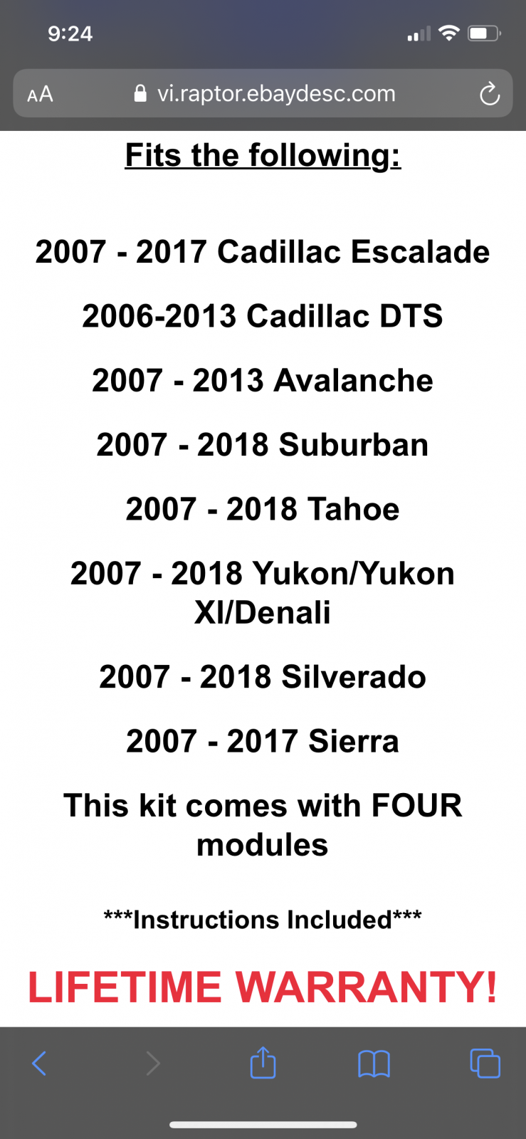

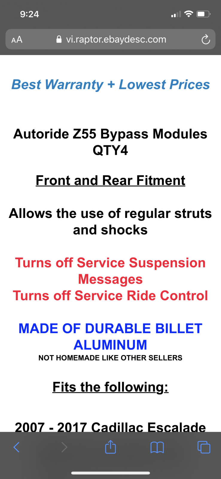

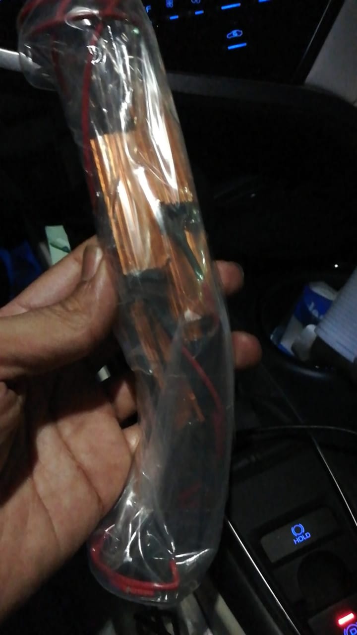

Sorry to not mention that earlier.
I drive a 2016 Yukon XL Denali With Z95 suspension type.
As they got very rigid, I’ve installed Profender Off-road reservoir type shocks with 8 levels of adjustment soft to rigid. The ride is very comfortable at levels 4&5 (not very floaty and rigid) The only thing I don’t like is the speed restriction. So I wanted went through eBay and found the modules for 35$. They aren’t working although the seller mentioned that they are suitable for 2016 Denali.
Now I’m wondering if the code will disappear when I replace the resistors in the current modules with those recommended by you. I’ve added pictures & description of the modules I bought.
Thanks & best wishes,
4F91FF15-E4BF-468D-A38E-4993F2A7E86D.png 9D2FA8C4-7C65-481B-9DE1-03E221DE50F0.png 92764B50-9C8C-4157-9F50-5721D7E4A560.jpeg

@hasan632 -
Xineering's GM Shock Sims product will do what you're wanting.
http://shocksims.com/
Their resistors are about the size of a USB flash memory stick. Very easy to plug into the z95 suspension circuitry. Xineering's product is a Ride Height Sensor and Shock Simulator at each corner. So, if you're eliminating the z95 at all four corners, you will plug in 8 individual resistors around your Yukon, 2 at each wheel.
Did you have air suspension in the rear? You will have to decide if you want the resistors for the front shocks or both front and rear.
